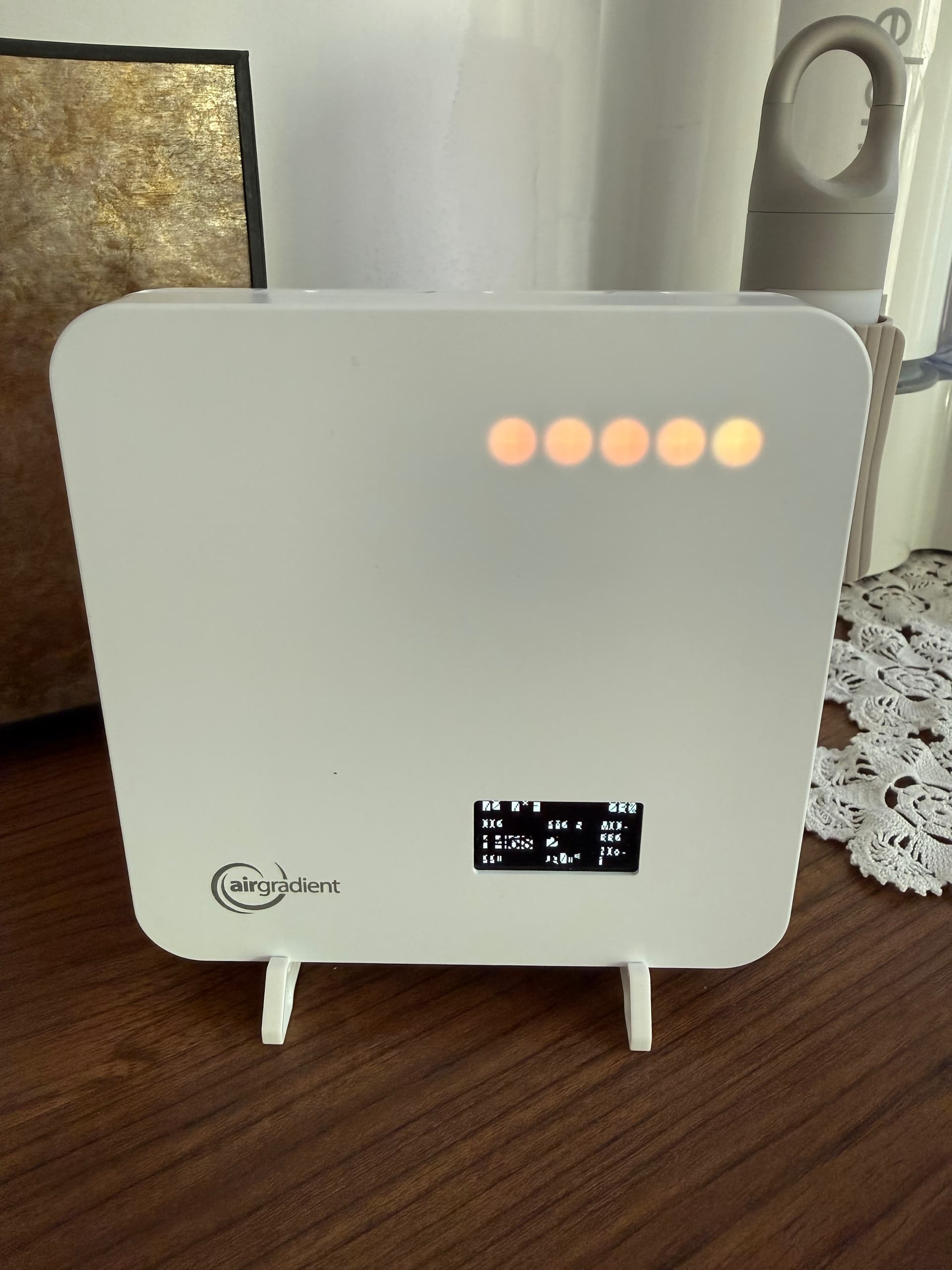

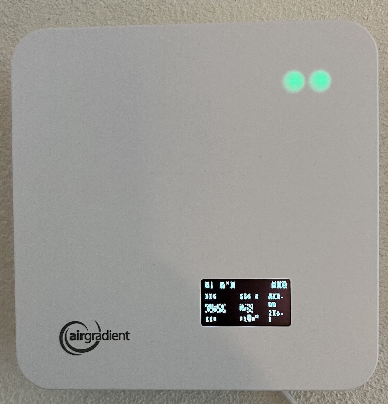

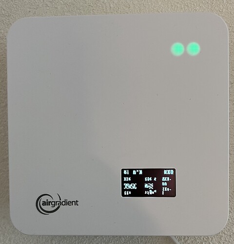

Not sure where to post this, but yesterday I woke up to a very strange display pattern on the small backlit LCD panel of my I-9PSL-DE
Here are some pictures.
I had to power cycle it and it returned to normal after that. My serial # is 34b7dabd4c50 in case that matters.
Any explanation for this?

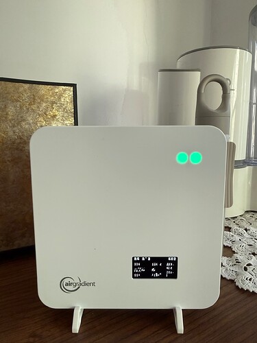

One of my Airgradient One also had this issue.

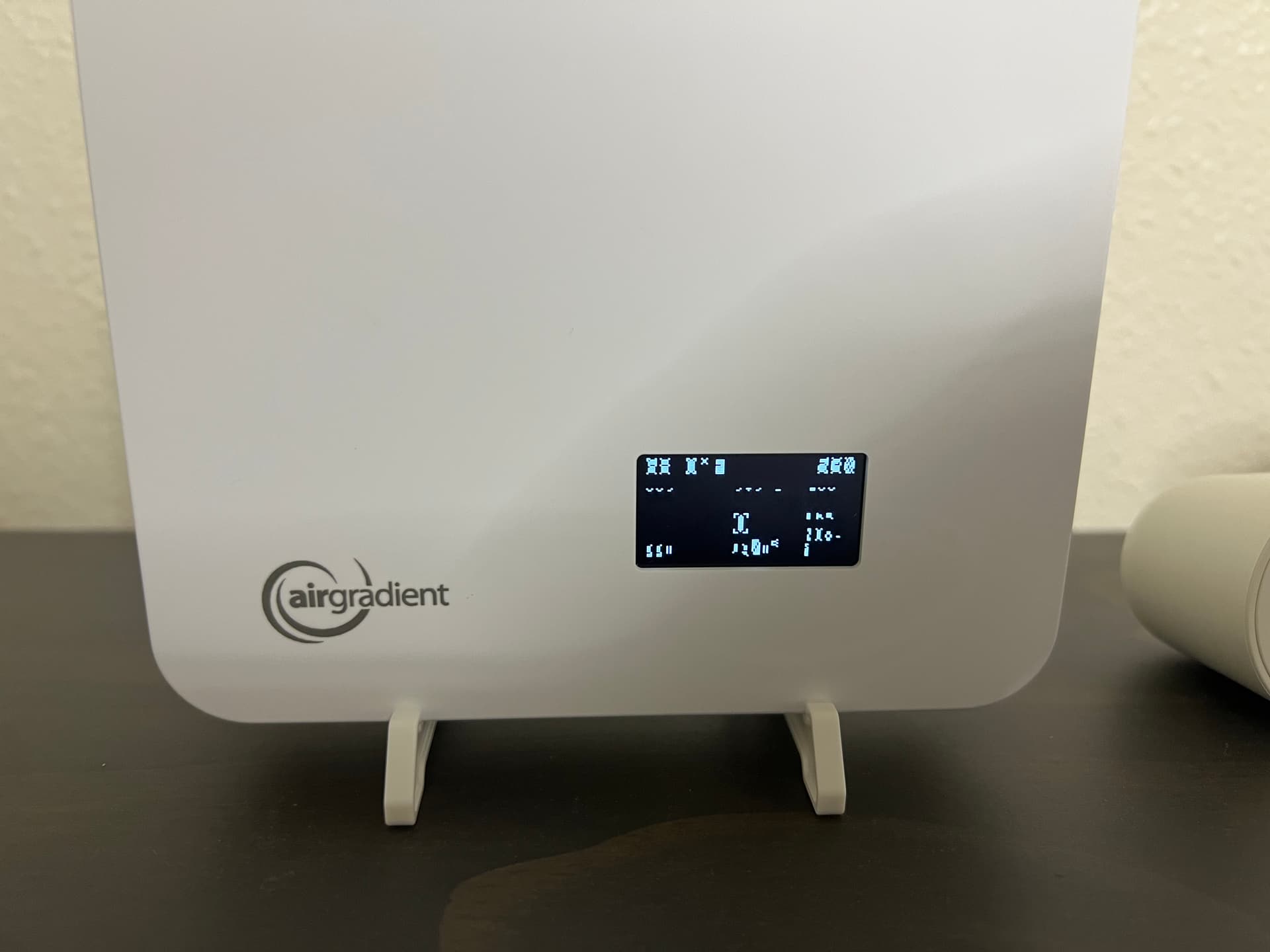

Having the same issue here. My AirGradient One had been been running flawlessly since I got it about 4 months ago, but in the last few weeks it has been scrambling the displayed text despite no changes to hardware/power supply. Rebooting resolves the issue but only for 24 hours or so.
Yes I have the same issue from the start of February. I’m using firmware version 3.6.2.
