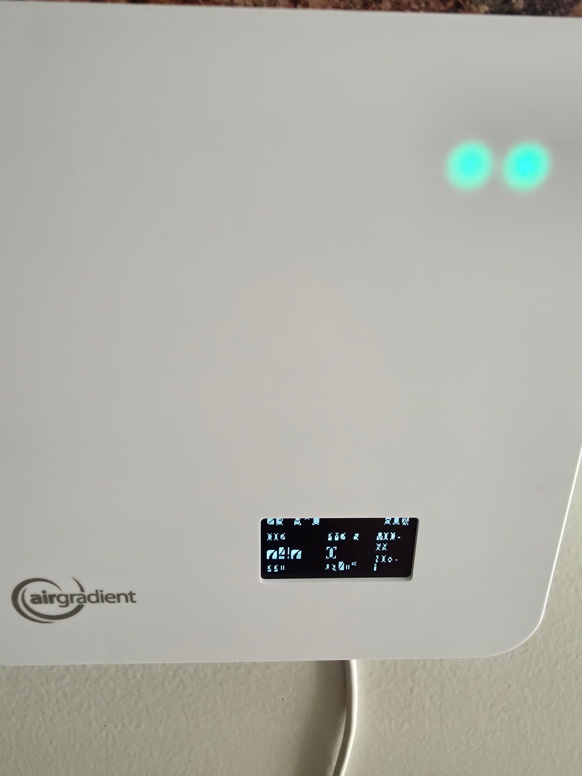

Scrambled alien looking LCD display yesterday? (AirGradient One)
Hey guys, thank you all for providing us with your feedback about the display. We’ve found that it could happen very randomly (some units don’t have the issue, some come back normal after several hours without doing anything, some rarely occur, some are more frequent). We suspect that it might be caused by electromagnetic interference. Our engineer is working to find a reliable way to reproduce this issue.
Every case seems to be resolved by a power cycling (unplugging and plugging in the USB-C (or the wall charger)). In case you can catch this issue red-handed, if possible, please take some photos and observe how it behaves (for example, does it fix itself after 12-24 hours?, is power cycling able to resolve it?).
We are also working on the firmware side to see if we can resolve this on the fly (without a hard power cycling). I will let you know if we come up with more details. Thanks!
I should also add, power supply resolution tried and still issue present. Brand new in use since Feb 2026 and issue started around mid/end of March. No custom firmware, just updates from AirGradient.
Happy to offer up any details that could help resolve.
Thanks
I have been experiencing the scrambled screen for a few months now. Power cycling does fix the issue but within a week I am back to scrambled again.
Don’t have much besides general WiFi iperating in the house. Not like it’s installed next to my microwave either :joy:. I dont have anything power related near the Air Gradient One either. I placed on a wall by itself to capture the main Living Area.
Would be good to understand this problem and fix it. Power cycling isn’t the solution long-term.

I am also having this problem. Same as others: a reboot fixes it, but it returns a while later. Changing the power supply does nothing.
I’ve had my AirGradient set to a lower brightness (via Home Assistant) at certain occasions which I found out was causing the scrambled display. I’m now using the Airgradient always on 80% brightness or 0% when I’m away. Only once or twice since my last post I’ve seen the issue reappear but it’s pretty much gone.
I do see it reboot once a day or once every two days though, not a clue why. It doesn’t both me.

Hi folks,
I’m new to this forum, just registered for reporting similar (same?) issue as the thread starter:
My Airgradient ONE indoor unit is configured to switch off the display at night time to reduce light pollution and display wear. After a couple of days it freezes, showing old measurements and partly broken content. It does not switch off anymore although configured.
I experienced this behavior after starting to use the local api at
<ip>/measures/current and/or
<ip>/metric
Therefore I like to know, if others having this issue too just
after starting to use the local api?
Not sure if it is really related, but if so it might be some timing conflict between processing the api request and the display update cycle.
FTR: I filed an support request on this topic too.
Best regards,
C.

I understood, that the sensors inside share the same i2c bus with the oled display. Since the sensors keep working when the display is not getting updated (or not been shut off), I’d assume that the bus itself and esp32 are still functional, just the display is in a wrong state.
So far, I had this twice.
As I said, I noticed this first when starting to use the local api, therefore my question regarding the timing conflict between display update und http-api-processing and if other users observed the same coincidence when connecting their units to Homeassistant or similar.
If this makes any sense to your developers, maybe they can include some display check in future firmware and introduce additional display initialization in case the display get stuck again?
