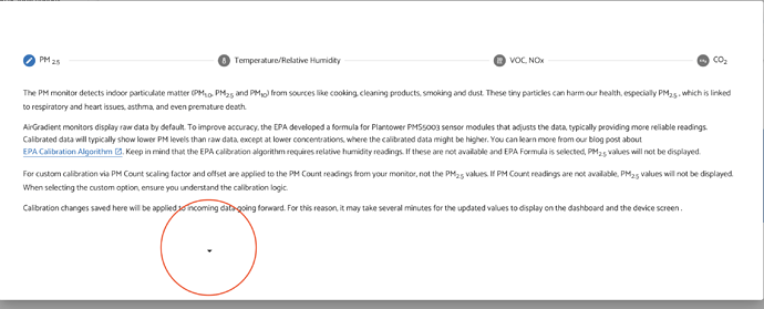

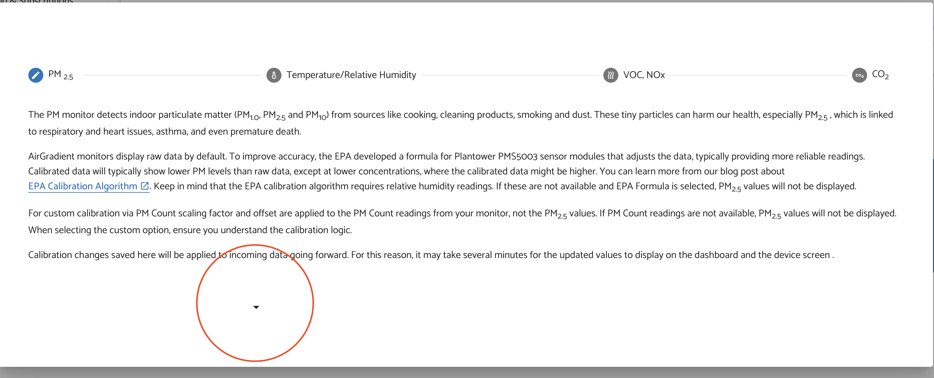

Is anyone else having trouble selecting a calibration from the menu? When I visit the advanced settings I don’t see the drop down menu (see photo below). Additionally I see many of the following stack traces in the browser console when loading that page (again see below). I’ve tried this with Safari, Chrome, and Brave browsers.

main-es2015.4474cd5425babd2bd07a.js:1 ERROR TypeError: Cannot read properties of null (reading 'value')
    at template (default-src_app_core_constants_pagination-page-size-options_constant_ts-src_app_core_pipes_no-995a78-es2015.31f9c2648720cedc714a.js:1:27424)
    at Aa (main-es2015.4474cd5425babd2bd07a.js:1:582526)
    at Ia (main-es2015.4474cd5425babd2bd07a.js:1:581152)
    at to (main-es2015.4474cd5425babd2bd07a.js:1:588433)
Hi @nitsua! Please refer to this thread:
