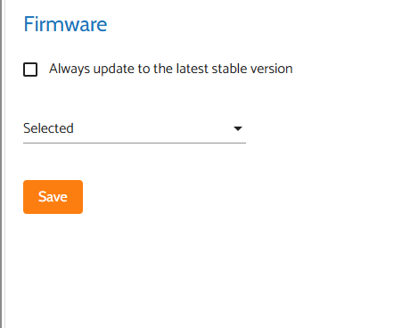

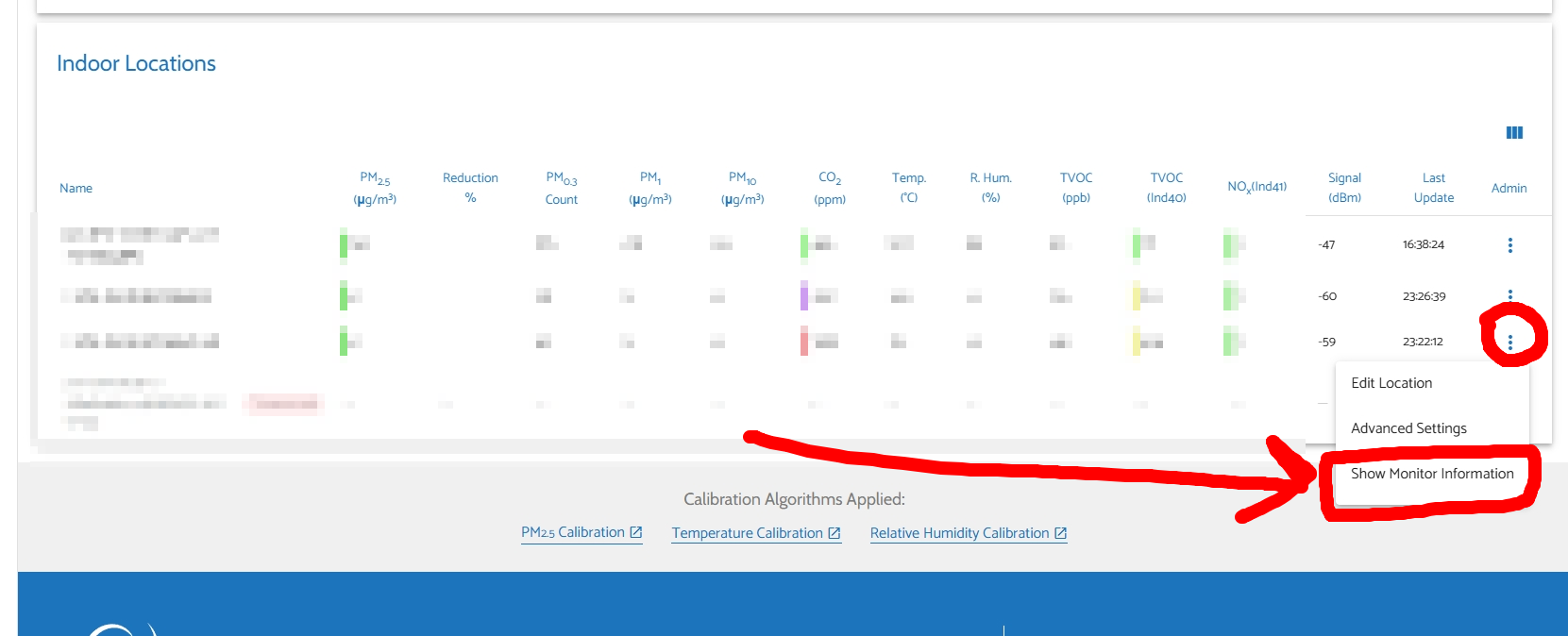

Hi @gianfranco.bottini I have set the target firmware for your dashboard to 3.6.2 already. I believe it could take a while (a few hours) before your air monitors detect the new firmware, as the AirGradient ONE and Open Air checks for a new update once every hour.
Anyway, you can simply force it to update more quickly by power cycling the monitor (unplugging and plugging in the power adapter or the USB-C), as the AirGradient ONE and Open Air will also check for a new update every time it first boots up (after it loses power and has access to power again).
Please note that from your dashboard view, you may not see a selected firmware as 3.6.2 in the firmware setting page; you might see a blank ‘selected’ version, which you can ignore.
It could look like this:
Please completely ignore this and don’t have to do anything to get the 3.6.2. Then, you can open the ‘Show Monitor Information’ of each monitor to see if it is updated or not.
Thank you, and please feel free to let me know if that doesn’t work.

The firmware setting page was showing “Seleceted”, as in the screenshot posted by Tai and the firmware updated to the 3.6.2 for both my monitors :slight_smile:
