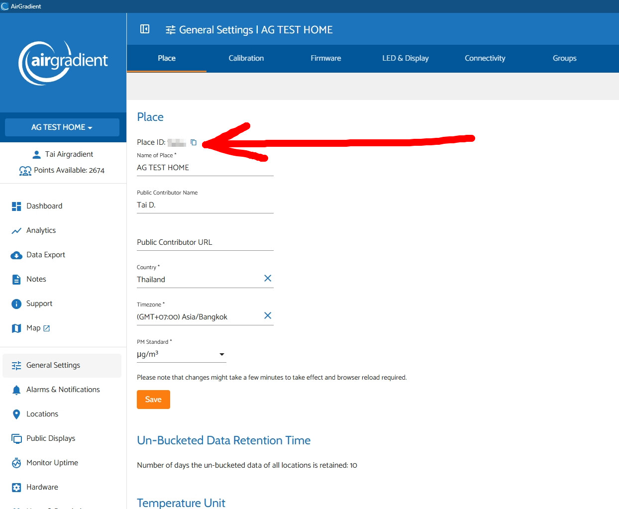

If you are interested, please let us know your ‘Place ID’ via our support form: https://www.airgradient.com/support
Please also refer to this reply in your support ticket.
How to see your Place ID?: Go to your AirGradient Dashboard > General Settings > Place [as shown in the below image]
We will enable the 3.6.2 on your AirGradient Dashboard, so you can select and update your monitors to 3.6.2.
