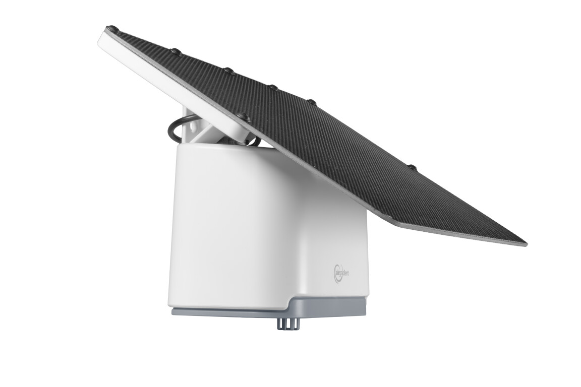

A good alternative to the AirGradient Open Air in this use case is the AirGradient Open Air Max that comes with batteries and a solar panel.

For the AirGradient Open Air Max, we only have fully assembled versions (O-M-1PPST-CE and O-M-1PPSTON-CE), as the devices are quite a lot more complicated than our iconic AirGradient ONE and Open Air, which can be assembled in a few minutes. (The Open Air Max has significantly more components, wires, and multiple PCBs (e.g., cellular module board, board for additional electrochemical sensors (O-M-1PPSTON-CE variant).
However, the openness of the hardware and firmware remains fully open-source like our other products, so you don’t have to worry about proprietary lock-in stuff.
