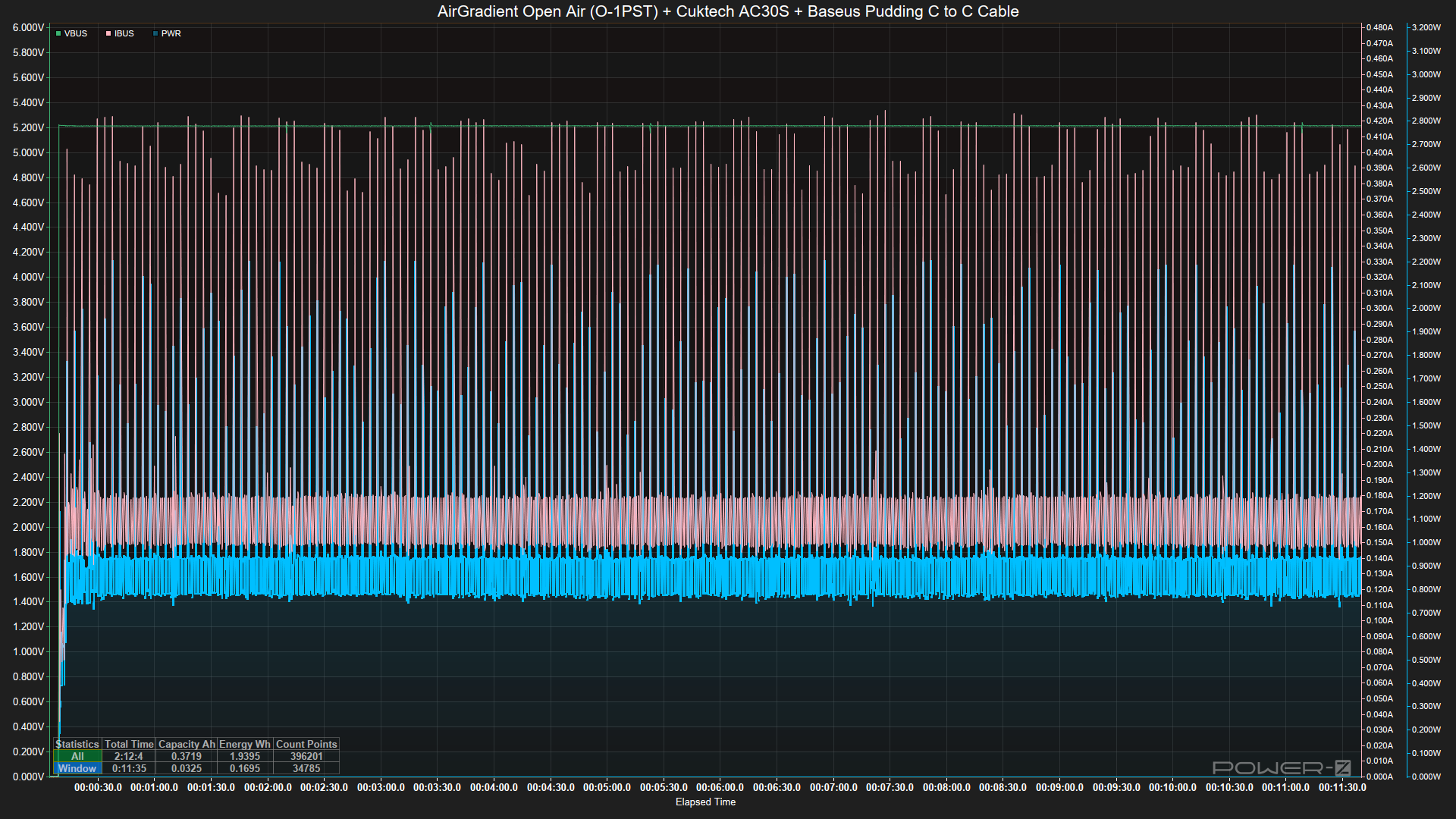

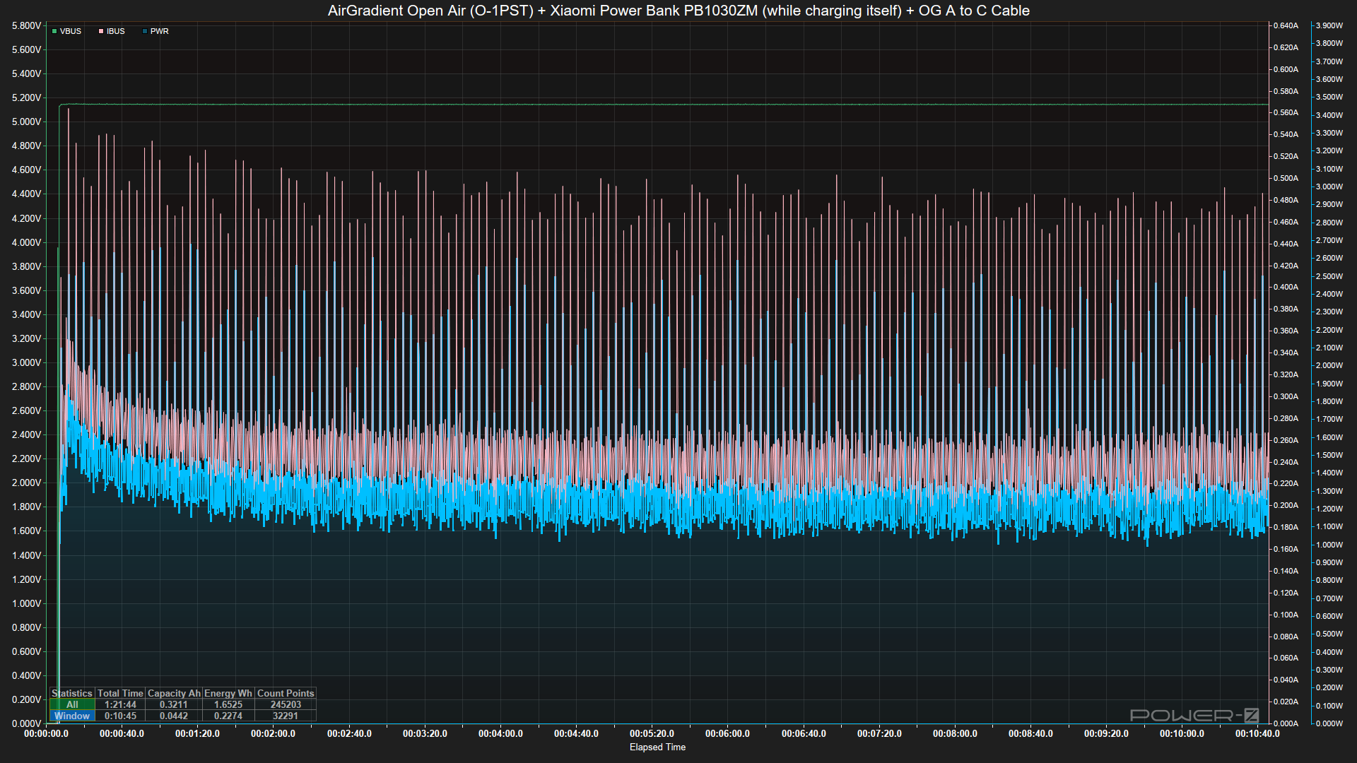

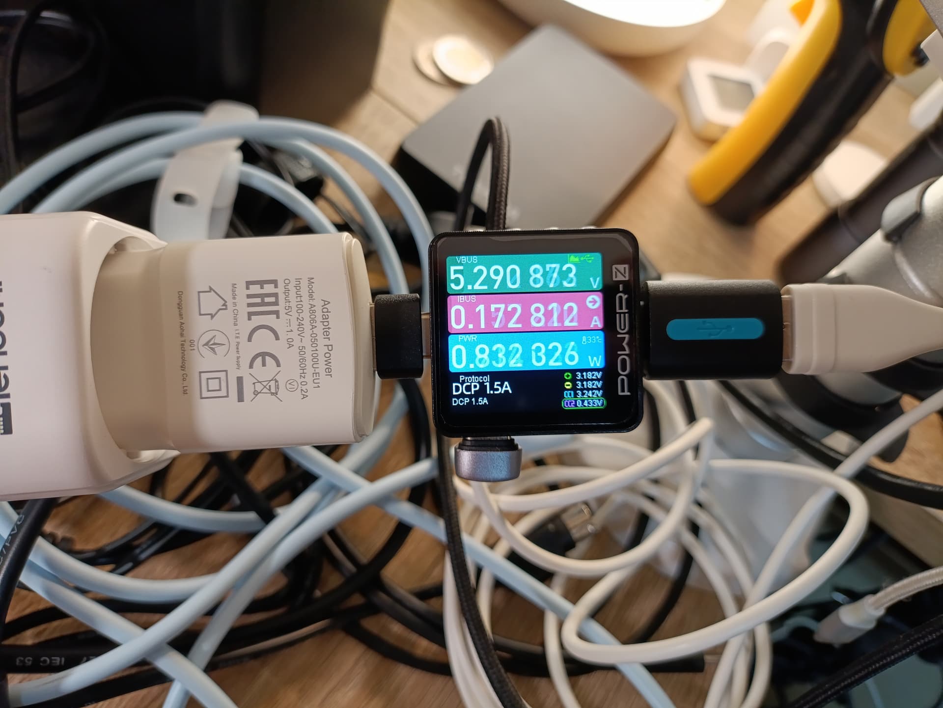

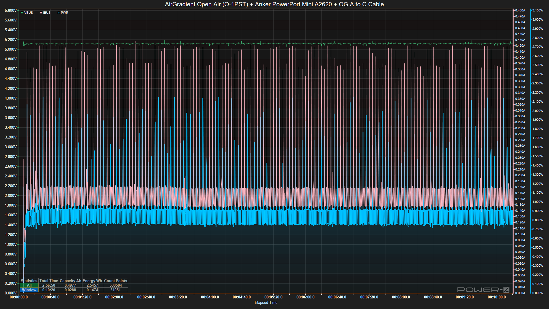

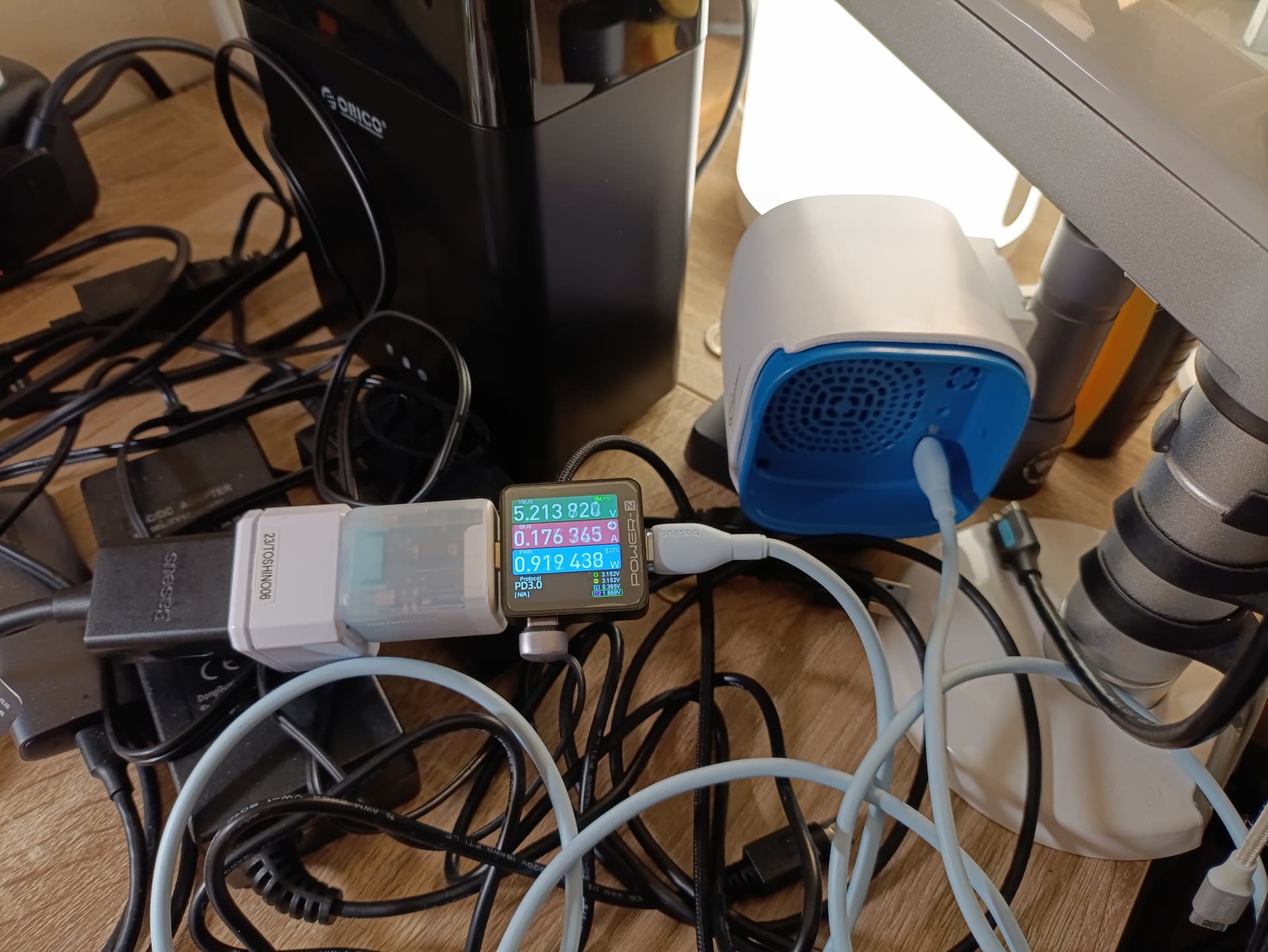

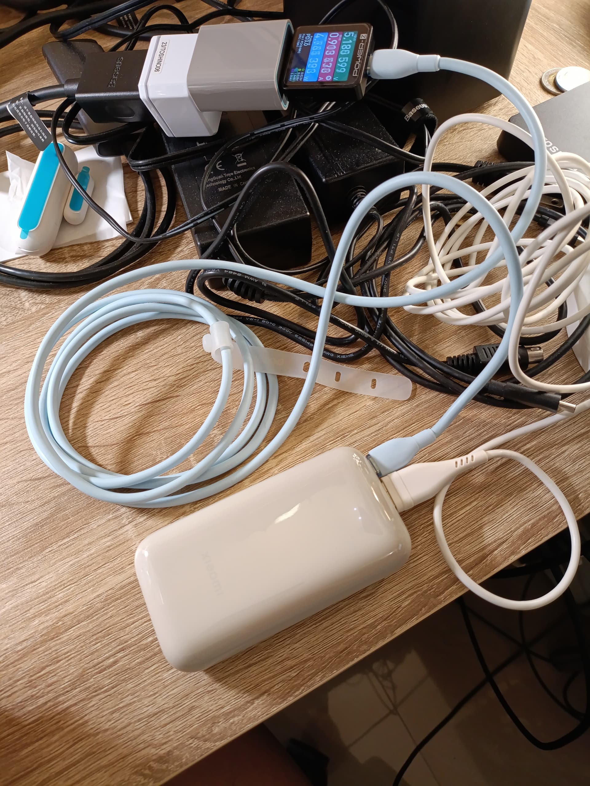

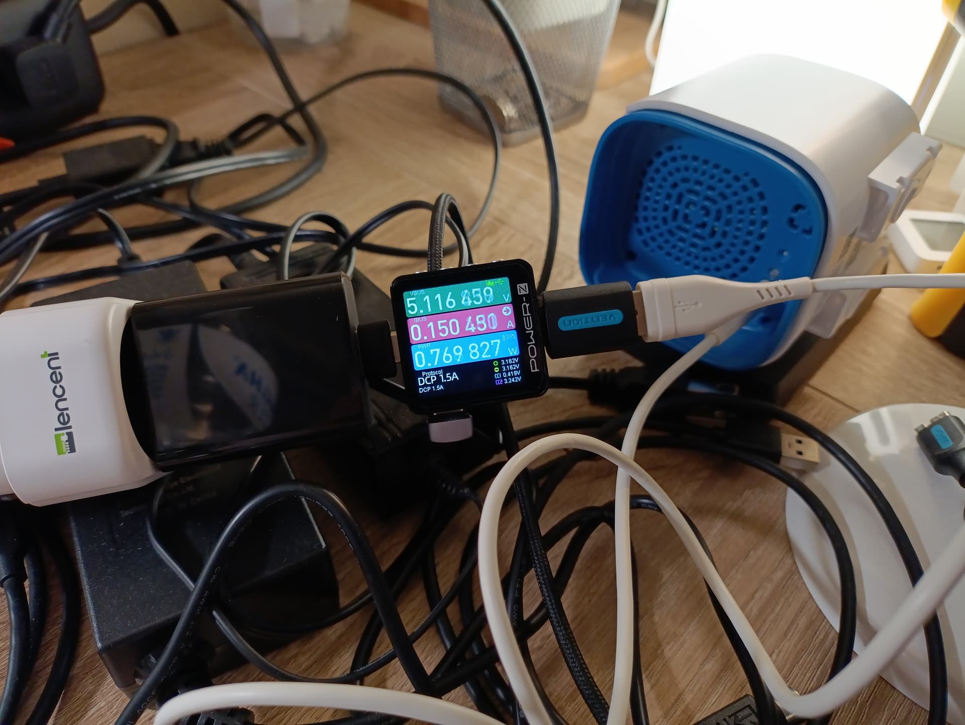

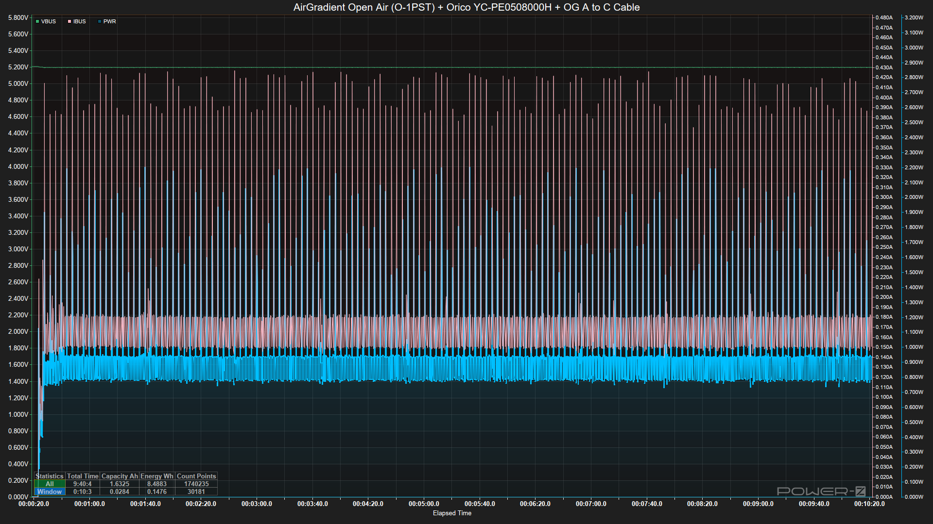

I just want to share my tests regarding the Open Air O1-PST and its USB power consumption and third-party USB power supplies compatibility. Including a test with a power bank. All tested using a USB tester, POWER-Z KM003C.
Generally, AirGradient Open Air’s compatibility with third-party USB power supplies is decent (as all USB-powered devices should be). The Open Air normally uses 1.9-2.8W of power. And it operates properly with input ranges from 5.0V to 5.2V.

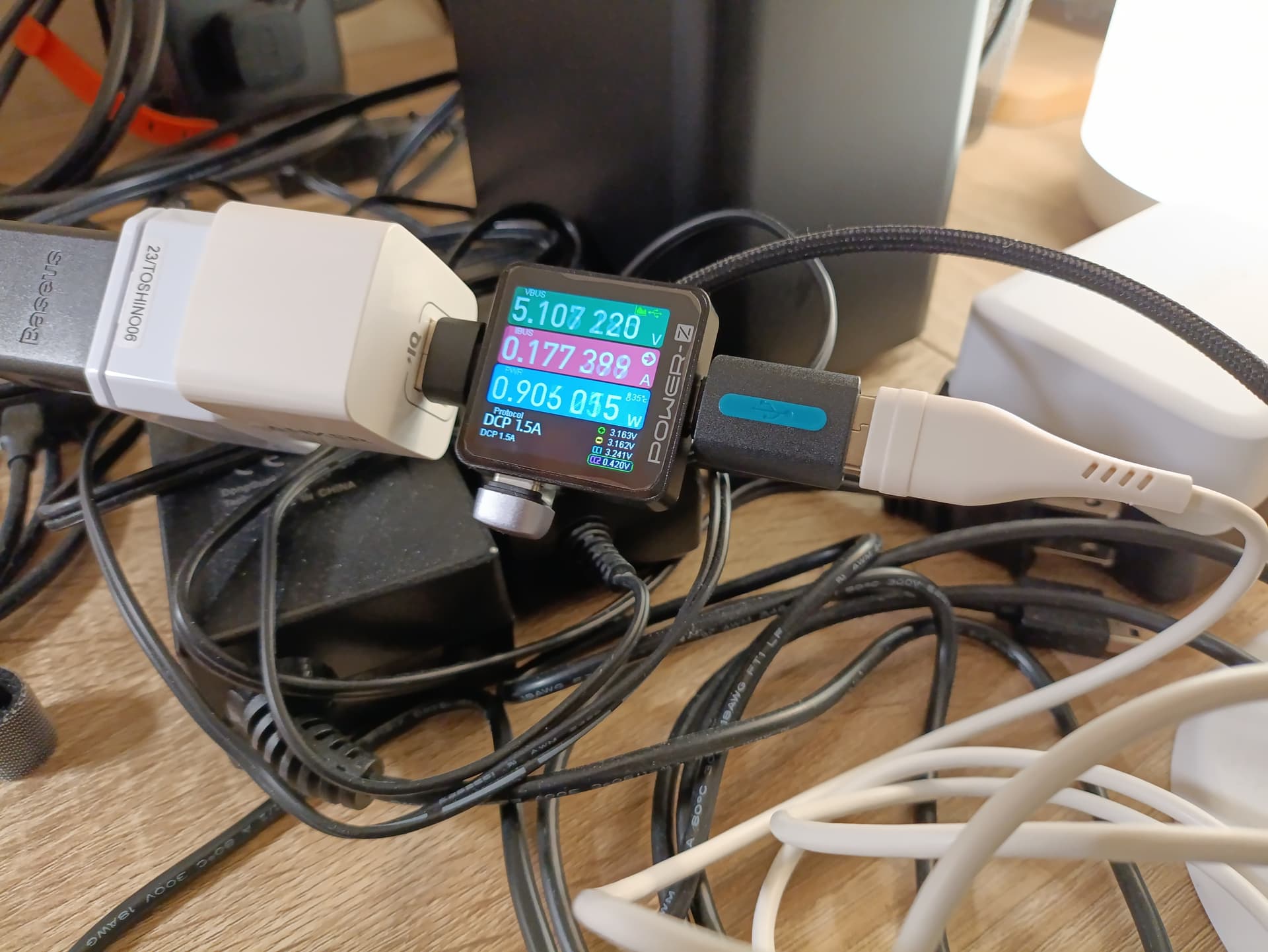

Refer to the protocols displayed on the tester’s screen, it works normally with both USB PD3.0 and DCP 1.5A (a part of the USB BC1.2 standard). Normally, almost all standard USB power supplies are equipped with one of these protocols as their charging profiles, so there’s nothing much to worry about. Just remember, there are some weird non-standard USB power supplies out there anyway.

- Cuktech 30W USB-C (AC30S)
- Orico 40W USB-A 5 Ports (YC-PE0508000H)

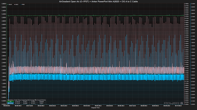

- Anker Power Port Mini USB-A 2 Ports (A2620)

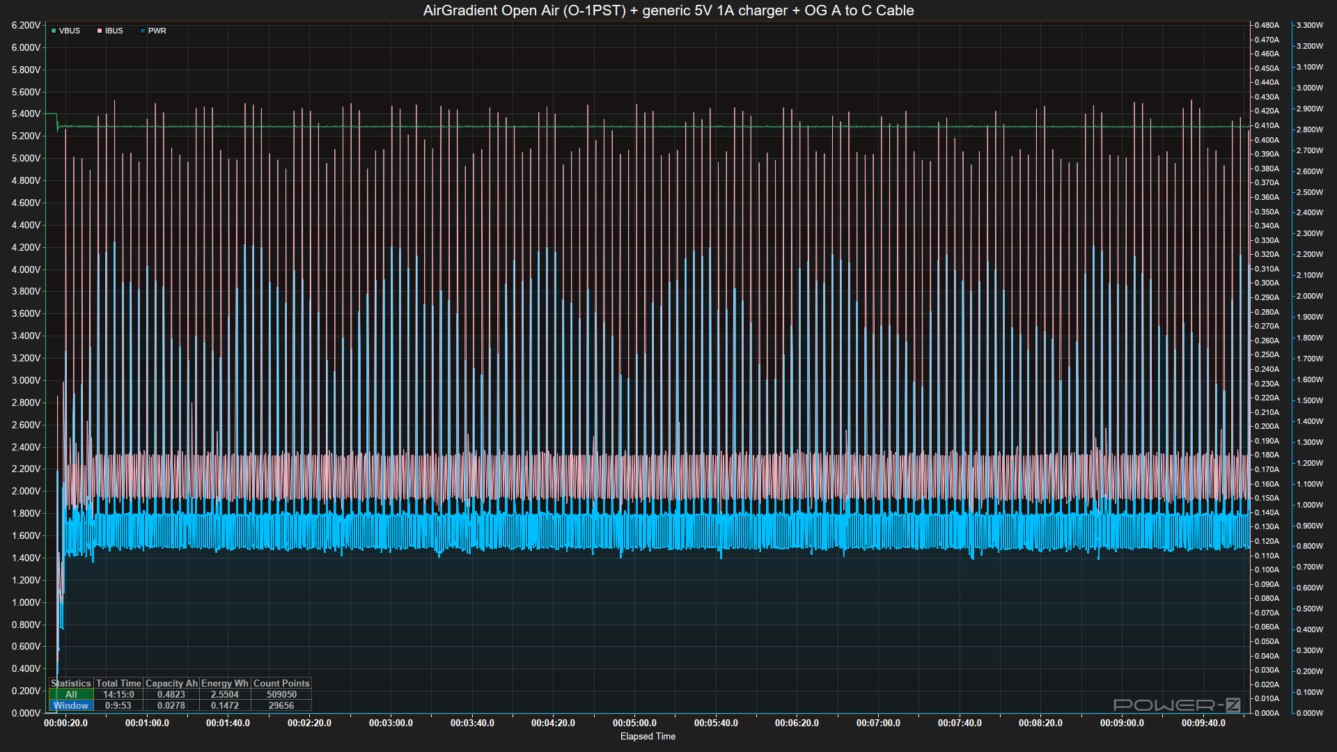

- generic 5W USB-A (A806A-050100U-EU1) - manufactured by Dongguan Aohai Technology Co., Ltd.

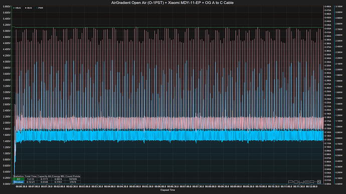

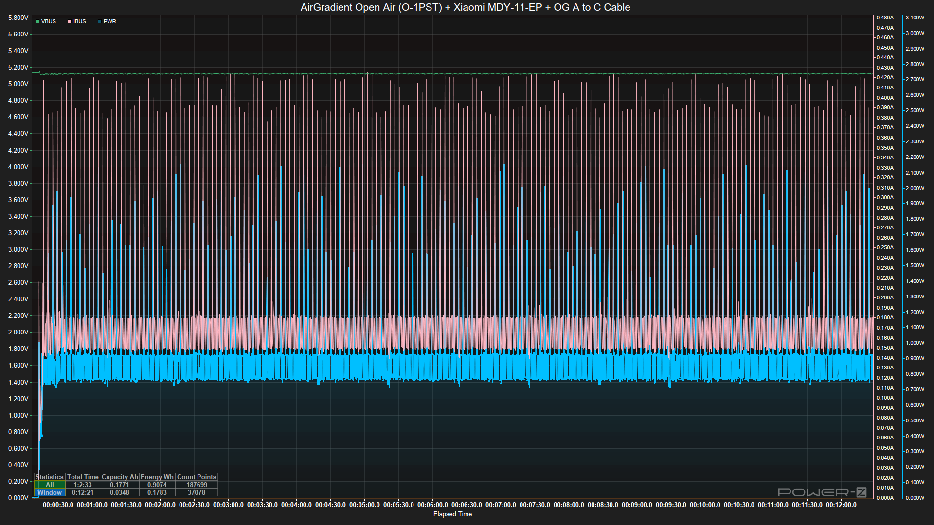

- Xiaomi 22.5W USB-A (MDY-11-EP)
- Xiaomi Power Bank PB1030ZM (charge and discharge the power bank simultaneously to test using as a UPS for the Open Air)

P.S. Forgive me for the poor space management in my workshop showed in the photos, it’s definitely a mess.
1. Cuktech 30W USB-C (AC30S)

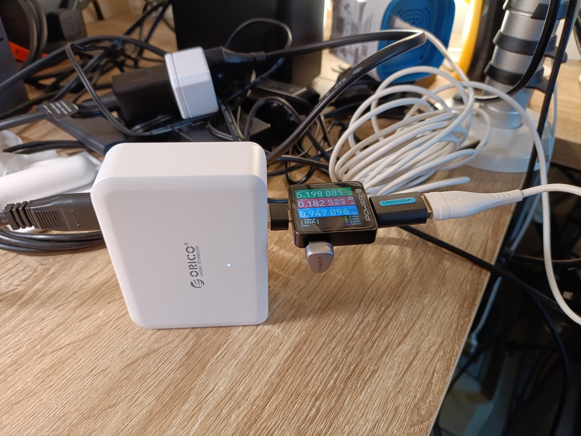

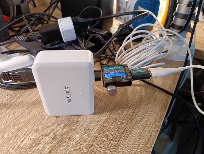

2. Orico 40W USB-A 5 Ports (YC-PE0508000H)
3. Anker Power Port Mini USB-A 2 Ports (A2620)
4. generic 5W USB-A (A806A-050100U-EU1) - manufactured by Dongguan Aohai Technology Co., Ltd.
5. Xiaomi 22.5W USB-A (MDY-11-EP)
6. Xiaomi Power Bank PB1030ZM (charge and discharge the power bank simultaneously to test using as a UPS for the Open Air)
