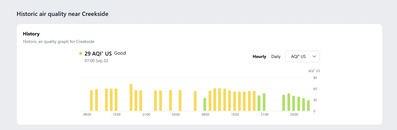

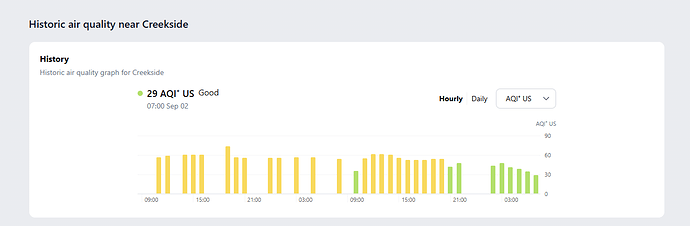

Sensor "unstable" on IQAir

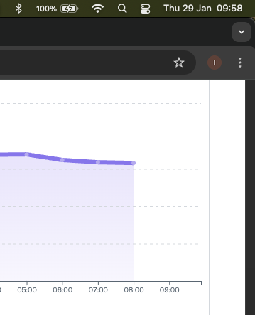

My sensor is constantly going offline on IQAir, but on AirGradient & OpenAQ it’s stable.
Any ideas?

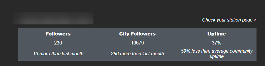

IQAir says the sensor reporting uptime is less than 75%.

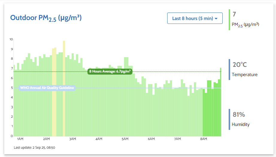

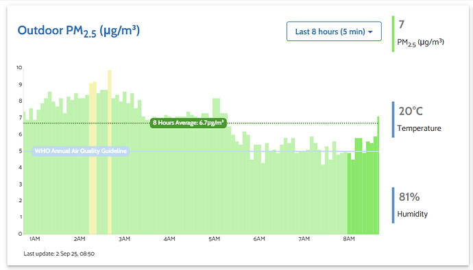

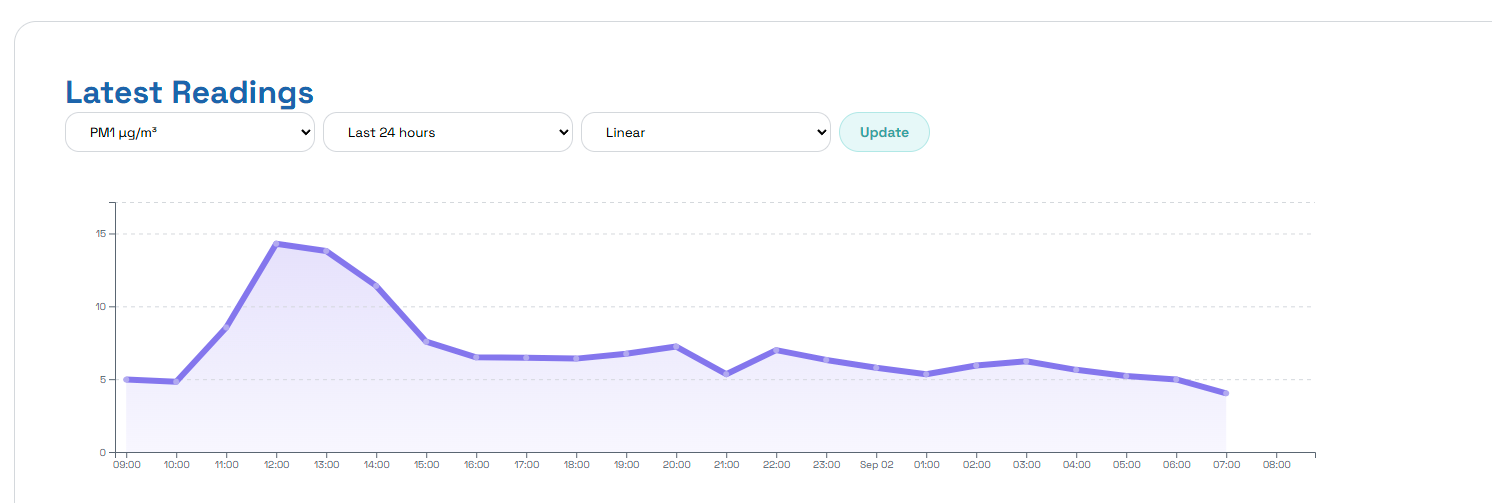

OpenAQ:
AirGradient:

But anyway, @Ethan_AirGradient, why OpenAQ receive the data with 1h delay?
OpenAQ responded that everything is good on their side and errors on IQAir side, but they clarified that IQAir is aware of this issue and is working on a fix.
I think I can comment on this:
AirGradient reports hourly averages using a time-beginning convention
Example: 14:00 = average from 14:00–15:00
OpenAQ use time-ending
The same data is shown as 15:00
OpenAQ automatically converts AirGradient timestamps, which creates the impression of a 1-hour delay.
