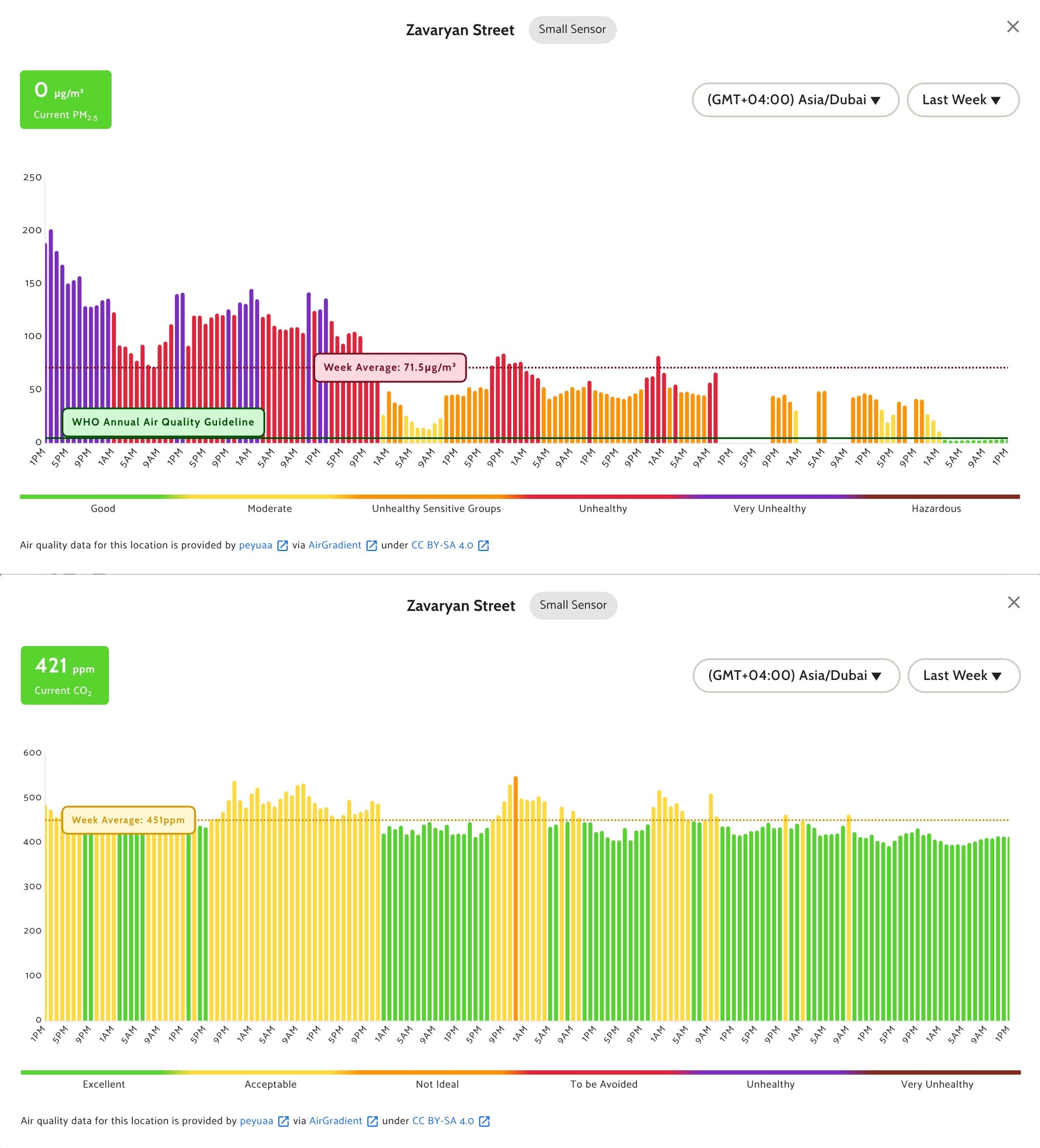

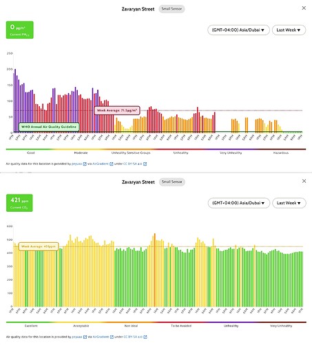

Hi! Yes, that’s the correct monitor: “Zavaryan Street.”
I just checked again and it’s now visible under all filters (PM2.5 / US AQI / CO₂). Thanks for looking into it!
For reference, I’m attaching screenshots from when the issue was happening: the monitor was available under the CO₂ view, but it did not appear under PM2.5 / US AQI on the map (even though data was still fine in the AirGradient dashboard and OpenAQ).
Thanks again!
