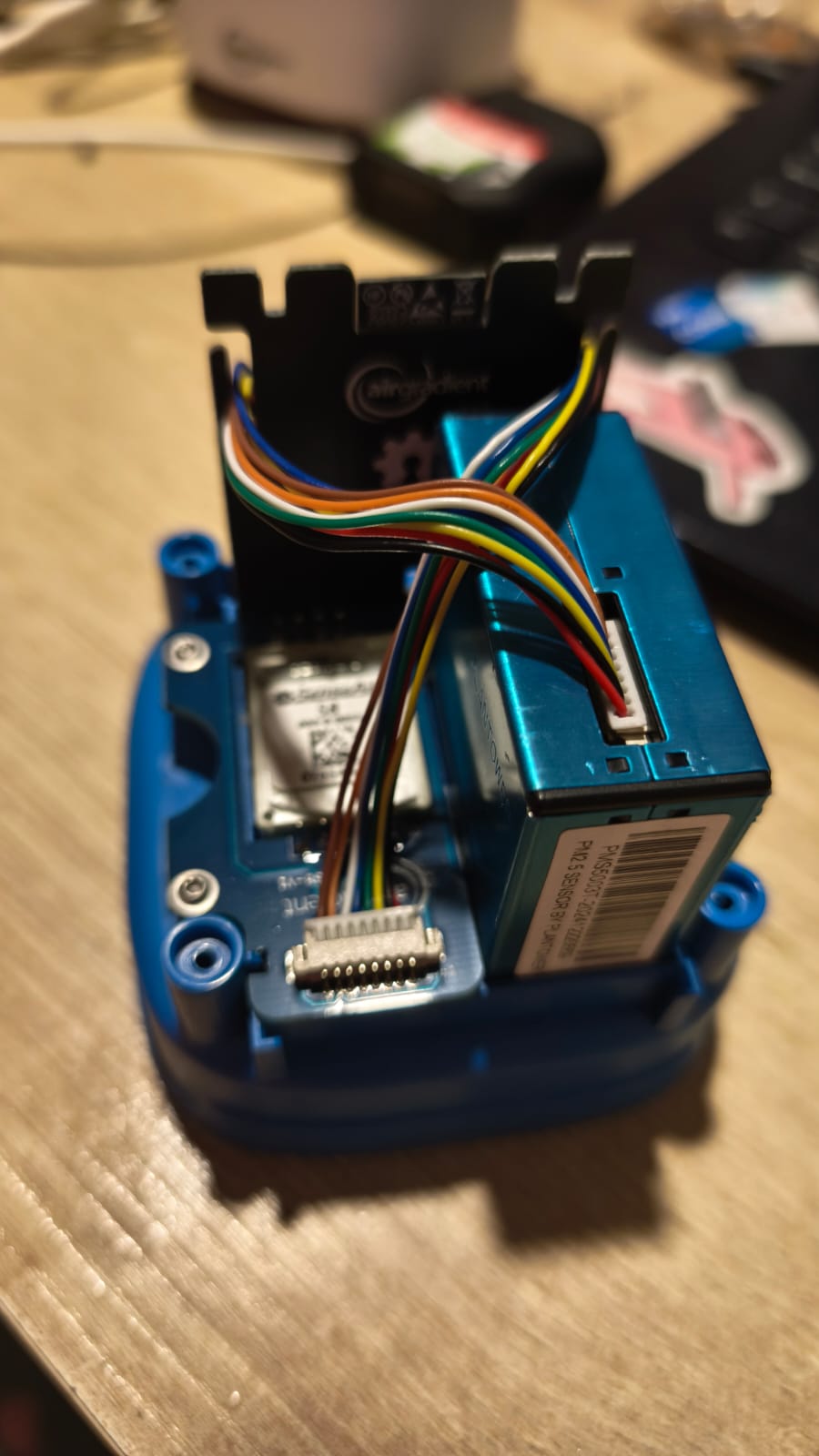

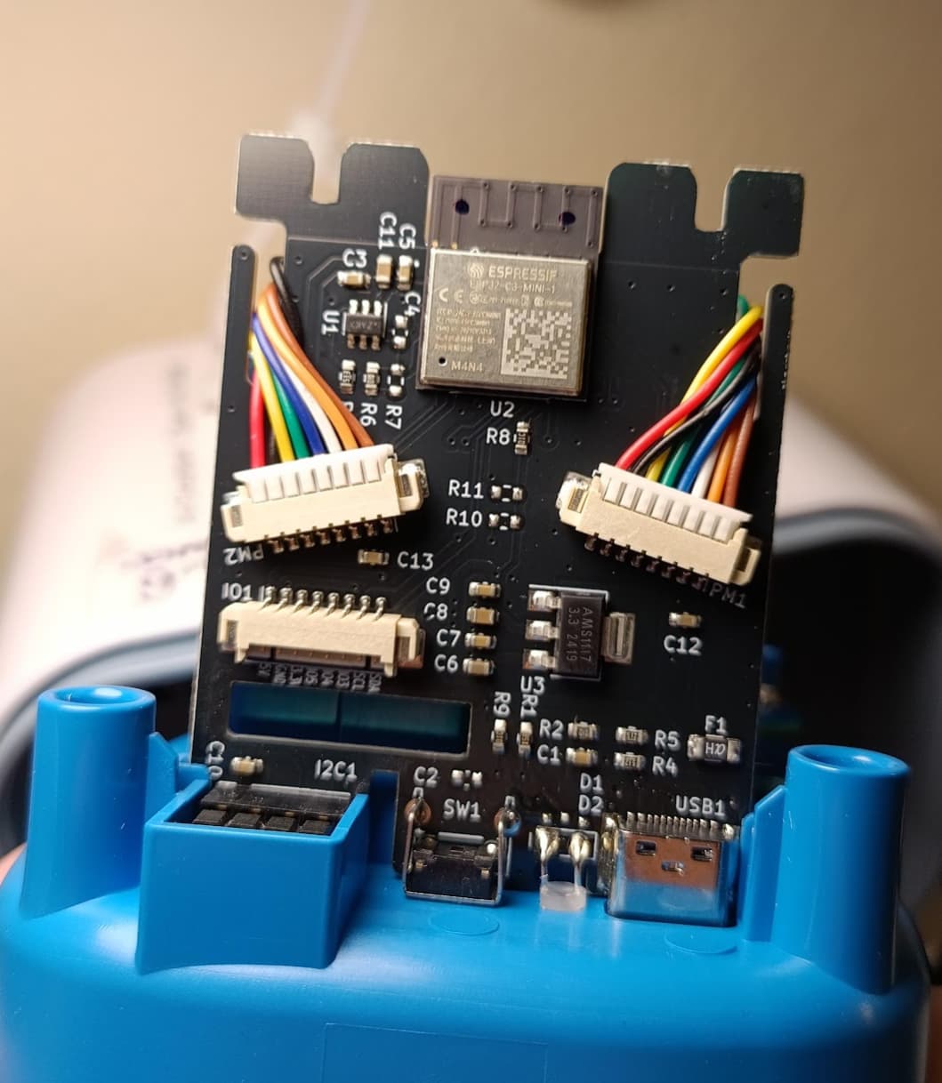

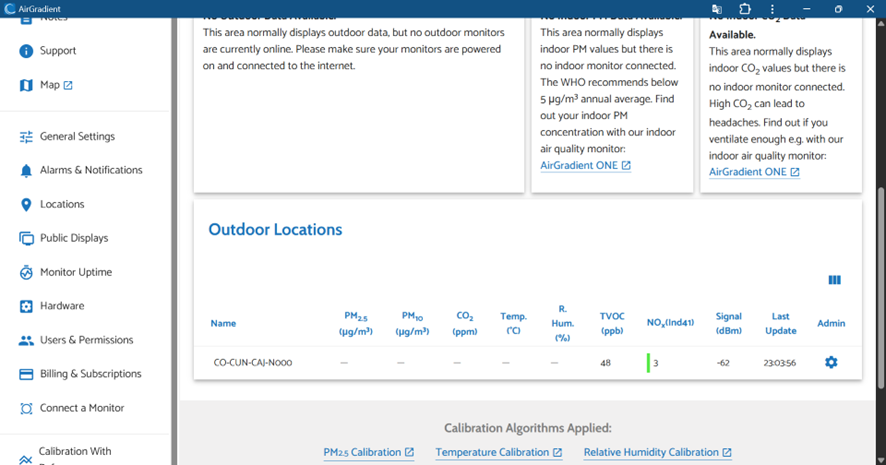

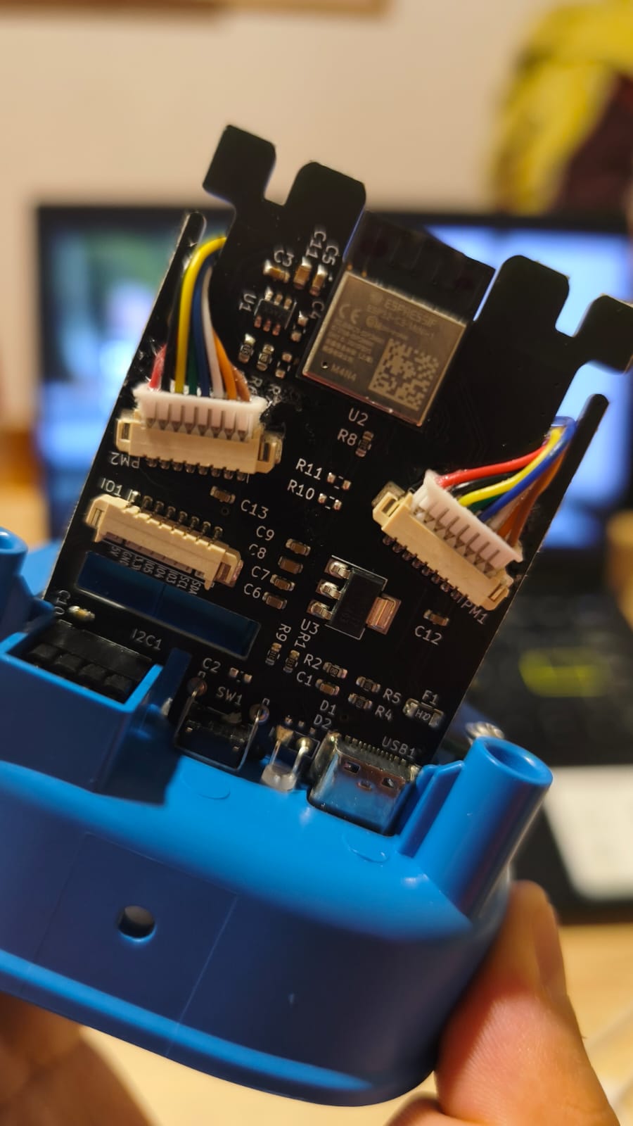

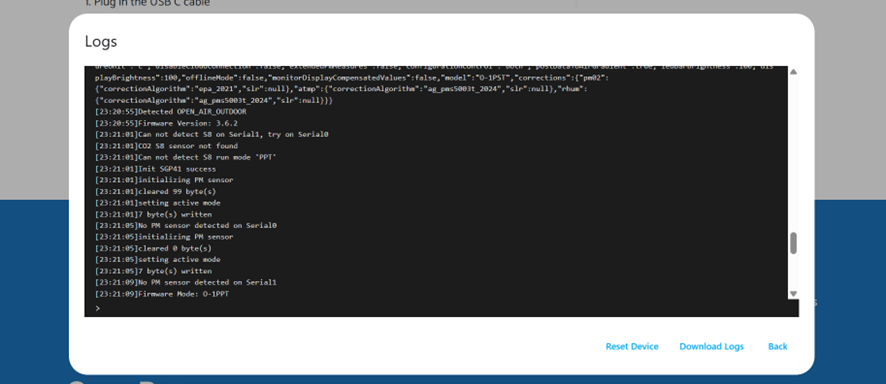

Thanks for your answer. I already reviewed each point you suggested, and everything is ok. So, I don’t know what the problem is. Sometimes the CO2 doesn’t work, and sometimes it’s the PM sensor which stop measuring or both of them. I tried to reinitiate the power cycle, resetting the device by USB-PC, unassembling… I did a test in another location too. The sensors measure well and are functional, but the connections are not stable; they work well for two to three days and suddenly stop… Maybe anything about the microcontroller or JST cables?
However, I attached some pictures and screenshots.
Hi @jcfraileb, thank you for providing more info about this.
It seems the JST connectors are not securely plugged into the socket. Could you please check and ensure the connection, then let your unit run and see if the sensor dropouts still occur.
