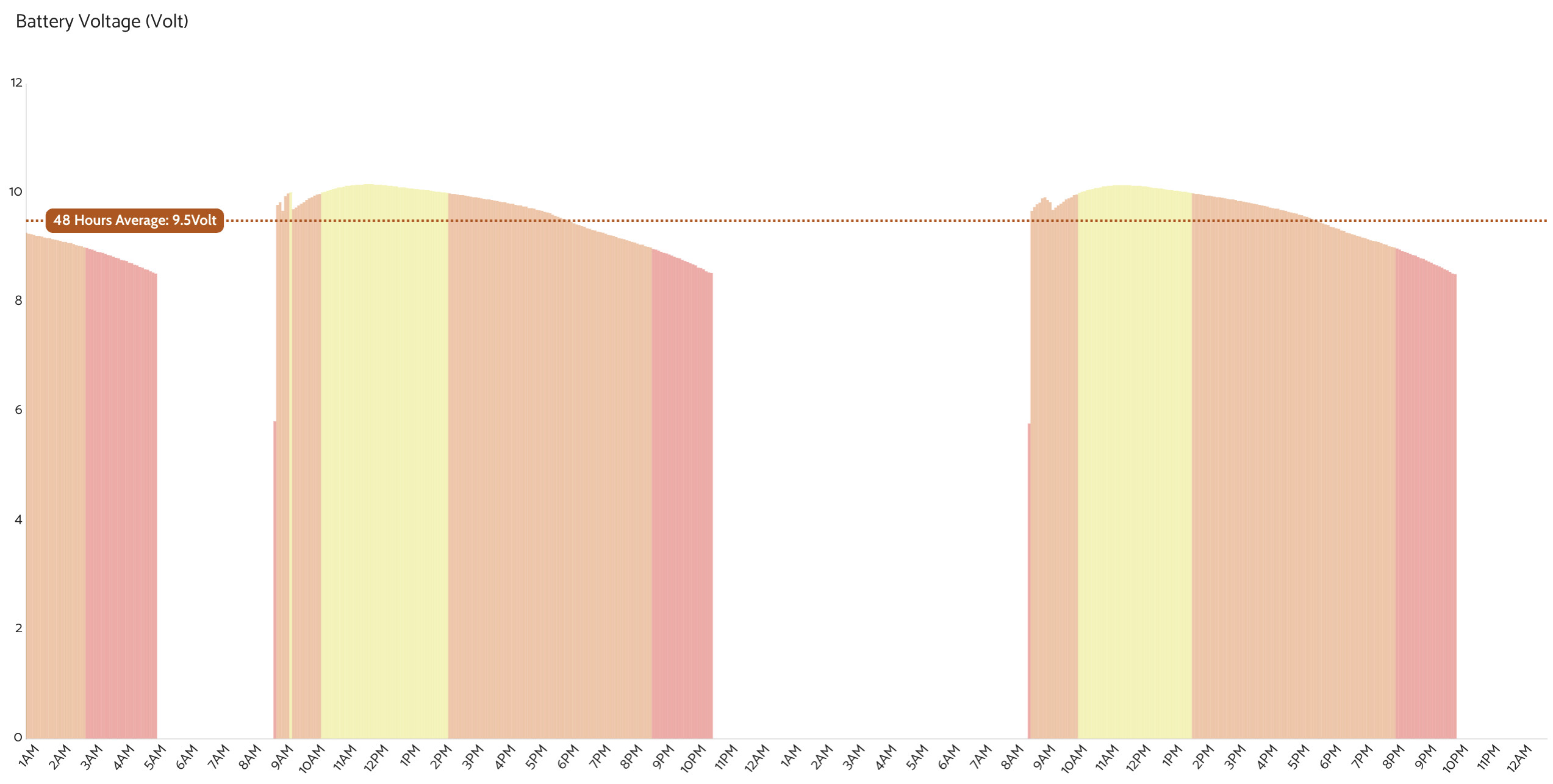

a) The Open Air Max did finally start reporting about five hours after I deployed it for the second time. It then stopped reporting overnight and started again a few hours after sunup the next day. So I’m wondering if the batteries are low. How can I see battery state?

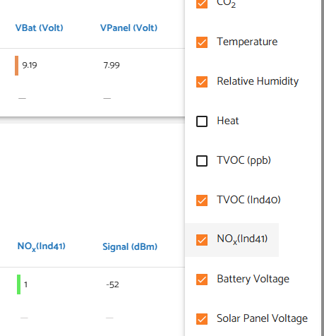

On the Dashboard site, under Outdoor Locations on the far right is an icon with 3 bars. Click on it and you can enable other columns, including “Battery Voltage” and “Solar Panel Voltage”
I’m also working with support on my device that behaved similarly where I saw LEDs on but it wasn’t reporting. I suspect the LED can still function with much lower voltage than the cellular modem needs, so the device maybe “running” even if it isn’t actively reporting back to the Dashboard until it gets a sufficient charge.

I’ve confirmed battery voltage is (at least part of) the problem.
