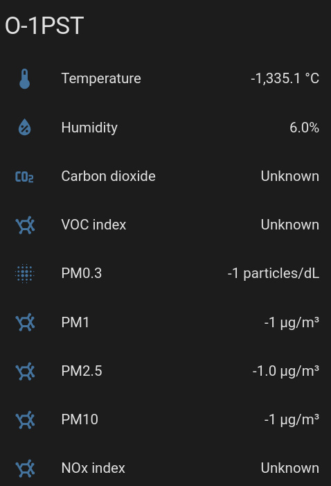

New Open Air unit (O-1PST) arrived and installed yesterday. Everything seems to work well most of the time (and was easy to set up!). However, every fifteen minutes, every sensor shows nonsense values before returning to normal values on the next sample.
The current firmware is 3.1.3 (which, considering it just arrived yesterday seems a bit old?).
Has anyone seen this behaviour?

A firmware upgrade looks like it worked. It has been running without impossibly low temperature readings for several hours now.
