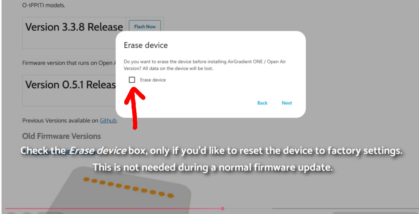

Hi @Nainokami , you can follow this video guide (if you prefer video) to entirely reflash your I-9PSL-DE: https://www.youtube.com/watch?v=L6oY8jS-1Do
Here is the link to the firmware page: AirGradient ONE (I-9PSL), Open Air (O-1PST) and Open Air Max (O-M-1PPST...) Firmware Versions
Please also check the ‘Erase device’ box:
Also, please be informed that the firmware on our web firmware flashing tool is 3.3.8, but the latest firmware version available on the AirGradient dashboard is currently 3.6.0 (newer than what you can flash using our web firmware flashing tool)
So, if your monitor is connected to AirGradient’s cloud, after you reflashed your I-9PSL-DE, successfully connected to your Wi-Fi, and established a connection to the AirGradient server, your I-9PSL-DE will detect that there’s a newer firmware and perform an OTA firmware update which would take some time.
