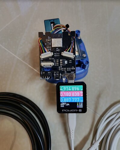

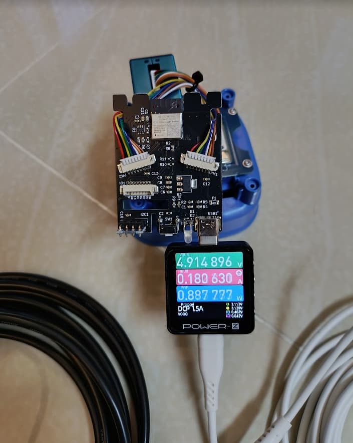

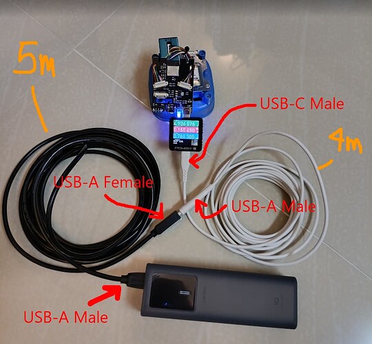

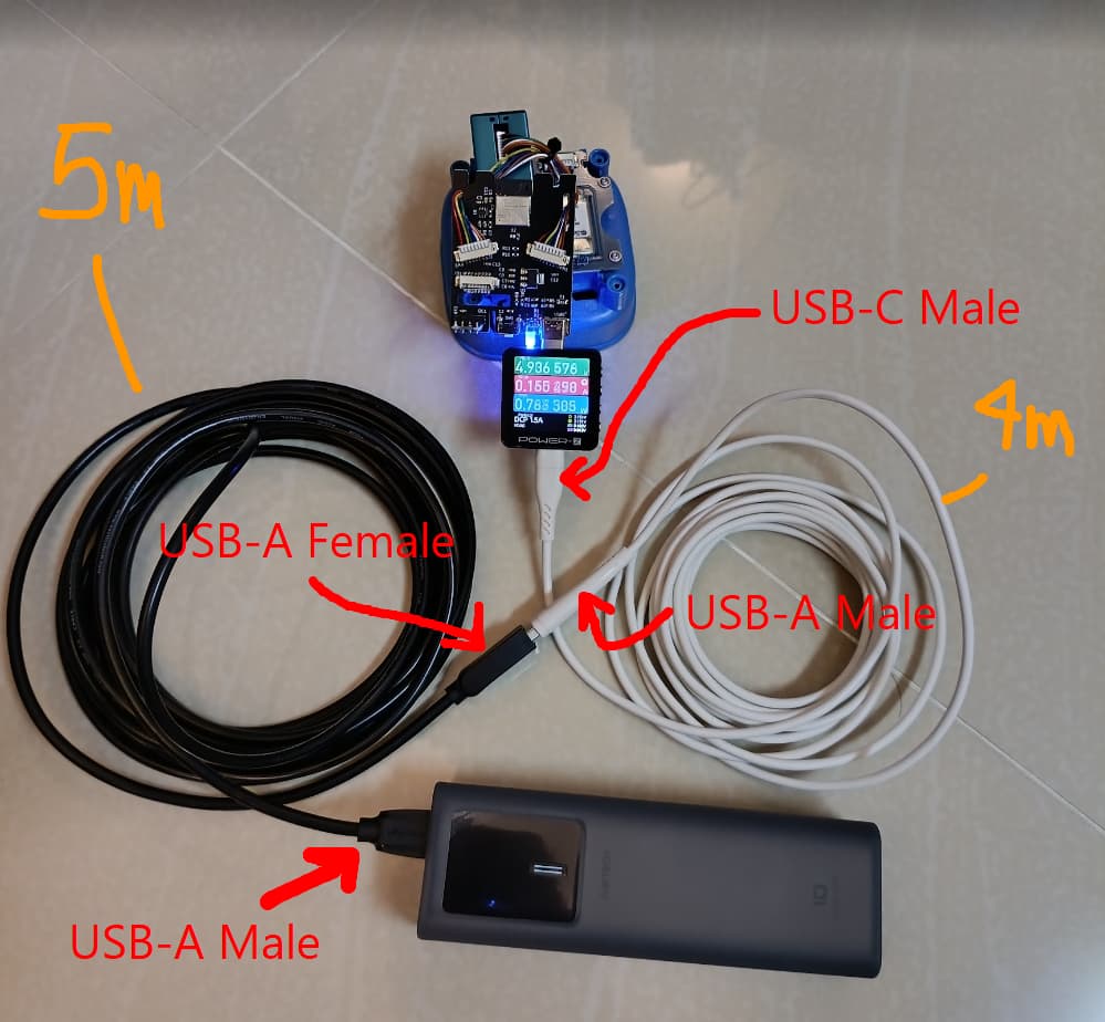

What I have tested is that my 5m USB-A (male) to USB-A (female) extension cable, plus the original 4m USB cable of the AirGradient Open Air, can get my Open Air up and running. The voltage at the end of the Open Air cable (Male USB-C) is around 4.8-5.0V (I tested with both a 5V USB-A power adapter and my power bank with a USB-A outlet as a power supply). Voltage depends on your power supply and cable quality.
While it’s not usually recommended to run a USB cable this long, as it could cause a voltage drop and interference, I just want to demonstrate that it could still work (but I really have no idea how it would perform in the long run). I only tested this for 5-10 minutes. Have never had a real Open Air setup with this same configuration yet.
It’s important to note that the SenseAir S8 (CO2) sensor used in the Open Air, is sensitive to abnormal voltage (I’d say lower than 4.5V), its CO2 reading will spike tremendously, basically your CO2 reading will be unusable.
Also, if the voltage is lower, if not boot up at all, your monitor could be stuck in a boot loop, as it can boot up first, but then is unable to operate normally.
