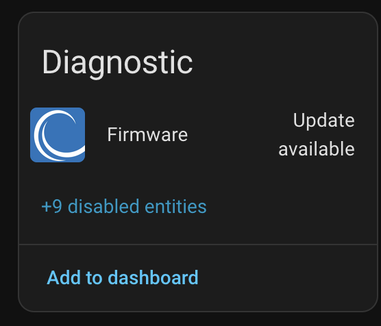

I can also see that there is a firmware update available:
Screenshot 2025-11-11 at 1.27.04 PM

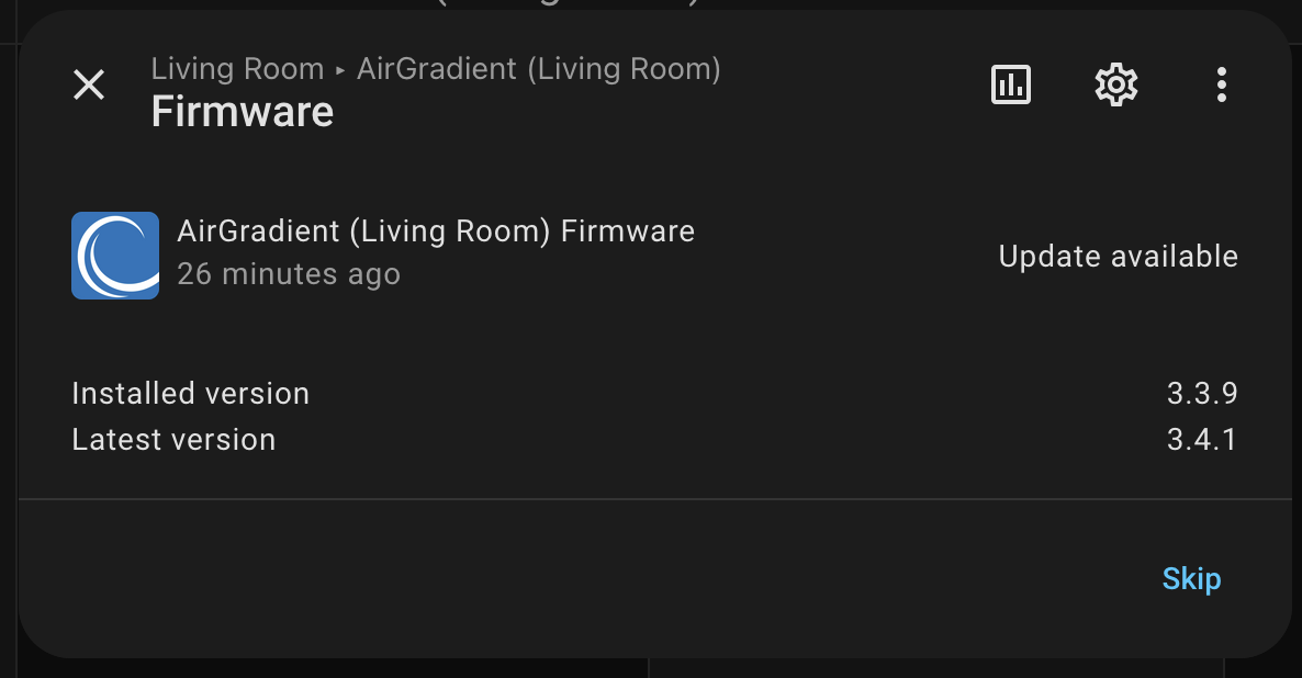

Clicking on that brings up another page that shows the installed version is 3.3.9 and the latest version is 3.4.1, but it does not seem to provide a button to actually perform the update, only a “Skip” button. How do you actually do the firmware update? (Or does Home Assistant merely show that an update is available, but lacks a mechanism to perform the update?)

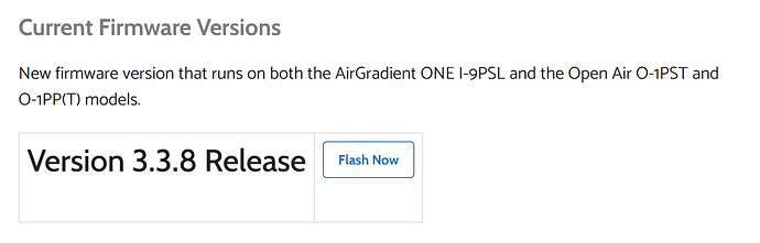

I also found this page that has a browser-based firmware update utility: AirGradient ONE (I-9PSL), Open Air (O-1PST) and Open Air Max (O-M-1PPST...) Firmware Versions
However, the latest firmware version there is 3.3.8, which is older than what my AirGradient came with (3.3.9) and the latest version as reported by Home Assistant (3.4.1). Is there a reason this page hasn’t been updated? Is this still a supported means for updating the AirGradient?

This is going to be a trouble point with running fully local. The Home Assistant integration only tells you that there is an update, there is no mechanism to do the update from there.

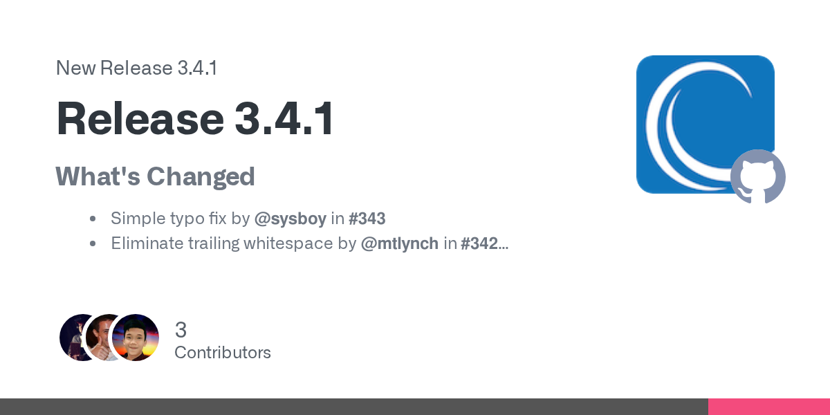

You can download the latest code from the Github page and compile it yourself if you would like:
The firmware page you found “should” contain the latest version, but for reasons that I don’t understand, the AirGradient team can’t find a way to keep that current and it doesn’t seem to be priority for them to manually update it with current releases, which is a big shame.
