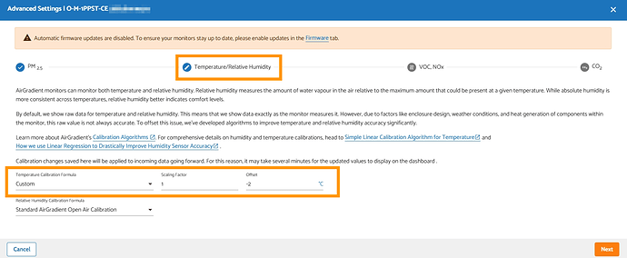

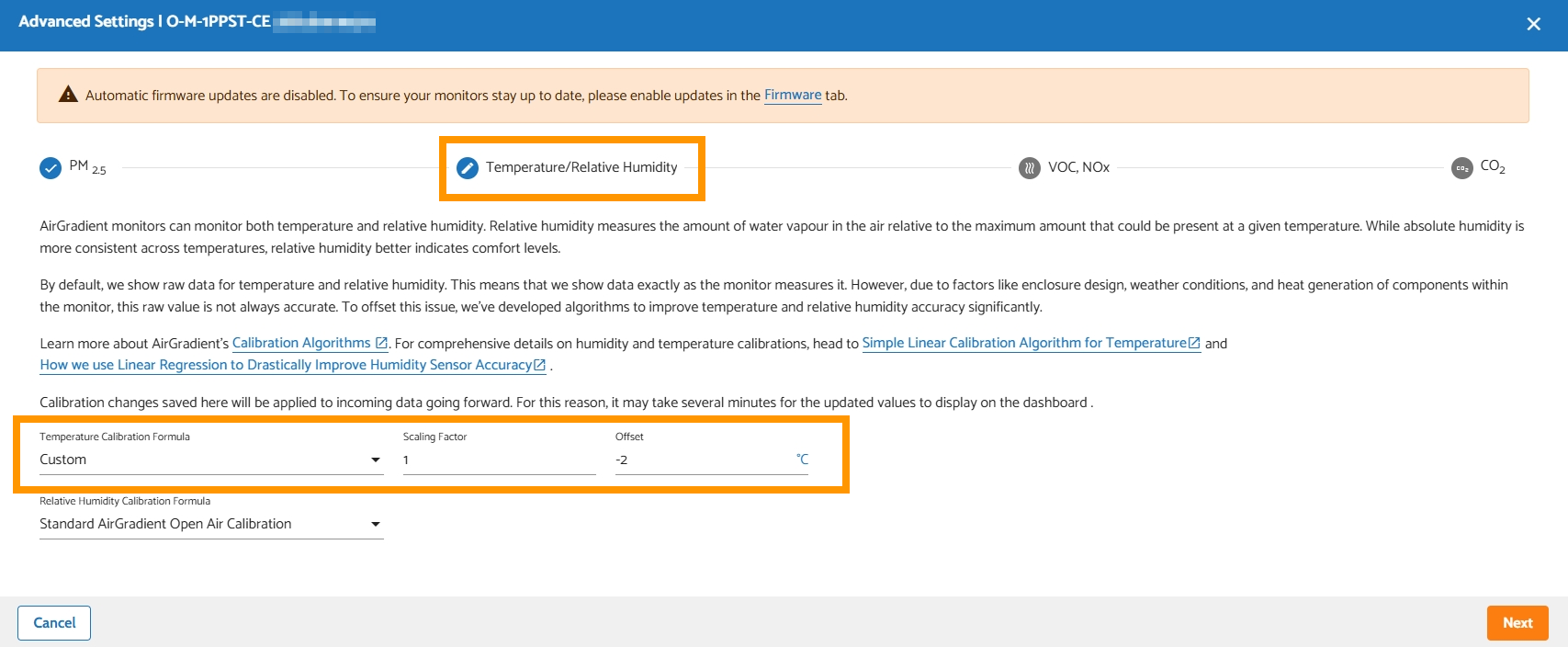

Hi @sebbil, to set a temperature offset for your AirGradient ONE (I-9PSL-DE), you can follow this guide to set the offset on your AirGradient Dashboard: Temperature/Humidity Sensor Calibration Guide | AirGradient Knowledge Base
In the ‘Edit Calibration’ window of your specific air monitor → go to ‘Temperature/Relative Humidity’ tab → set ‘Temperature Calibration Formula’ = ‘Custom’, ‘Scaling Factor’ = 1, ‘Offset’ = -2

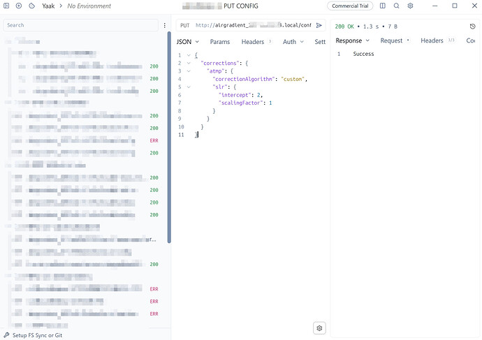

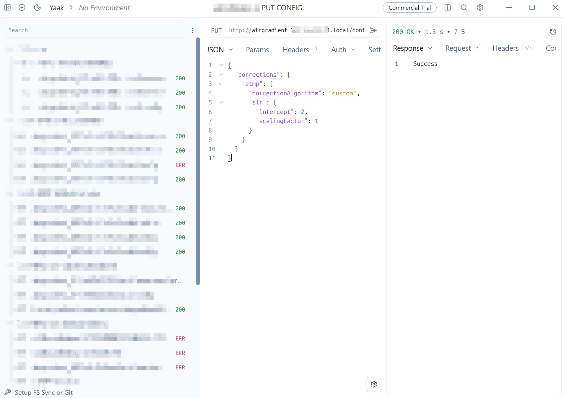

You can configure this locally using tools like Postman, Bruno, or Yaak, or with curl in your PC terminal to PUT JSON config to http://airgradient_SERIALNUMBER.local/config
You can use this for your specific case:
  "corrections": {
    "atmp": {
      "correctionAlgorithm": "custom",
      "slr": {
        "intercept": 2,
        "scalingFactor": 1
More details: arduino/docs/local-server.md at master · Open-Air-Foundation/arduino · GitHub

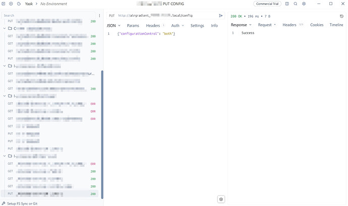

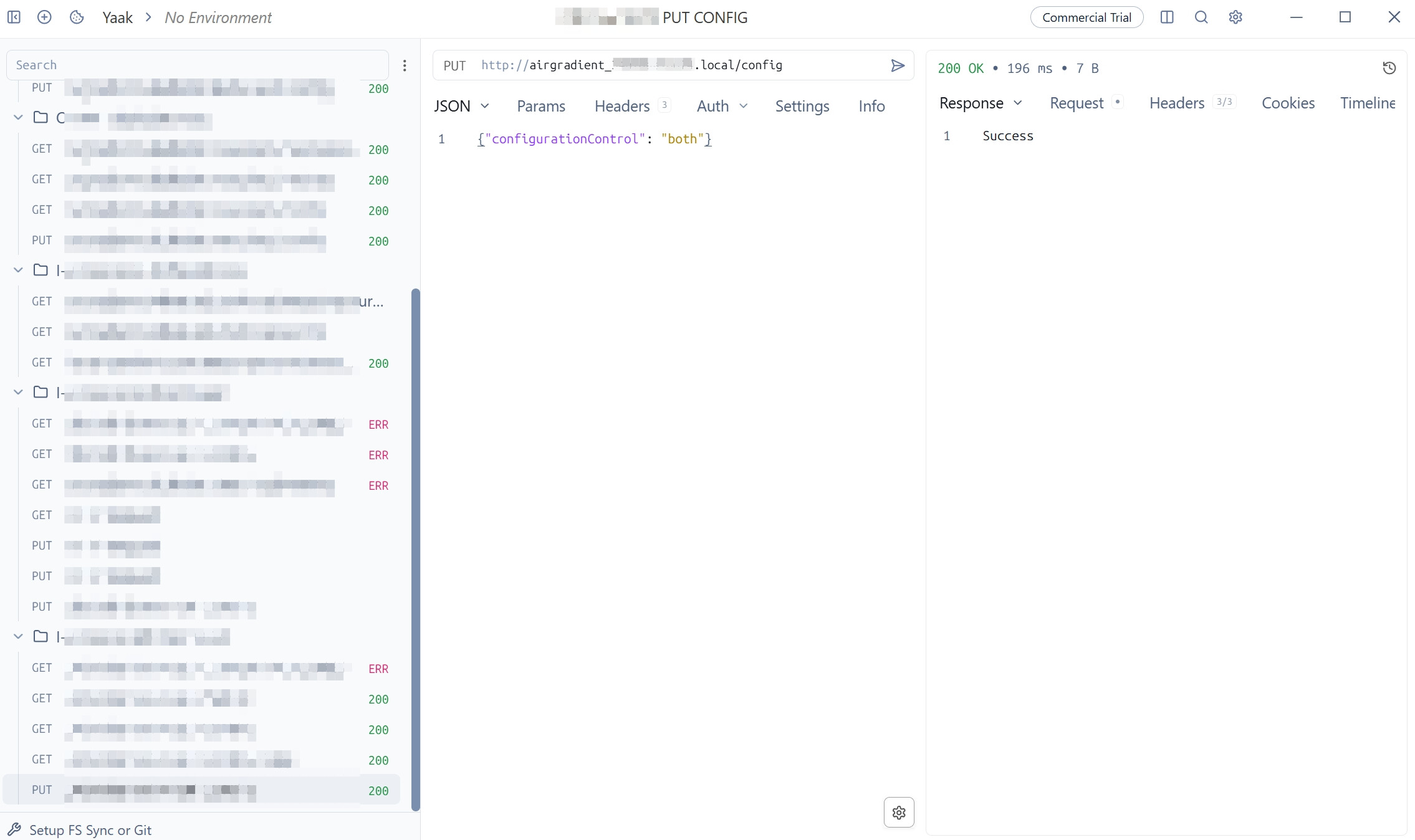

You can check http://airgradient_SERIALNUMBER.local/config using a web browser in the same local network as the AirGradient device.
Make sure that: "configurationControl" is set to "both"
If not, you can PUT the JSON below to http://airgradient_SERIALNUMBER.local/config
{"configurationControl": "both"}
Your AirGradient ONE’s OLED display should now reflect the corrected temperature.

I have tried this with my Windows 11 PC and can confirm it works. Please run this command in Command Prompt (not PowerShell):
curl -X PUT -H "Content-Type: application/json" -d "{\"configurationControl\":\"both\"}" http://airgradient_SERIALNUMBER.local/config
Regarding the configuration “both”, it is not directly relevant to the temperature and humidity calibration. But it is a setting that controls your AirGradient ONE to get the configuration you set (whether via local API, AirGradient Dashboard (cloud), etc.).
The “configurationControl” can be set to “both” (this one is the default), or “local”, or “cloud”.
“both” means the AirGradient device accepts the configuration you make whether via local API, AirGradient Dashboard (cloud), Home Assistant, etc.
“local” means it only accepts configuration made via the local API (including Home Assistant that interacts with the AirGradient device via the local API)
“cloud” means it will only accepts configuration made via the AirGradient Dashboard. It will ignore all configuration that is made via the local API (including Home Assistant, curl, etc.)
THANKS a lot …that worked …he anwers " success " :slight_smile: and 1 min later the temperatur is 2° less :slight_smile: :slight_smile:
