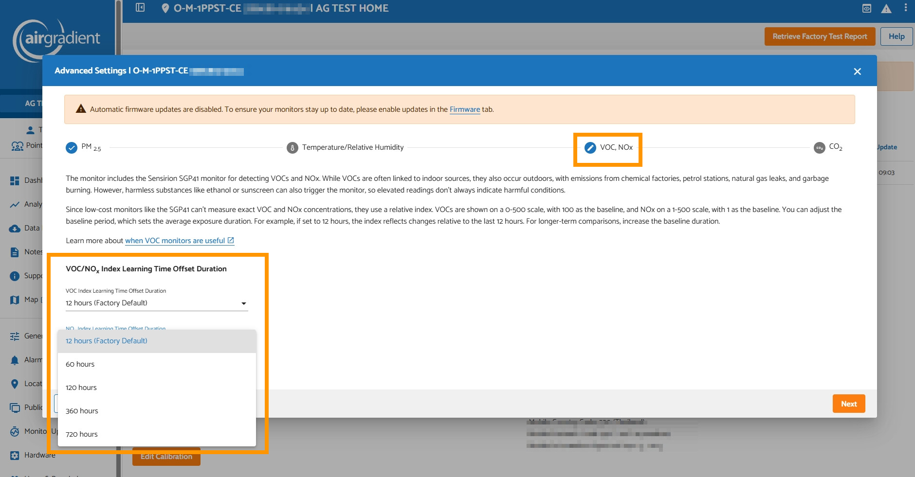

i’m curious about methods of recalibrating the Sensirion SGP41’s baseline.
do we know the time it takes for the SPG41 to treat ambient as baseline?
and do we know how long it takes for it to apply a low level as zero?
i’m sure i’m oversimplifying this. but i’m just curious whether monitor’s weekly 20-30 mins of exposure to outside air to recalibrate the CO2 sensor is recalibrating the SGP41 as well.
thanks!
Hi @wsm, you can take a look at this article. Ethan covered how the sensor works there: The SGP41 Detects NOx Events, But Can You Trust the Number?
Basically, the baseline duration is 12 hours, but you can change these settings on the AirGradient Dashboard by clicking a monitor on your list on the Dashboard → Edit Calibration → VOC, NOx. From the dropdown menu, you will be able to select 12 hours (default), 60 hours, 120 hours, 360 hours, or 720 hours.
