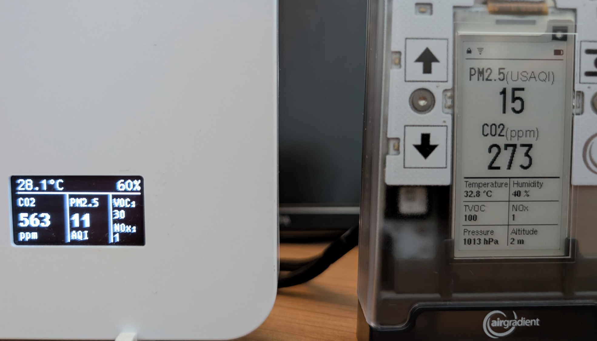

My new Go was about 20% off on CO₂ so I used the calibration setting and now reading 268, when ONE says 564
565
Should I do a factory reset? Seems to have latest firmware 1.1.2 out of the box
Temps about 4c high on GO, ONE seems correct. a couple days ago I opened the place and aired out.

Regarding the temperature readings, an offset of around 4 C is something we’re aware of with the AirGradient Go. This is mainly due to heat generated by the internal components and the compact enclosure.
We haven’t implemented temperature correction in the firmware yet, but we’re working on it. We’re also considering removing temperature readings from the main display, as it’s difficult to achieve completely accurate ambient temperature measurements in a device of this size.
For CO2, could you please confirm whether you performed the manual calibration outdoors in fresh air? This is important because the calibration assumes the monitor is exposed to outdoor CO2 levels.
The Go also uses Automatic Baseline Calibration (ABC), which is set to an 8-day cycle by default. Since your monitor is new, I recommend allowing at least 8 days for the readings to stabilize.

I originally calibrated it inside after airing out, I did it outside and it changed slightly - still off after a couple days, better. other readings are also off, not sure if there is something I need to calibrate on the ONE or not.

Curious, I decided to test the component heating phenomenon on my own. First, I unplugged and powered down my Go for around 8h, leaving it in the same location next to my One. After 8h I turned it back on at around 20:40, still in stationary mode using wifi, but powered by battery to eliminate potential battery charging related heat. The uploaded image was taken as soon as the Go’s display had stabilized and it shows the Go’s temperature almost identical to One’s temperature. Go’s humidity wasn’t the same as One’s but it was much higher than its usual too-low reading. The CSV dumps from the 8h charts in the AG Chrome app didn’t seem to start recording right at power on but the effect is clear:

When most of the sensors are inactive and the device is not charging, the temperature readings should be closer to the actual ambient temperature, as you observed when you first powered the Go back on.
The readings will when the PM sensor is running more frequently or the battery is charging, as both contribute to internal heat. Then the enclosure is designed to be weatherproof which means all the airflow comes from only one direction. Compare this to the ONE, where the temperature sensor has access to ambient air all the time and is specifically carefully placed lower in the enclosure so that when the natural convection is created by the bottom and top vents, the temperature sensor samples the cooler air at the bottom:
I think another very overlooked part of this is the stands on the ONE which isolate it quite a lot from the surrounding surfaces. You’d be surprised how much of a difference this makes.
