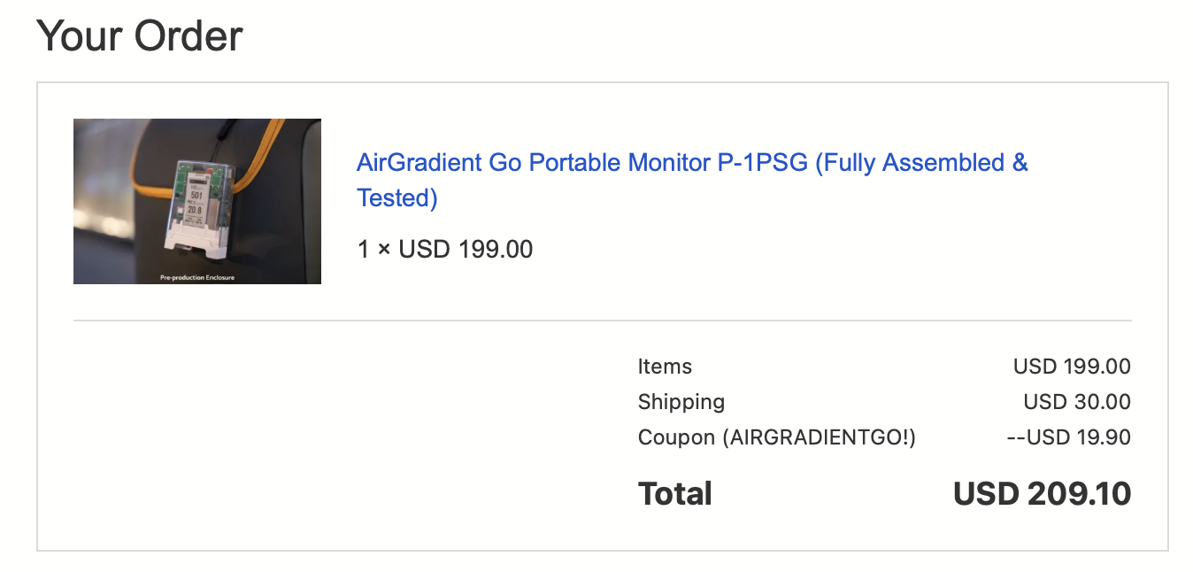

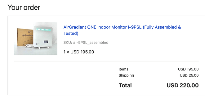

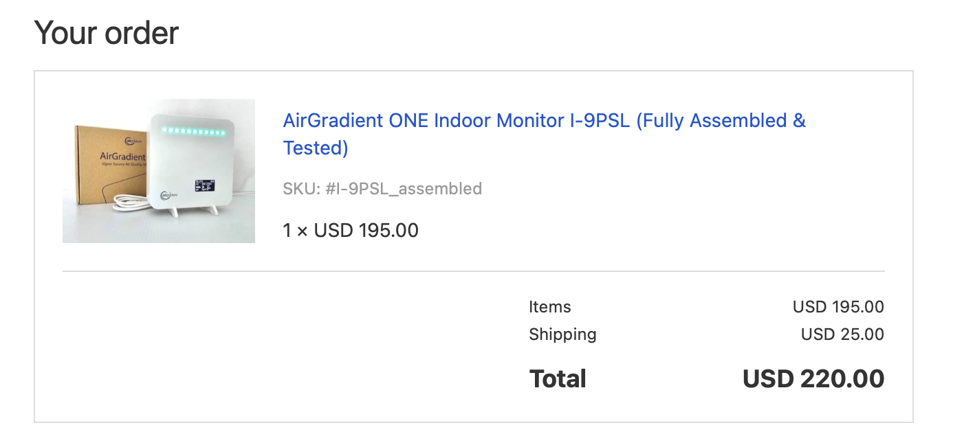

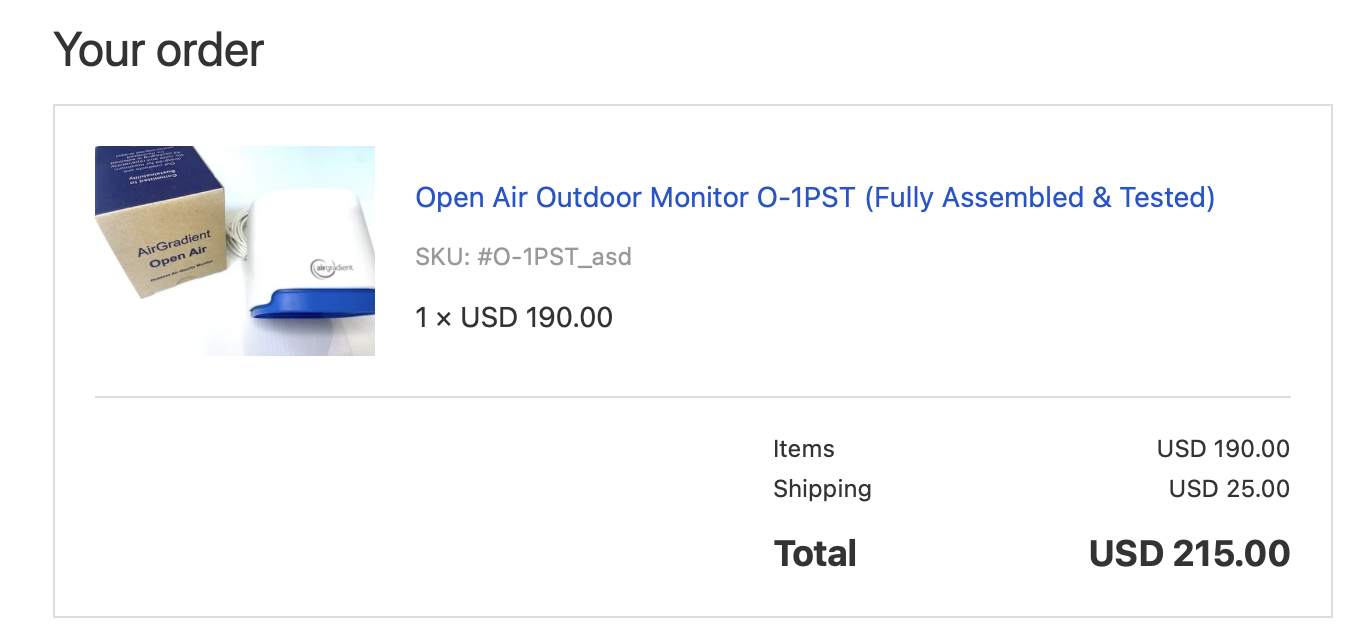

They were absolutely not DIY kits.
Thanks for clarifying, and apologies for the confusion, @MMMurphy.
I can see that your Open Air and ONE were purchased fully assembled, but looking at the pricing on your orders, they were ordered before we started offering individual factory PM calibration with our fully assembled monitors. This is why factory calibration is not available for these two units.
The batch correction factors I linked above can still be applied to improve the PM accuracy of these monitors.
