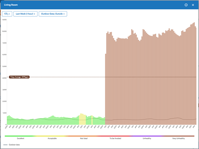

My indoor monitor CO2 readings went from ~400ppm to ~7500+ a few days ago. Any idea if this could be a failed sensor?
What is the mean-time-to-failure of the different sensor modules (asking as I previously replaced the PMS5003 module)?
Screenshot for the current readings over the last

Did you recently move or bump the sensor? That can cause the readings to change drastically.
You could take the monitor outdoors (or very close to an open window" for 5-10 minutes and then request CO2 calibration from the Dashboard and see if that gets it back to around 400 outdoors and then you can move it back where you want it
I tried this and it looks to be back working again. It was interesting to see that side-by-side with my outdoor unit the values were further apart than I would have expected.
