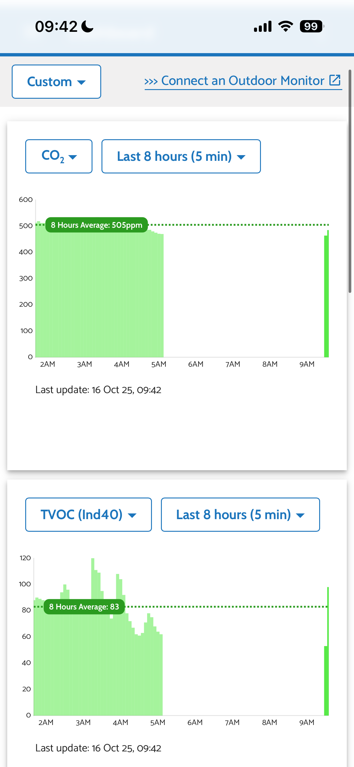

My device disconnected by itself, not sure why. It didn’t try to reconnect by itself. Was working perfectly when I saw it, it was just not reporting data to the API. I unplugged and replugged and it reconnected. Now I have a very big data loss of 5 hours.

Hi, device was on and there wasn’t any warning that it was offline. It worked normally but just wasn’t pushing to the API. I switched off the plug and back again and it was working perfectly.
