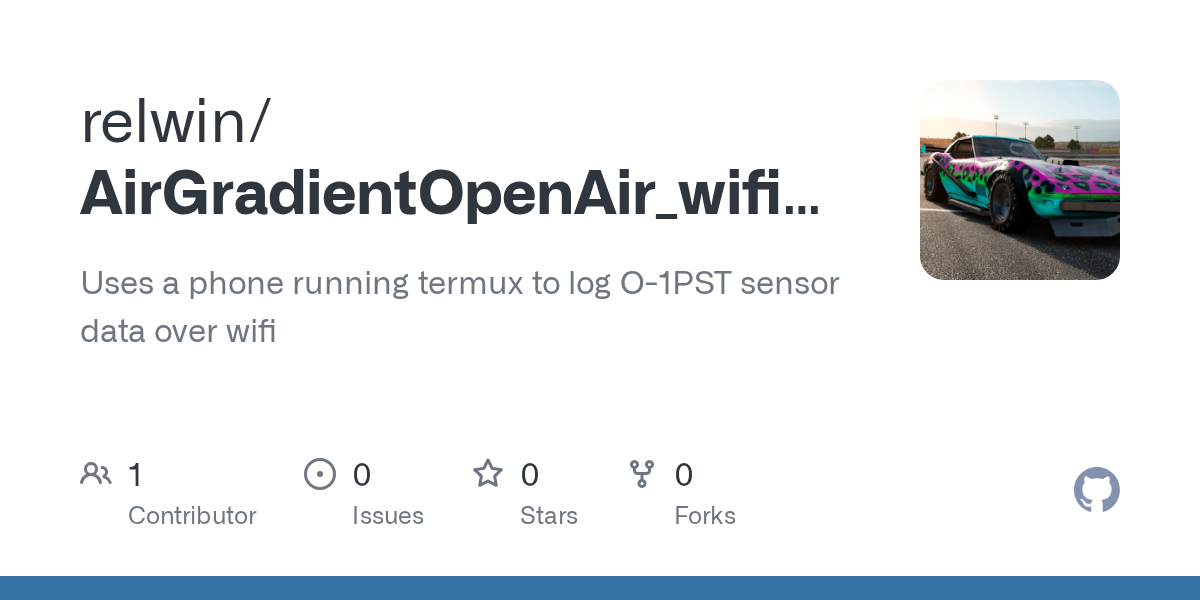

I’ve performed mobile O-1PST data logging using a small wifi router and a phone running python code under termux, and a battery. If using a phone hotspot you’ll have to find the IP assigned to the O-1PST.
Hi @relwin, could you share more about your approach to this? Is it similar to what you mentioned in Adding BT data logging to the O-1PST, and combined with a phone perform mobile data logging , but in this case, you use the Wi-Fi router instead of Bluetooth? Thanks!
This is based on AG’s example python code. It creates a CSV file with timestamps,GPS,and AG sensor data:
Thank you for sharing this! Please feel free to share your project with us and the community.
