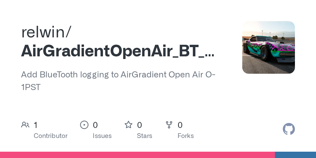

Adding BT data logging to the O-1PST, and combined with a phone perform mobile data logging
I modified the O-1PST Arduino code to allow BT data logging to a phone. Then taking the O-1PST mobile (with a small battery) I logged sensor data with phone GPS on bike rides around town. After data collection I copy and process the logfiles off the phone and examine on a PC using python visualization code.
Setup is a little klunky as I use Nordic’s nRF logger and termux to run a GPS logger. But once installed its pretty easy to use.
I’m working on a high-level video that show this in use. Or read details on github. Or buy a Go…
