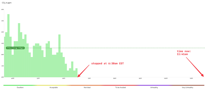

And here is the chart of the last 24 hours. See the choppiness since 9pm after the “closed window” phase.

Last 8h

In both my devices also – co2 since yesterday. Strange. Never had this before.
… comes back after rebooting
… Disappears again after a couple of hours
