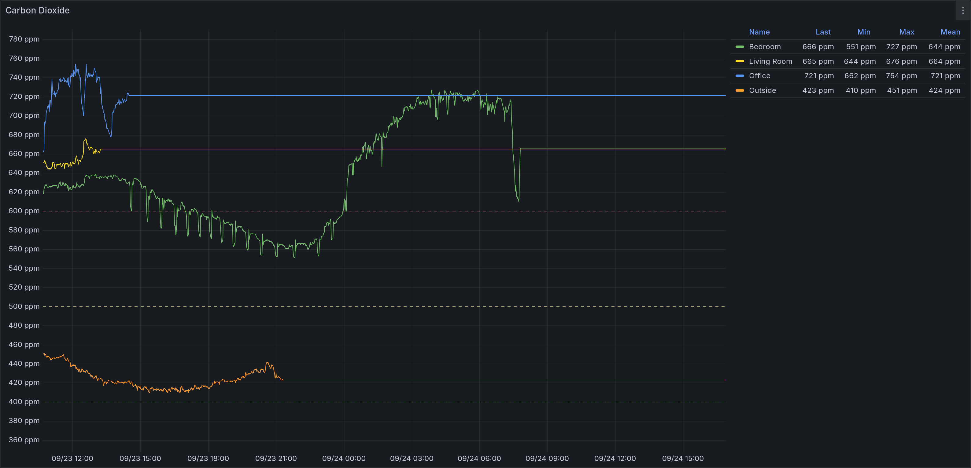

I’m sorry, but I can’t figure out how to add the WiFi strength column… And yes, all the other sensors keep reporting, and always have. This is curious, though - I recently installed an outdoor AirGradient monitor, and it looks like the CO2 readings on it drop out at the same time as the indoor monitor, which seems to indicate some kind of backend issue? First screenshot below shows good readings on the PM2.5 sensor while the CO2 sensor readings drop out. Second screenshot shows the outdoor CO2 readings dropping out simultaneously with the indoor readings.

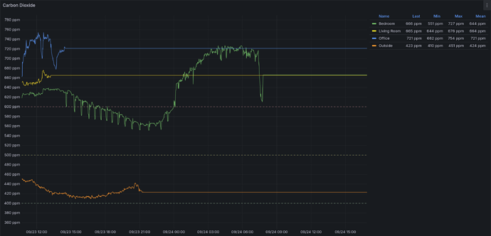

I have been having this happen on four different devices on and off. Pretty much all started around the same time, too. I’ve emailed Support but posting here for the community and posterity.
My email to support:
I own four Airgradient sensors (three indoor and one outdoor) and they worked pretty well for a long time.
In the last month or two, ALL four of them have started having problems with their CO2 sensor. The readings coming from the sensor just… stop. What on Earth is going on here?
A power cycle fixes the problem for a while but it seems to come back within a week or two. I have attached a graph showing all four sensors having the problem within a 24 hour period on firmware 3.3.8.
REDACTED is having the problem as I type this. The “rco2” value is simply missing from the JSON output of the device at /measures/current

What I failed to mention in that email is that I built and flashed 3.3.9 onto all the devices a few days ago and one of them is already having the problem again.

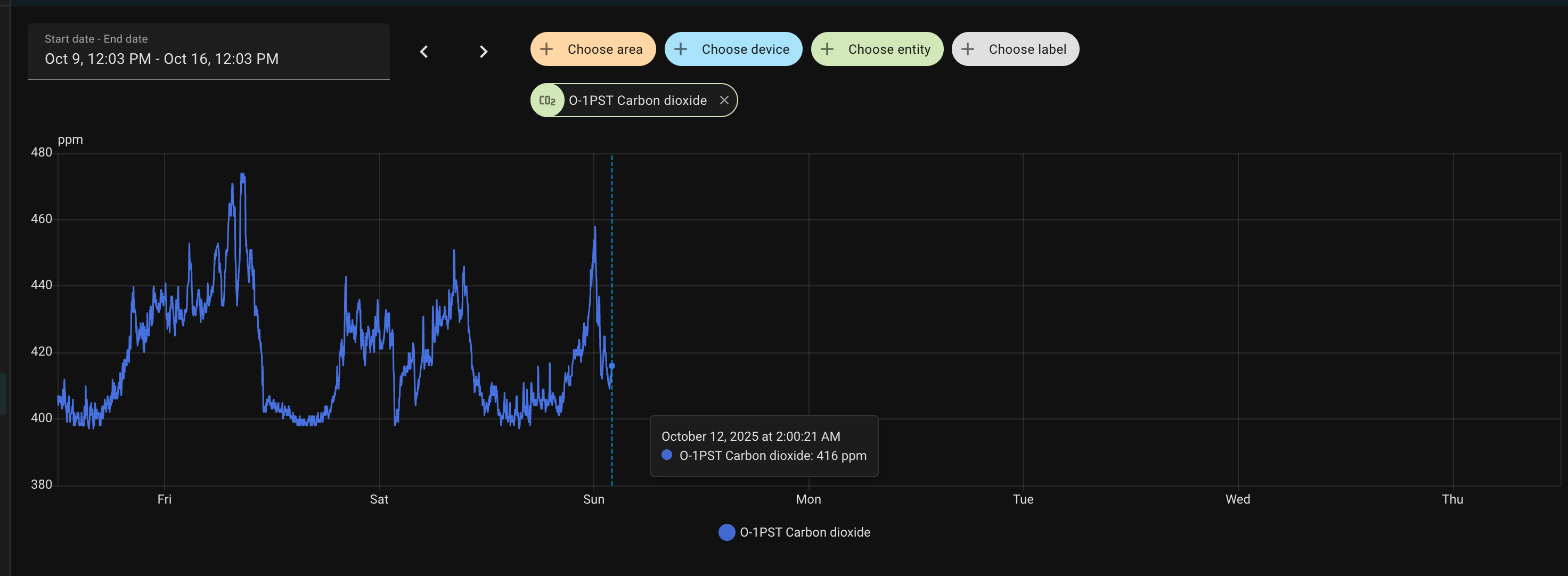

This is still happening to me. Occurring both indoors and on the O-1PST unit.
