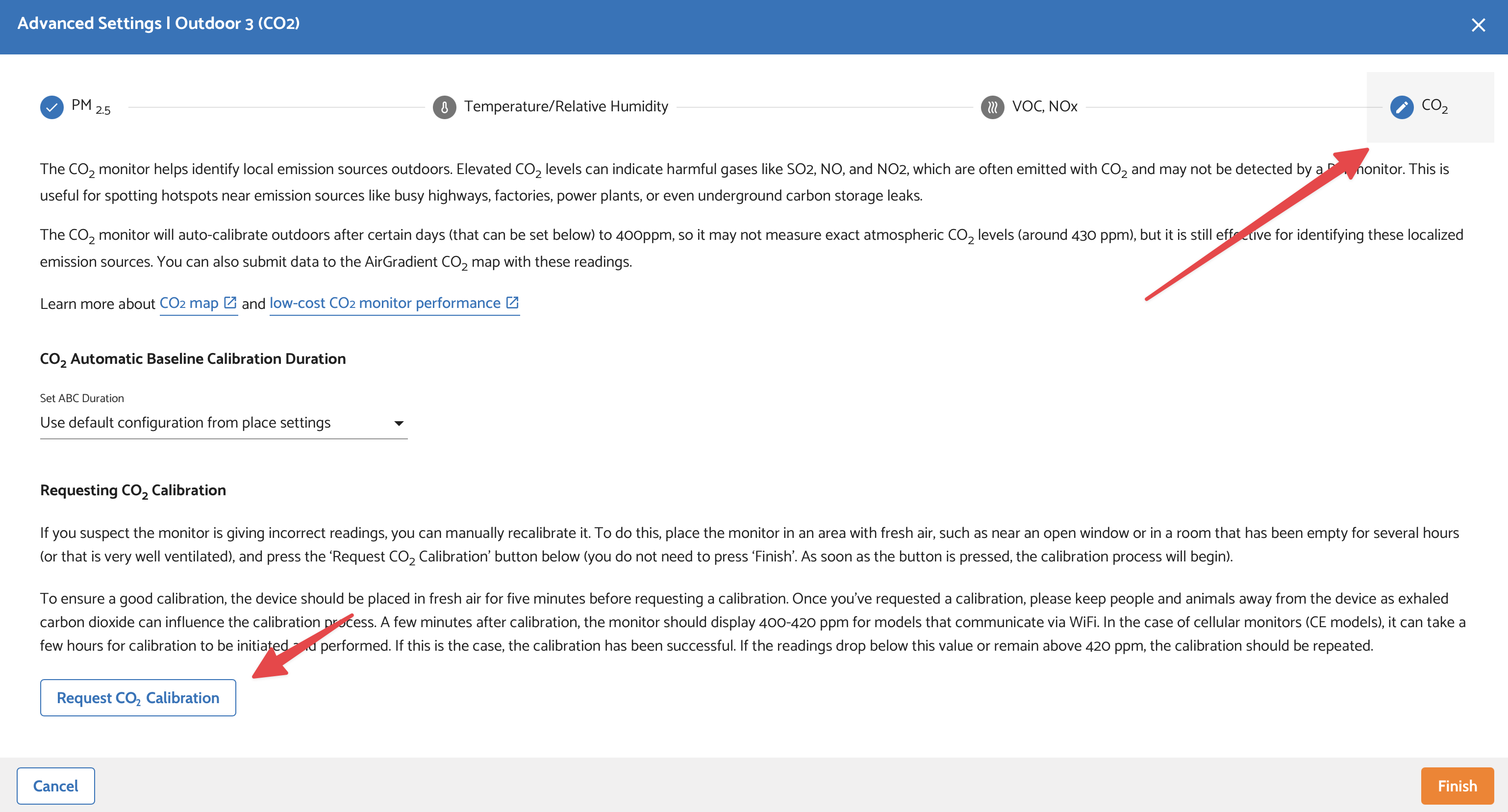

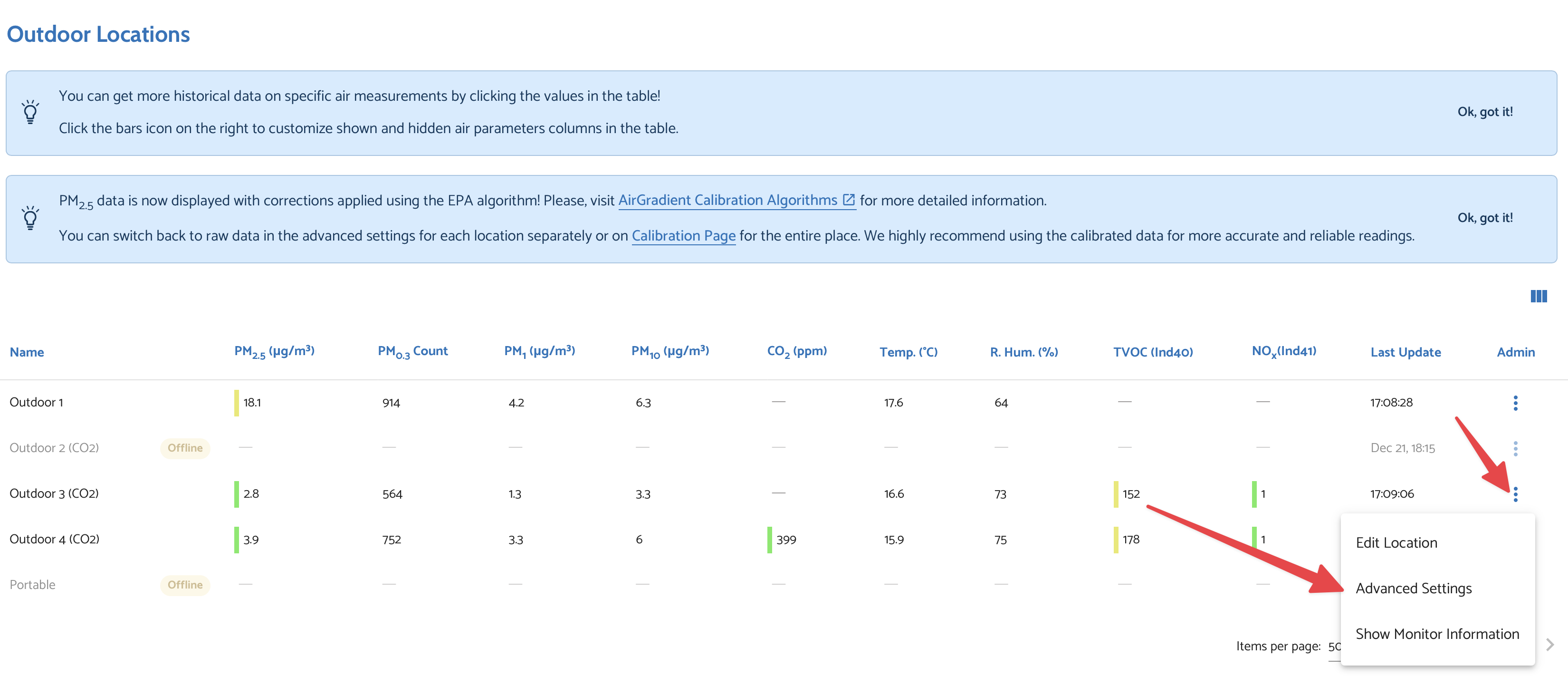

The CO2 sensor is sensitive to physical impact. Eventually it will calibrate itself again, but to speed it up you can set it outside or near a window for 5 minutes, then in the Dashboard site you can find your device and on the far right side select the three dots icon and choose Advanced Settings. The last page for CO2 has a place to request calibration. Wait around 5 minutes and you should see CO2 go to near 400. If not, request calibration again.
Hopefully that resets it and then you can move it back to your desired location.
Just to visualize what was already said, you can find the option to calibrate the sensor here:
