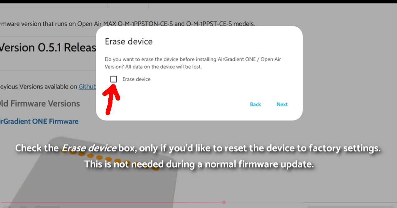

Please don’t worry as the process is quick and easy for anyone. No special tools needed.
Please follow the guide in: AirGradient ONE (I-9PSL), Open Air (O-1PST) and Open Air Max (O-M-1PPST...) Firmware Versions
If you prefer a video guide, please watch this video.
Note: You can check the ‘Erase device’ box before flashing to perform a full factory reset of the monitor.
