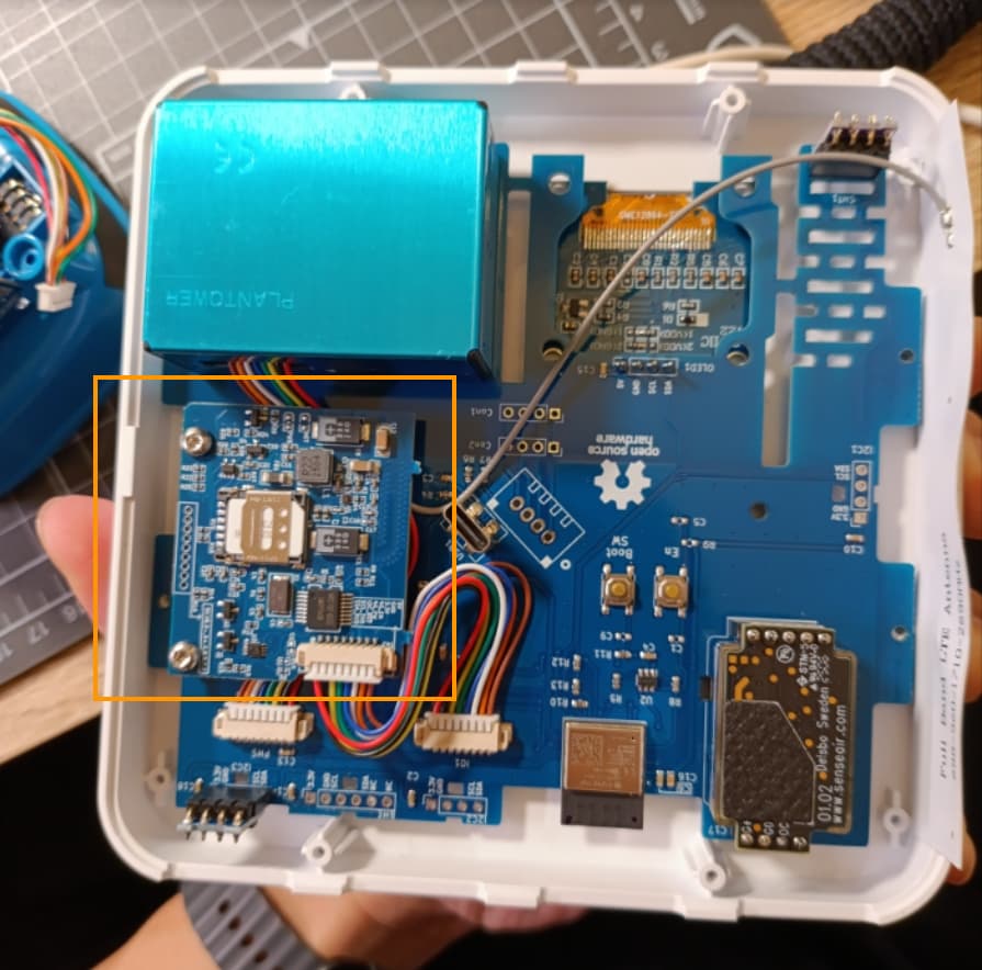

Another practical way (but requires additional hardware) is using the cellular module with your AirGradient ONE. We haven’t listed this on our shop yet, but please feel free to contact us here: https://www.airgradient.com/support . When you connect the cellular module (the module has SIM card and it connects via cellular network like your mobile phone) to your AirGradient ONE, it will be able to use the cellular internet to send the data to the AirGradient Dashboard.

Hi @mckeont! We do have a cellular model of the AirGradient ONE which comes with a cellular module and a SIM card with 5 years of data coverage included. It is generally a good option in case Wi-Fi access or storage is a concern.
Could you point me to the product description? How much of a price difference would the celluar model be?
Hi @mckeont - the cellular model is essentially the same indoor AirGradient ONE except that it has an additional cellular module with a SIM card included. The price is 350 USD per unit. We plan to add this to the online shop soon but if you’d like to order soon, you can create a support ticket: https://www.airgradient.com/shop/ - we’ll provide a quote and proceed further.
