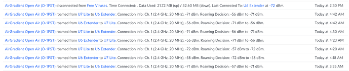

I’m also having issues with the “Lock to AP” feature of Unifi when used in conjunction with my O-1PST which was bouncing around APs.
U7 Lite is significantly closer than U6 Extender (half the distance) and this is visible in the signal shown above. While it was connected to U6 Extender, I tried to use the “Lock to AP” feature to move it to U7 Lite. This caused an outage until I removed the lock.
I will try to lock it again if I can catch it on U7 Lite.
Edit: Once locked, it seems to be working OK.
