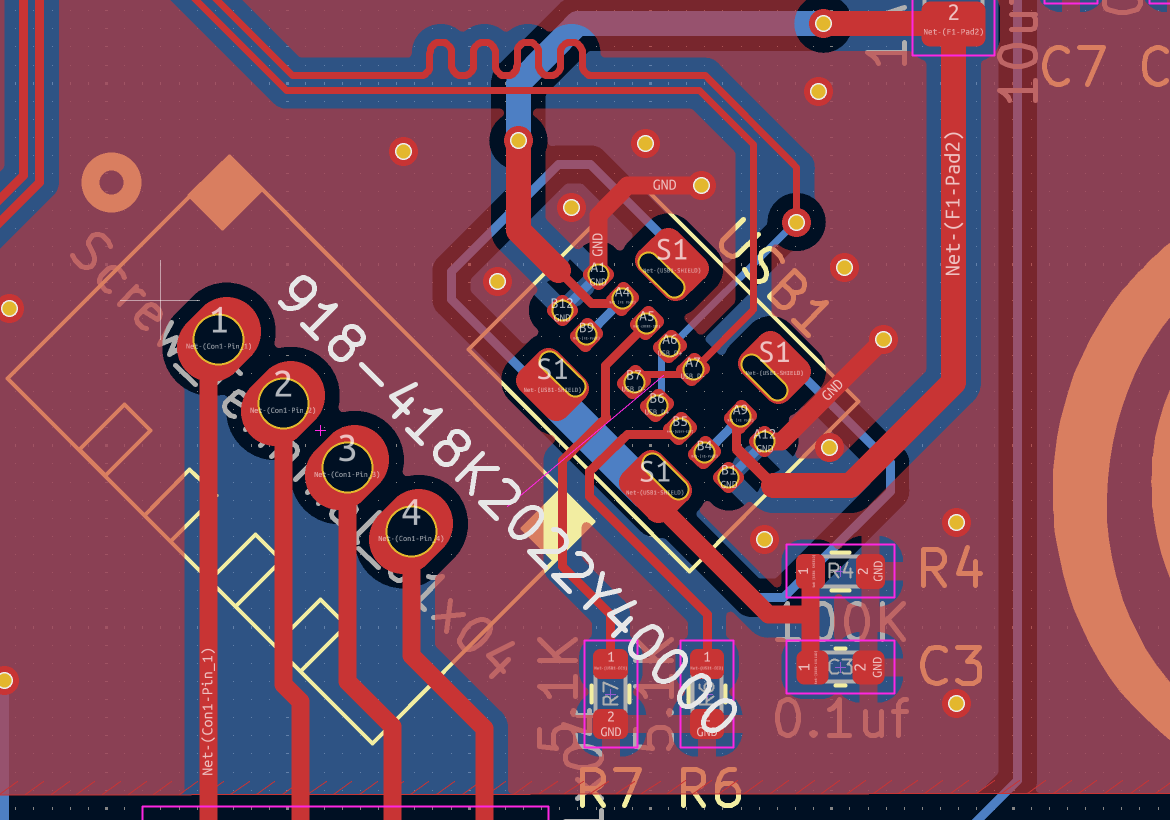

I am building an AirGradient One indoor monitor and an external monitor too.
I am having some problems finding the right USB-C connectors that fit the boards.
Could somebody please help me out with what connectors should fit?
Hi @Artanis, our engineer told me that we use this component: 918-418K2022Y40000 | Jing Extension of the Electronic Co. | Price | In Stock | LCSC Electronics on the PCB V9 and newer (indoor monitor).

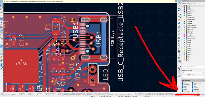

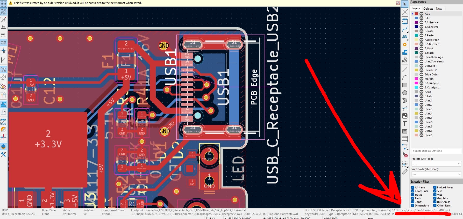

And for the outdoor (Open Air) with PCB V1.3, it seems to be this one: https://gct.co/files/drawings/usb4105.pdf as stated in the PCB file.
