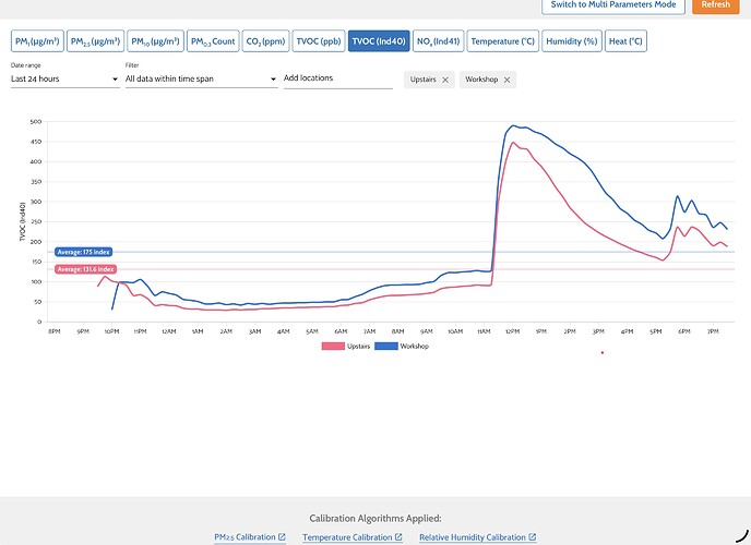

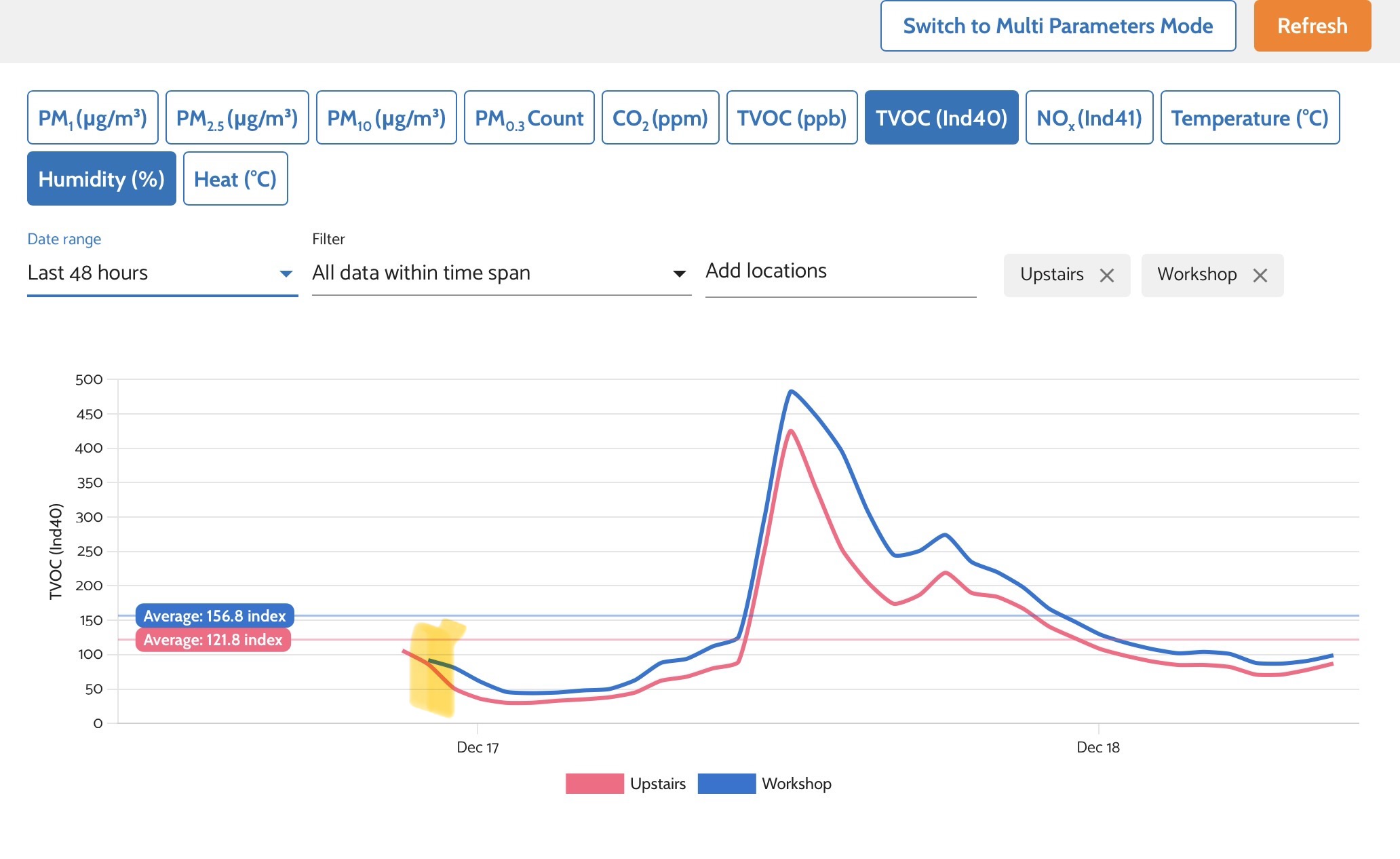

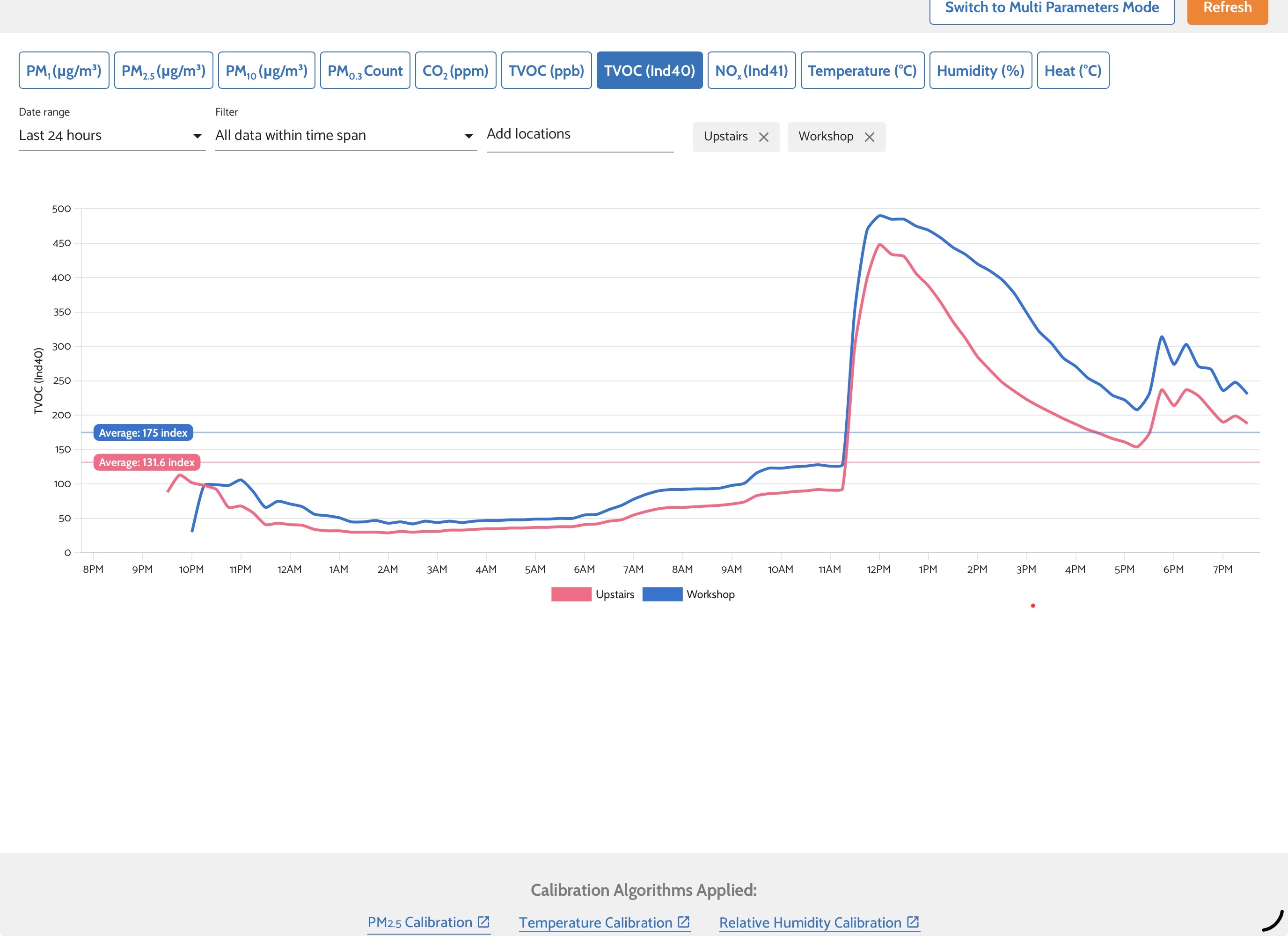

I have two devices within inches of each other. Set them up yesterday. With one exception, their readings track. But not VOC’s. Is there an explanation and possible fix for this?
Were they both powered on at the same time? The Index value is based on changes over time, so if they weren’t powered on together I would expect some drift.
I would leave them be and see in 3-4 days if they start aligning more
About 1 hour apart. Kind of late in the evening. To begin with, they were very close to each other. By the morning, they had drifted apart. And have stayed that way. I induced that big spike by burning incense. Which exaggerated the difference apparently.

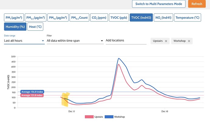

Kind of surprised to hear that about ABS. Do you have an enclosed printer? Your were right. The values have now converged.

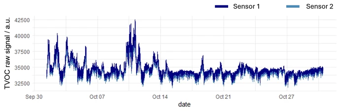

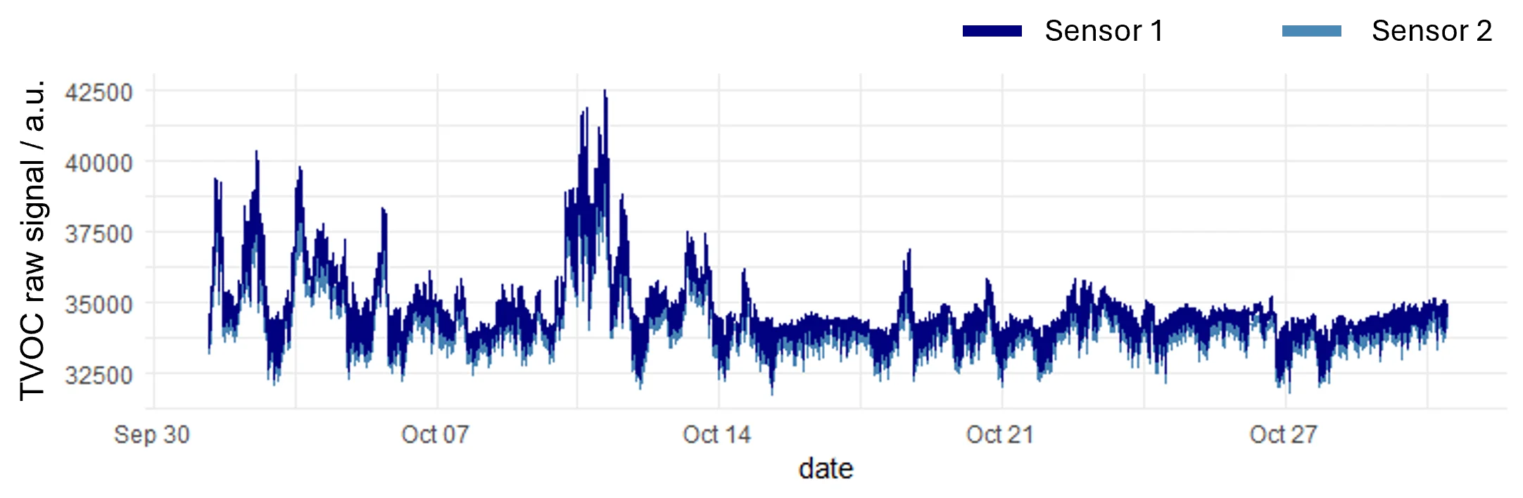

Yes. They do, however, explain the concept of “baselining” a bit which is what @MallocArray referred to. I’m actually working on a blog article which should be out before or after the holidays which goes into detail on this. I will link it here as well when it’s out!
Thanks. I will go back and re-read those to better understand baselining. Looking forward to the upcoming blog post.
