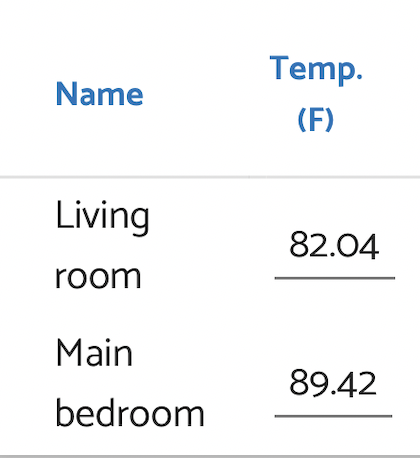

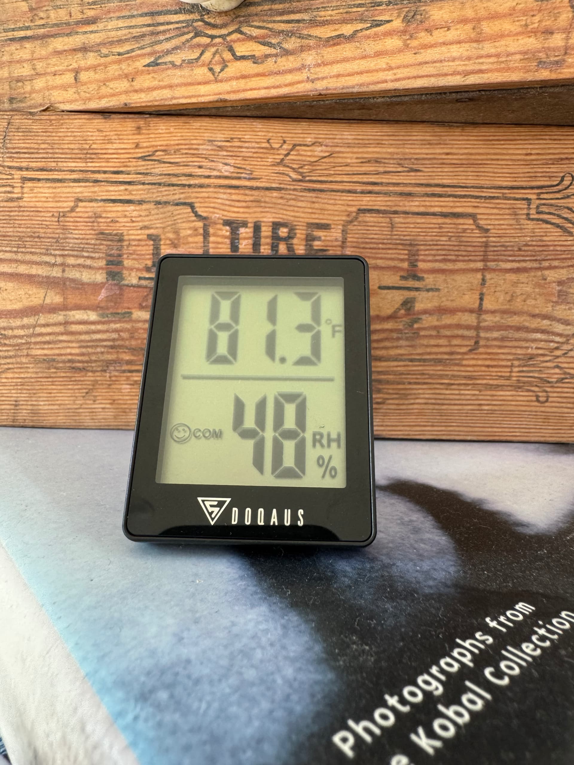

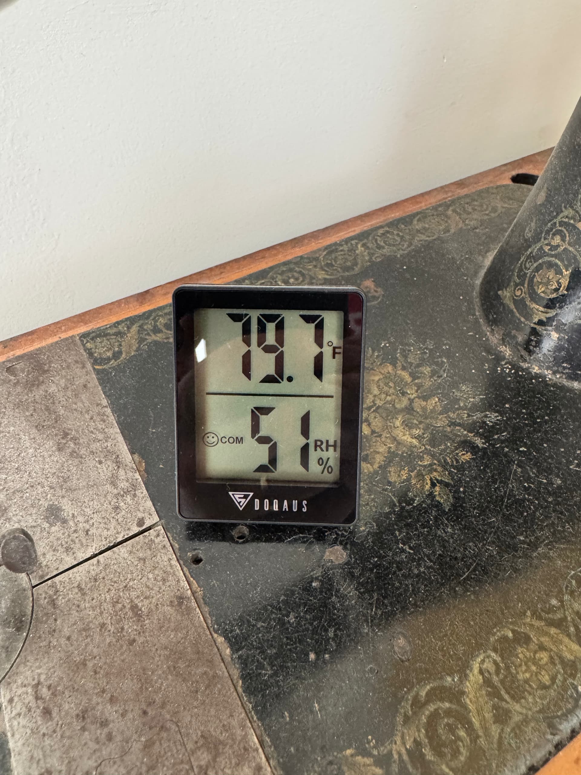

I have two indoor AirGradient ONE devices. One of them consistently records a temperature about ten degrees higher than other temperature sensors in those rooms. I have Nest Temperature Sensors and also portable sensors. In my living room: AirGradient, Nest, and Portable all agree. In my main bedroom: Nest and Portable agree, but AirGradient is 10f higher. I’ve tried turning the Temperature Calibration on and off (although my understanding this is only applied to outdoor AirGradients?) and there is no change. Is it just a faulty sensor?
Screenshot 2025-05-28 at 12.05.23 PM
Living room:
Main bedroom:
