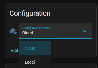

If you used HomeAssistant first, it changes the configuration source to Local, so none of the AirGradient corrections are going to be in effect even if you change it on the Dashboard site. You can try changing it in Home Assistant under Settings>Devices>AirGradient and finding your device and changing it to Cloud
Then it will start using what you have configured in the Dashboard app site. If you want the Local configuration source, there are API calls you can make to enable it on the device.

Similar to the other poster on this thread, are you using Home Assistant integration? If so, it likely set the Configuration Source to Local which doesn’t apply the correction algorithms by default.
You could try changing the Source to Cloud in Home Assistant if applicable and see what happens
Thanks for the tips. I did start with Home Assistant, but before posting I found another forum post and added them to app.airgradient and set configuration to cloud – so that’s already taken care of.

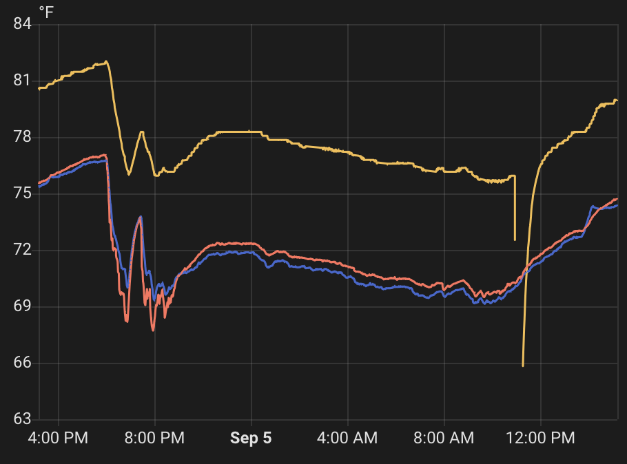

The big issue is the O-1PST’s temperature reading is about 6F too high and I can’t figure out why.
I turned off my custom adjustments so the two indoor units are set to “Raw Data” and the outdoor is set to “Standard AirGradient Open Air Calibration”. (Setting it to “Raw Data” gives the same numbers, which seems wrong…)
Here’s the three AirGradient sensors sitting next to each other:
At 11am I tried turned the O-1PST off for 15 minutes, then back on. It starts cold and heats up by about 12F.

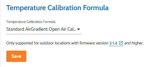

In your Settings, do you have the Temperature Calibration Formula set for the Open Air Calibration
https://app.airgradient.com/settings/place?tab=1
yes, i have it. if i switch to raw then it show even another 4C >n + direction…
