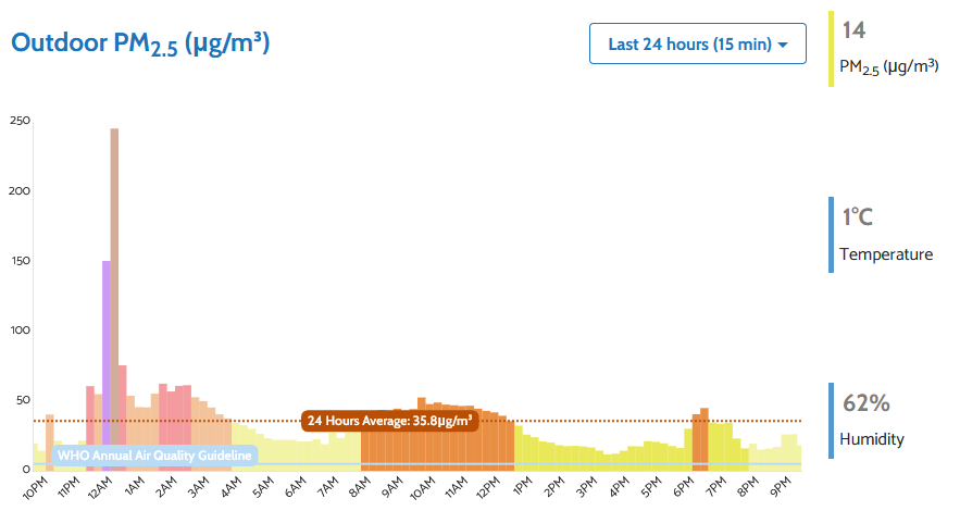

I’m experiencing similar problems from time to time. Additionally it is very strange that some of other air gradient sensors in the region (Lake of Constance) of my place (about 20 km away) also lost connection, meaning weren’t shown on map during new years eve. Just before and after all the fireworks started. Coincidence or outside influence? :face_with_monocle:
When I look at my personal dashboard, the historic data set is complete without gaps, but there are a lot during new years eve.
I suspected my router WiFi first, but it works flawlessly. I also thought about incompatible WiFi channels or interferences with these, but since my internal data set is complete, I can exclude WiFi as the source of the problem, right? By the way, are there any incompatible WiFi channels with Outdoor Air Gradient sensors?
My place:

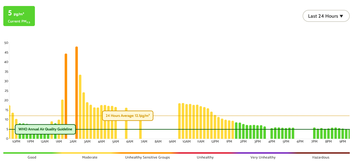

Internal data set:
PS: I hope it’s ok to bump up this old topic since the title describes my problem pretty good.

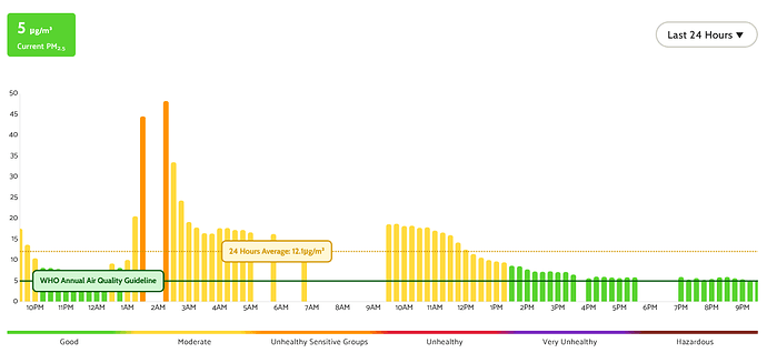

Official map data set:
