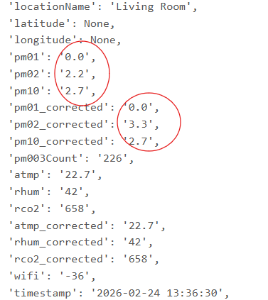

Was there a change made recently to the API payload structure? Specifically, when using the GET /measure/current call, the numeric values in the response used to return as numeric in JSON. A few days ago, due to some notifications from my application, I noticed that all values are now being returned as string.

Hi @spcherub - yes there was a recent chance to the payload structure. I believe there was another change after this change to make this non-breaking. Double quotes for floating point number are now removed:
Before:
“pm01”: “0.0”,
“pm02”: “0.0”,
“pm10”: “0.2”,
After:
“pm01”: 0.0,
“pm02”: 2.0,
“pm10”: 2.0,
