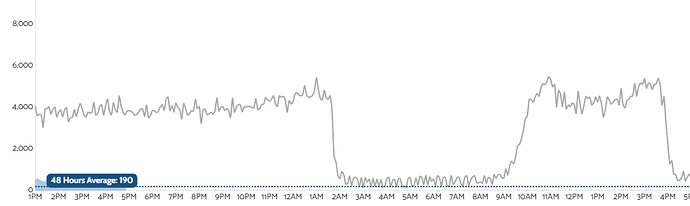

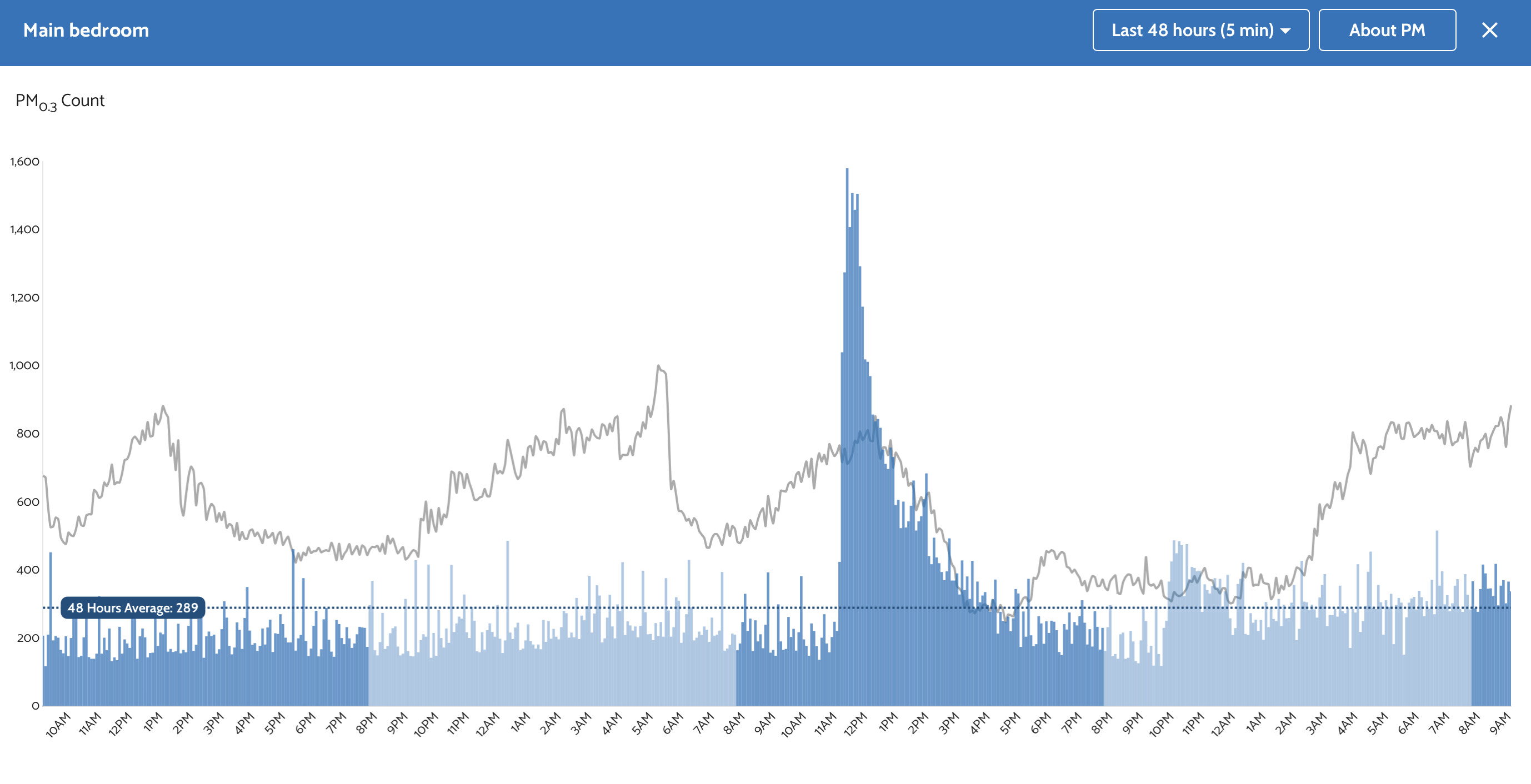

In the Dashboard, look at the graph for your 0.3 Count and see if it is also spiking. The calibrations use this value and then some math against it, so if they are jumping up, then your PM2.5 will also increase.
My last 48 hours (note difference in scales for our y-axis). The dashboard doesn’t feel particularly useful though because the sample rate is so much lower than the actual device. The graph of my PM2.5 levels for that AirGradient isn’t particularly spiky, but the actual device is just rapidly going up and down through the LEDs as shown in the video.
