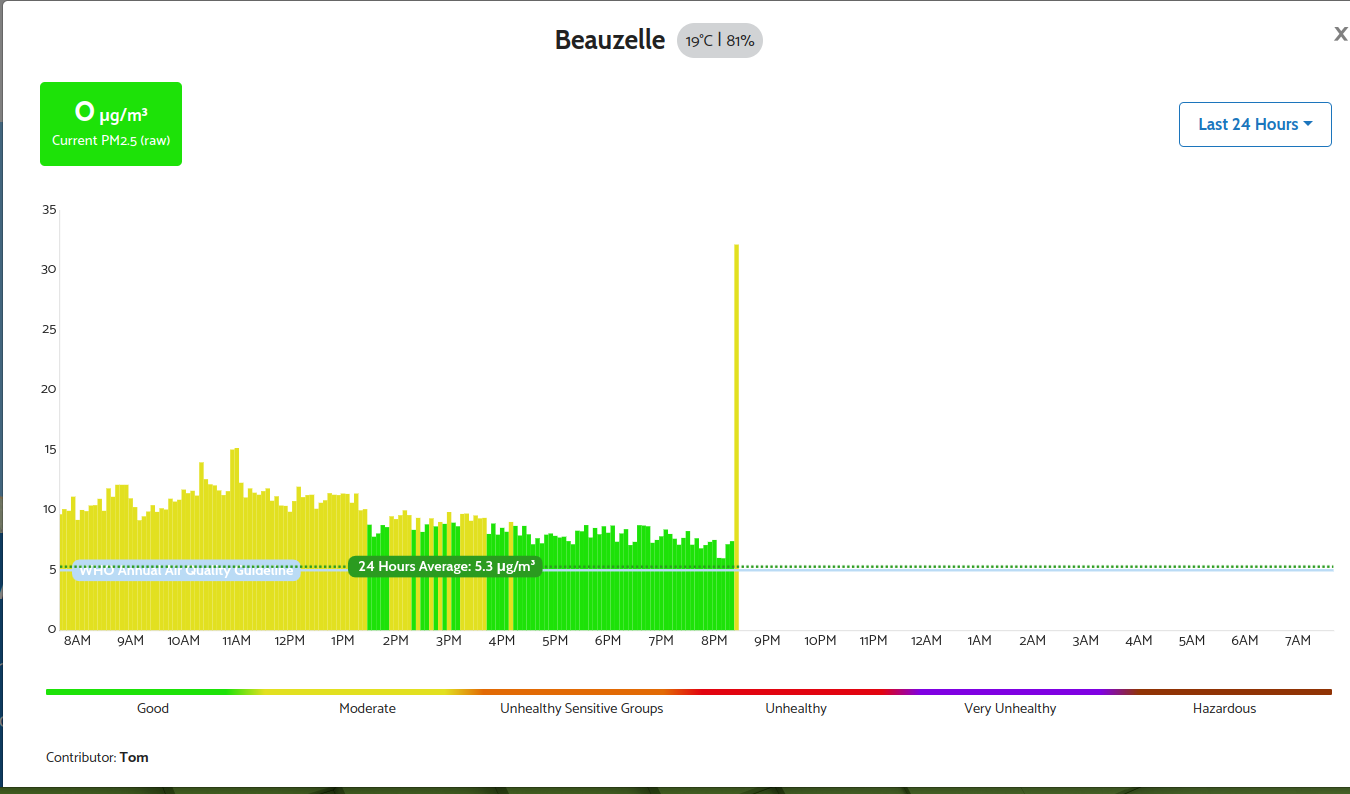

After about 3 weeks now I am not getting anymore PM 2.5 data from my outdoor sensor unit. Everything else works fine. Any ideas of what that could be ? I tried resetting etc. but to no avail…

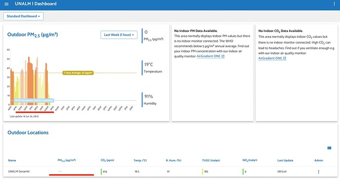

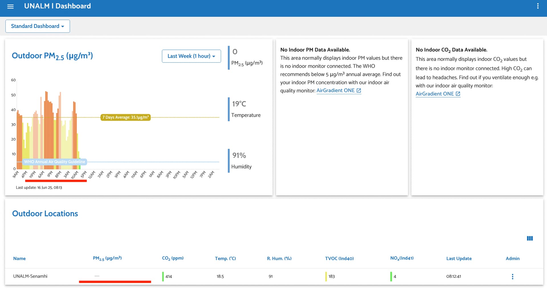

Hi, my sensor is being collocated with a reference station and after a reconnection of wi-fi it stopped registering PM, it shows that all components are measuring but PM2,5.
I was exploring in Analytics on the dashboard and it is measuring PM0.3, but not PM1, 2.5 adn 1o. I thougth it could be the measuring range since the values were very low a couple of days ago, but comparing the measures of the reference station the values were ranging 5 to 30 ug/m3, so even if the values are low, it should still be able to measure the highest concentrations.
I would appreciate some guidance and help! Thanks in advance.
I’m uploading some images:

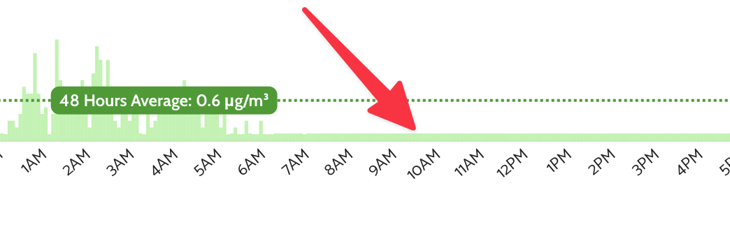

Hi,
since the 20th June, my air quality readings (PM1, PM 10, PM 2.5) have been reading 0. PM0.3 is giving something but very low readings compared to normal. Is there anything I can do to try and get this working again? Thanks for your help

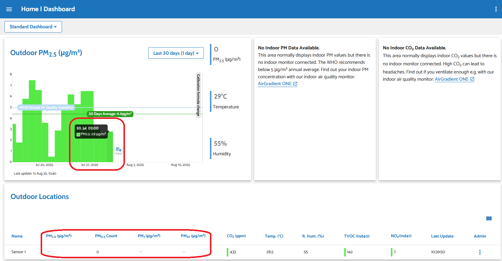

I have the same trouble with my model O-1PS. Since end of July no values are read for PM1, PM25 and PM10 (see picture),
The further measures are given. I did a soft reset by turning off/on power. Also I downgraded the firmware from 3.3.9 to 3.3…8. No changes.

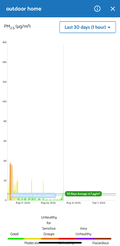

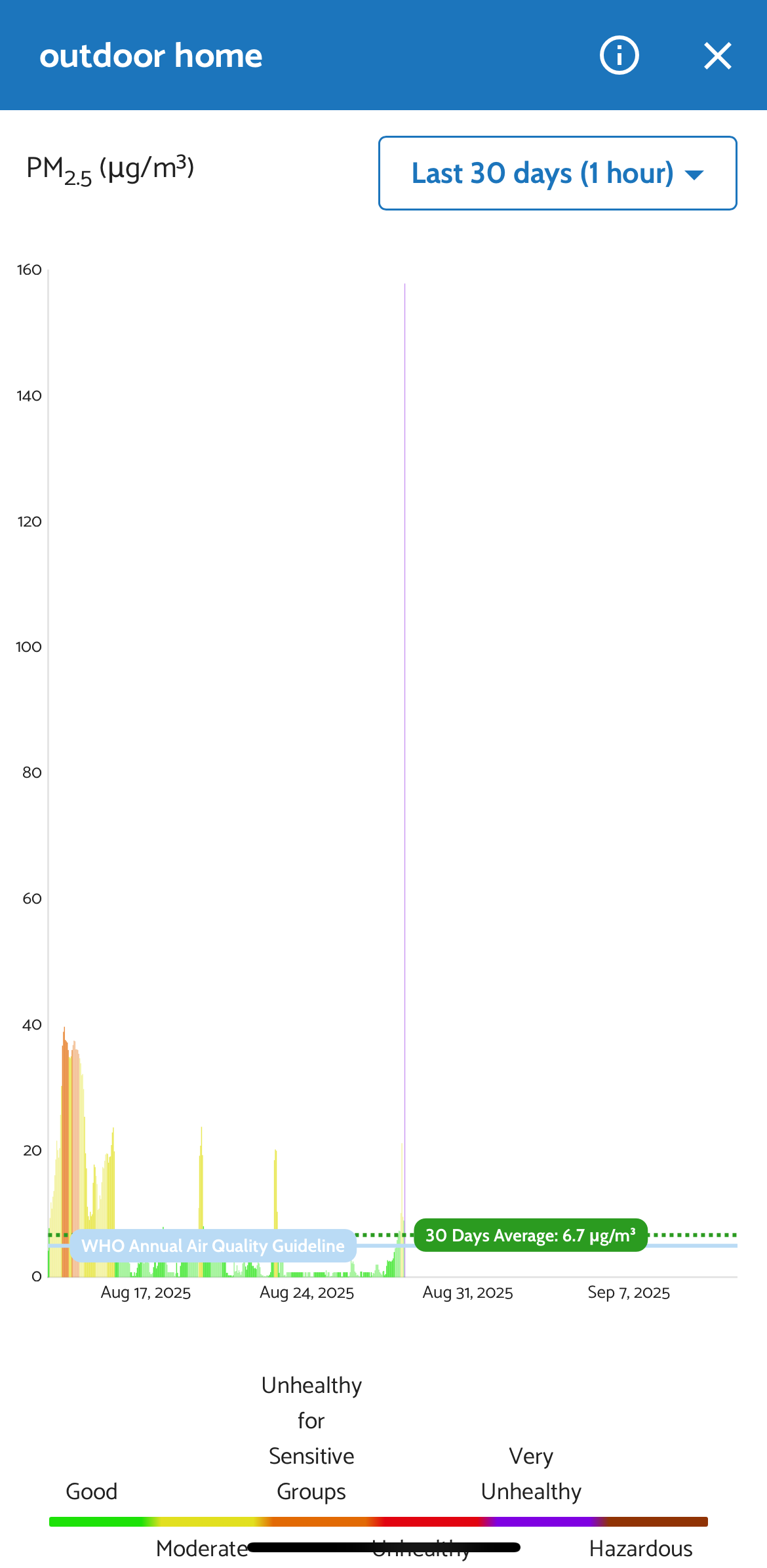

I also have this problem where the Pm2.5 sensor stopped working on my O-1PST. You can see the reading spiked and then flat lined. I tried emailing support but have not heard back. What should I do?
Hi @Bjorn! Do you have the support ticket number? I’ll get this escalated!
Yes, it’s 25799. Thanks!
Hi, how’s it going? It’s been a week and I’m hoping to get this fixed soon.
Hi @Bjorn! Sorry, I’ve been travelling for the past week and have been slightly inactive - I apologize. Let me get this sorted now.
Hi @Bjorn! Just wanted to let you know that we haven’t forgottten about this! My colleague (Yehor) who this is assigned to, has been travelling due to a necessity for the past week – but he should look into this soon. Apologies for the delay!
