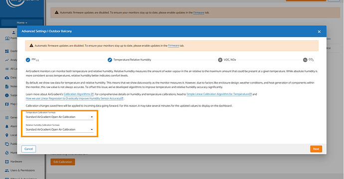

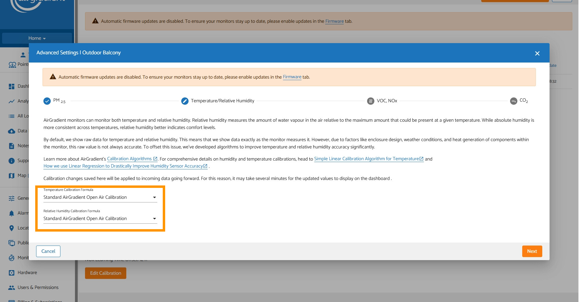

I just stumbled upon this. Do I need to do something to correct my temp and humidity? Where do I do it?
Hi @talormanda, the AirGradient Open Air correction algorithm for temperature and relative humidity should be applied automatically by default, but you can double-check on your monitor’s calibration settings. It should be ‘Standard AirGradient Open Air Calibration’.

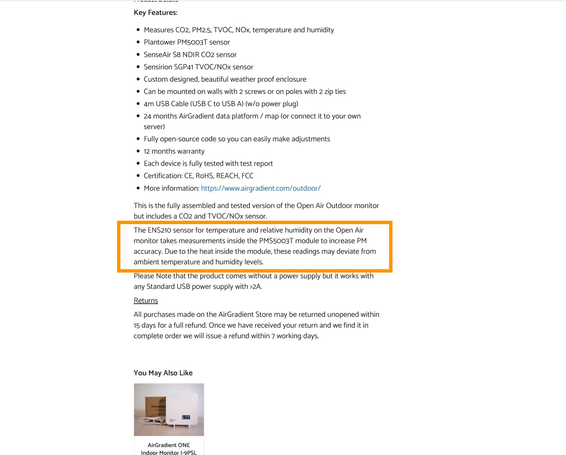

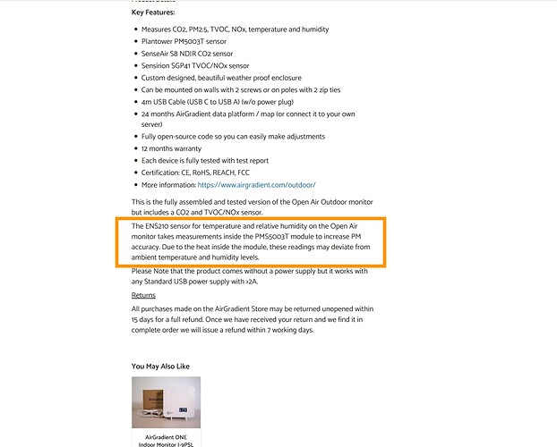

Please note that the AirGradient Open Air’s temperature and humidity sensor is integrated inside the PMS5003T module. It is primarily used for improving PM reading accuracy. Since it is located inside the PMS5003T, the reading could deviate compared to the ambient temperature.

For the Open Air, as we discussed before, we tried to keep the product simple, highly affordable, and primarily focus on PM2.5 monitoring, not as a weather station. And for that part, the Open Air has been proven to be an excellent low-cost air quality monitor. We also clearly stated on our shop page that the temperature and humidity sensor is used for PM2.5 correction, not primarily for ambient temperature and humidity monitoring.
