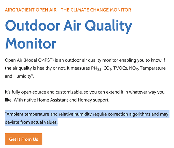

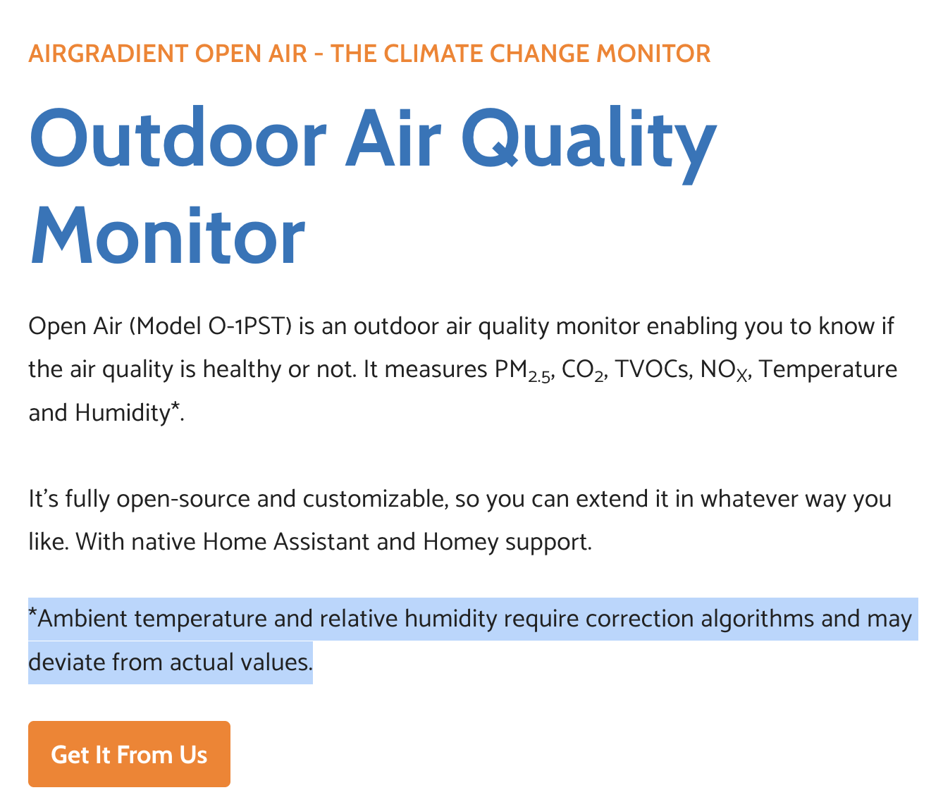

  2. We are extremely upfront on the temperature issue on our product page. Here is a screenshot that details exactly that the temperature measurements should not be takes as ambient levels:
  3. We have investigated the temperature and humidity issue indepth 2 years ago, and Anika our science lead did actually a whole webinar on it. Presentation is here: https://www.airgradient.com/documents/webinars/AirGradient_Webinar_Temperature_and_RH_Correction_MAR2024.pdf. So we take this issue very seriously.
  4. There are a lot of factors impacting the temperature and humidity, external factors like sun exposure, wind, but also possibly firmware updates. And the enclosure design of the units probably poses most limitations. I think we can consider an external probe for a future update of the Open Air which might be best solution but would make installation slightly more complex and some people might not like the looks?
