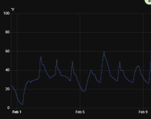

It has been consistently below freezing where I live, and our outdoor unit has not registered much below freezing at all. Is there a time frame when the temperature correction algorithm might be implemented or anything I can do to help with the data collection? I also have an indoor unit I can take outside.
I discussed it with our science team and we would like to have something in the next two weeks.
To understand your data better, can you please let me know if your AirGradient permanently in the shadow?
I’m getting about 10 F higher on my OpenAir compared to weather.com for my area. Unit is in the shadow under a deck awning.
Mostly yes. It’s on the first floor, and there’s a balcony above, with little light in the backyard.
