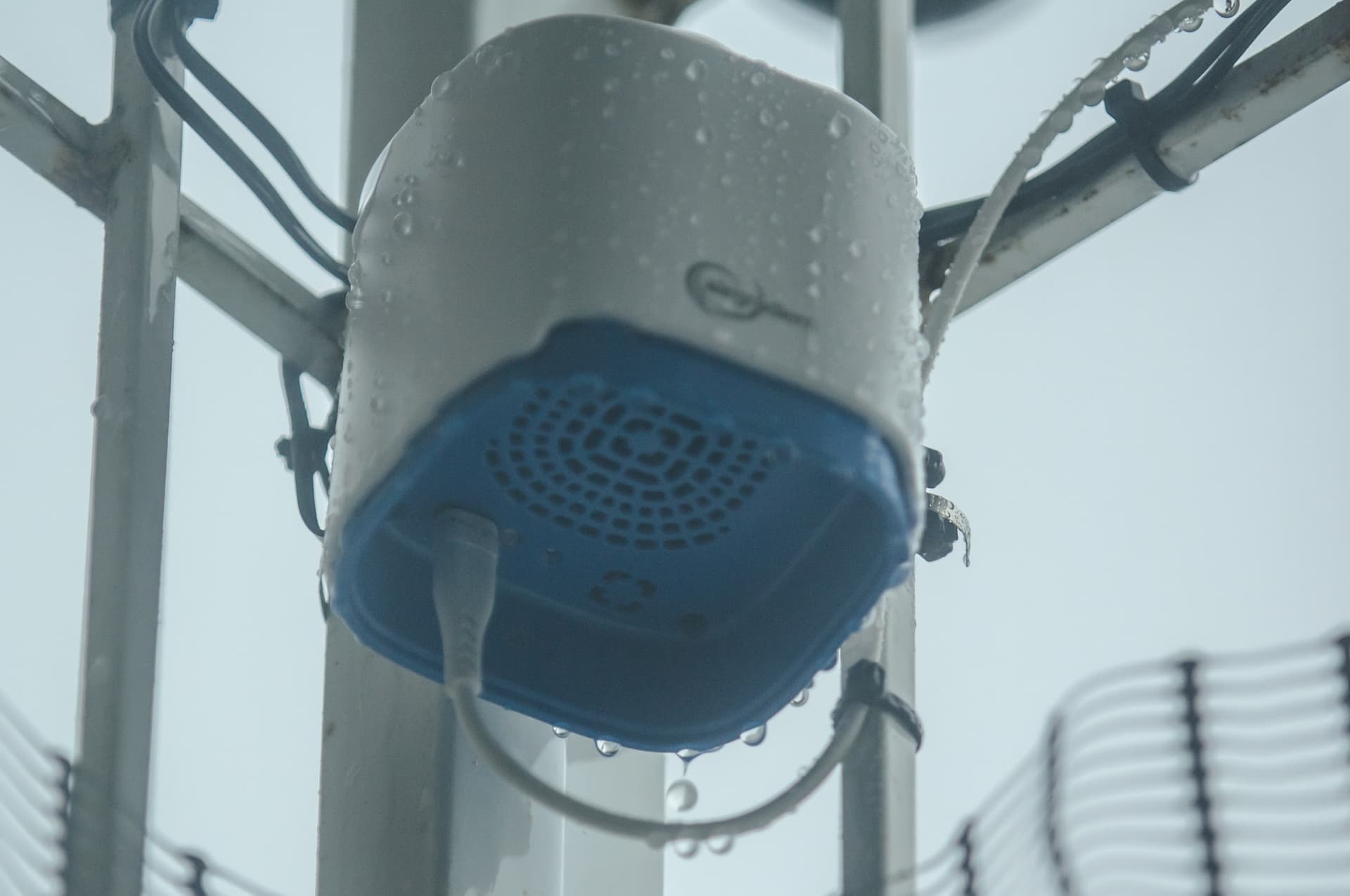

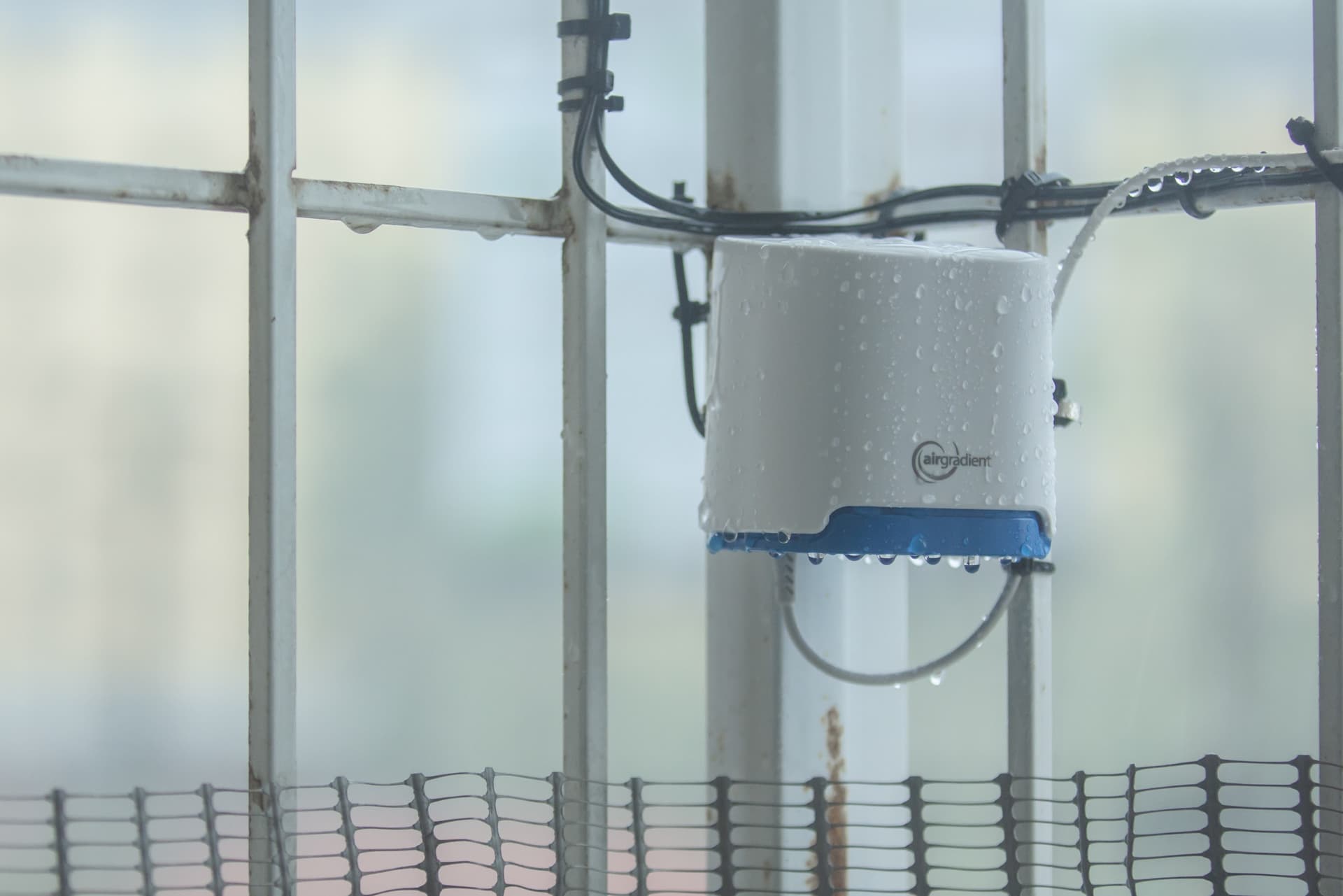

From my own experience, I installed my Open Air in my semi-shaded balcony (it is directly exposed to the sun at times of the day as I have no better place to mount it), and when there was a windy rain storm, it survived every time.
Here’s what mine looks like:
To add to this, mine has also survived a few snow storms in Kashmir.
To add from my side, I think I haven’t heard of any device broken through water ingress (assuming it was installed correctly).
Correction: There was one installed on a boat for an Antartic mission…
