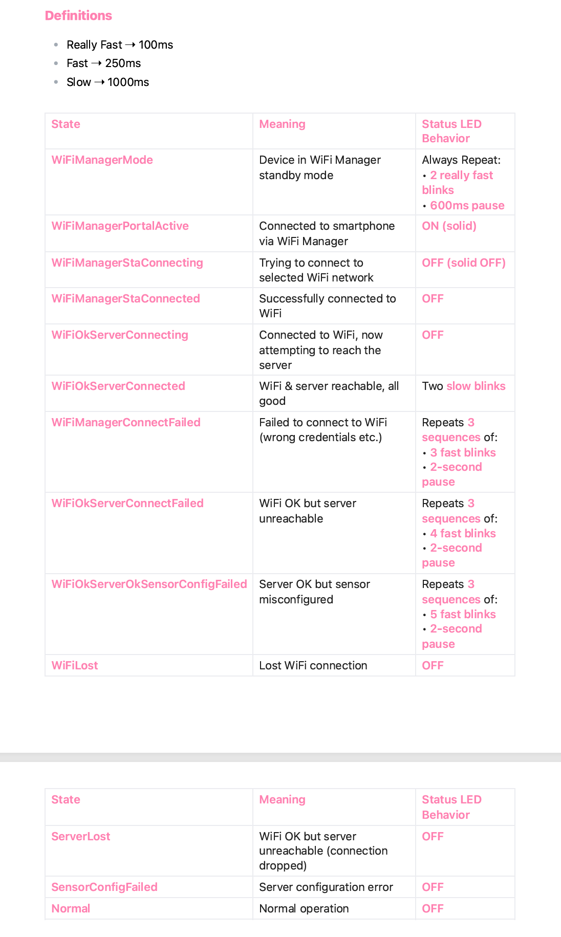

O-1PST – 4-4-4 / 5-5-5 blue LED pattern after clean flash + all basics ruled out
O-1PST DIY kit (new)
  • All wiring confirmed correct (PM1 = PM sensor, PM2 = CO2 sensor, both fully seated)
  • Using the exact same power adapter + cable that works perfectly on my indoor AirGradient
  • WiFi signal strong at the location (same spot where indoor unit works fine)
  • Indoor unit on same 2.4 GHz network works perfectly
  • After multiple full erase + flash + re-setup: blue LED does exactly 4 blinks ×3, then 5 blinks ×3, then completely off
  • Faint internal CO2 LED is blinking (board + CO2 sensor alive)
  • App shows “seen once” with new timestamp each power cycle
  • Pattern repeats identically every time
All common causes (power, wiring, signal, network) ruled out. Any ideas??
Hi @Mbetters, welcome to our community.
Would you mind collecting some logs from the monitor using this tool?: Online Debug | AirGradient Knowledge Base
I’ll help you find out what might cause the issue.
Anyway, in case it’s helpful, this is what each LED indicator means on the Open Air running on firmware 3.6.x or newer.
https://www.airgradient.com/documentation/kb/airgradient-open-air-indicator

Hi @Mbetters, sorry for my late reply.
[AgWifiClient] Error: Failed post measures to server with response code 400
[AgWifiClient] Error: Failed fetch configuration from server with return code 400
These 2 lines are our primary focus here, which reflects the LED status that you mentioned earlier. It means the O-1PST couldn’t get configuration from the server, nor could it post the data to the server.
I have checked your Dashboard and found that the input serial number of the O-1PST didn’t match the log above (the old serial number was the serial number of the PM2.5 module (PMS5003T), not the O-1PST itself). I’ve edited it to match your log already. Could you please take a look at your dashboard to see if the O-1PST is online now?
