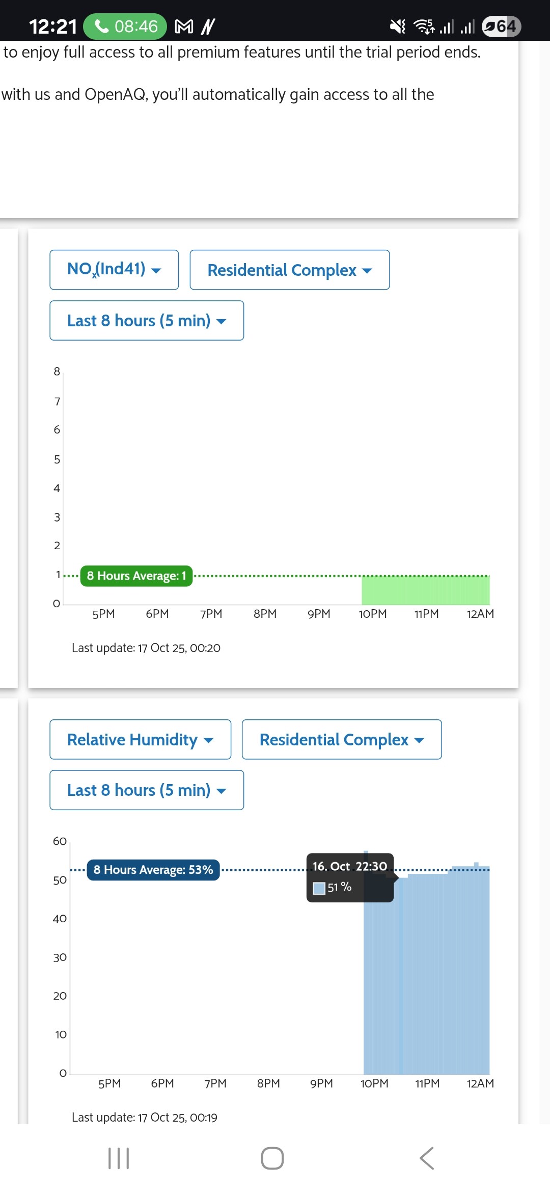

I’ve deployed my sensor today and while there’s data visible for all the components such as PM, Temperature, Humidity, etc. The NOx values have been captured as a stagnant 1 throughout. What could be the reason behind it?
That is the expected result. The value is an index that monitors how it changes. 1 is the lowest value. If it started going up, the. You have an increase in NOx exposure.
