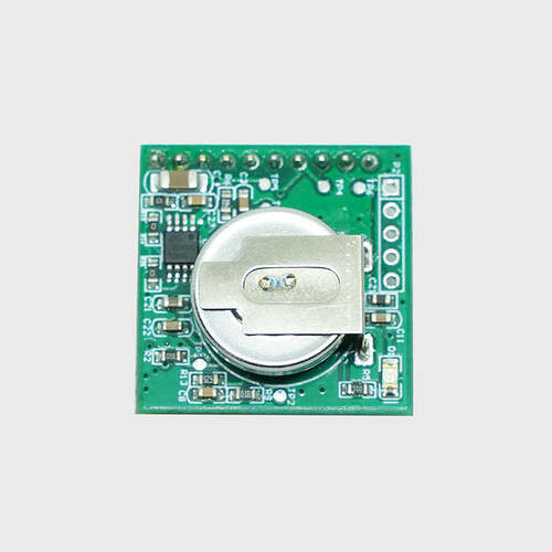

@Tai_AirGradient is this a decent sensor to try and integrate? Has your team found a candidate that you like?
Hi @Mike_14.7, thank you for pointing this out.
For the sensor component, let me ask our engineer first and I’ll let you know.

Hey folks! I’m sorry for my delayed reply. I have asked our engineering team. They are currently working on testing a CO sensor against a reference instrument. We will let you know when we have more progress on this. Thanks!
