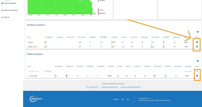

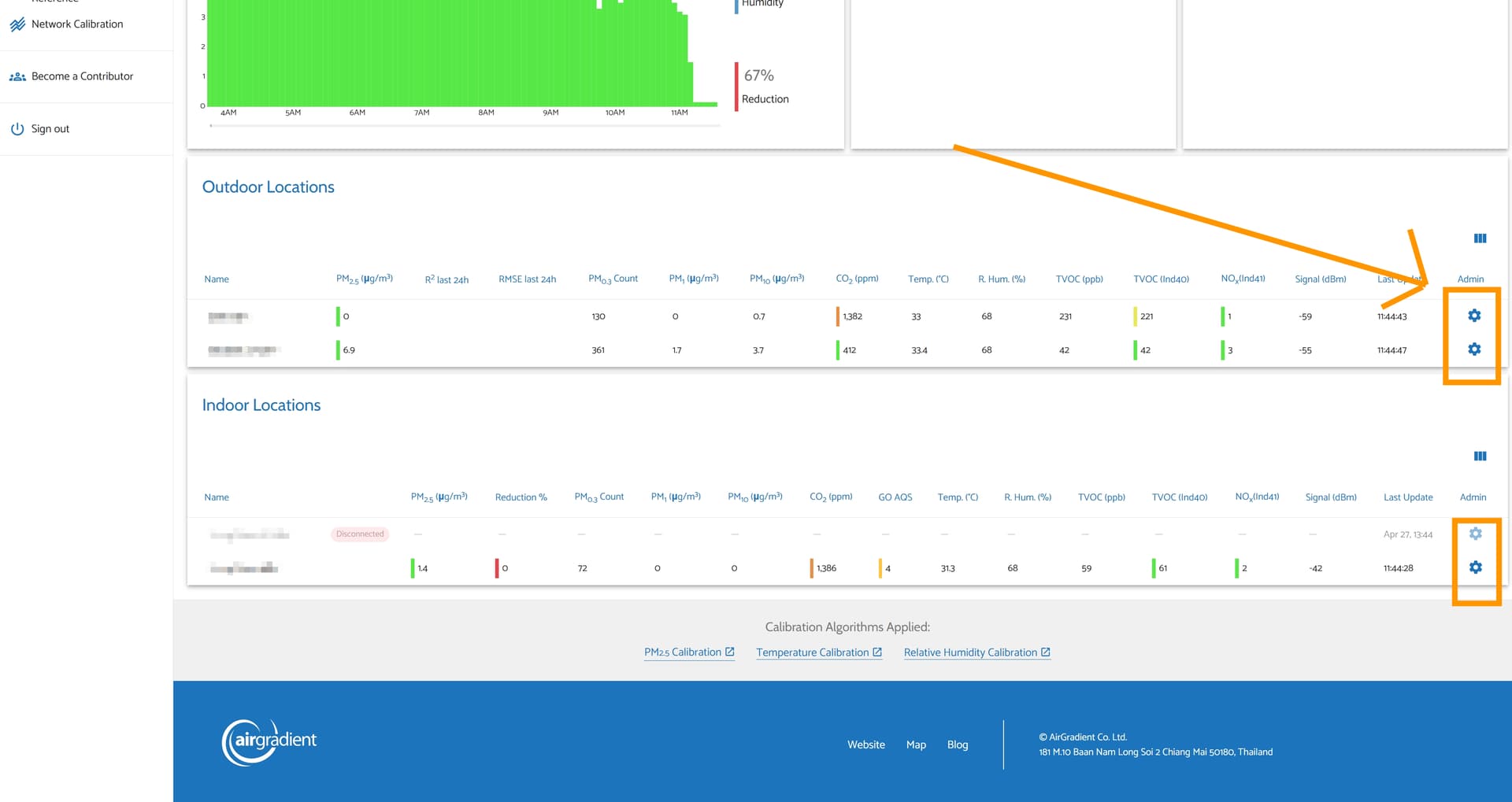

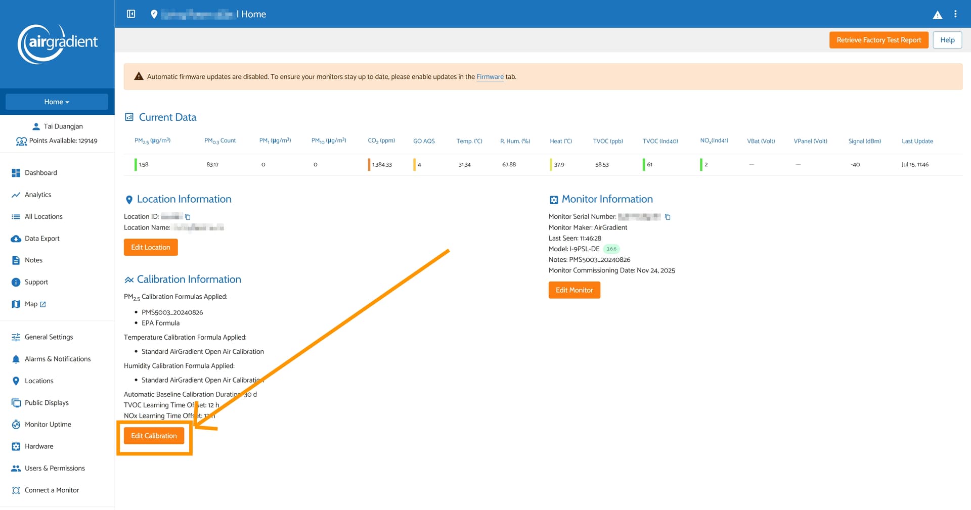

More on how to open the calibration menu: open up your AirGradient Dashboard in a web browser > Tap the gear button at the far right of your monitor you want to calibrate > Tap ‘Edit Calibration’ > Go to ‘CO2’ tab > Tap the ‘Request CO2 Calibration’ button (make sure your AirGradient ONE is already outside, exposing to fresh air) > Tap Finish.

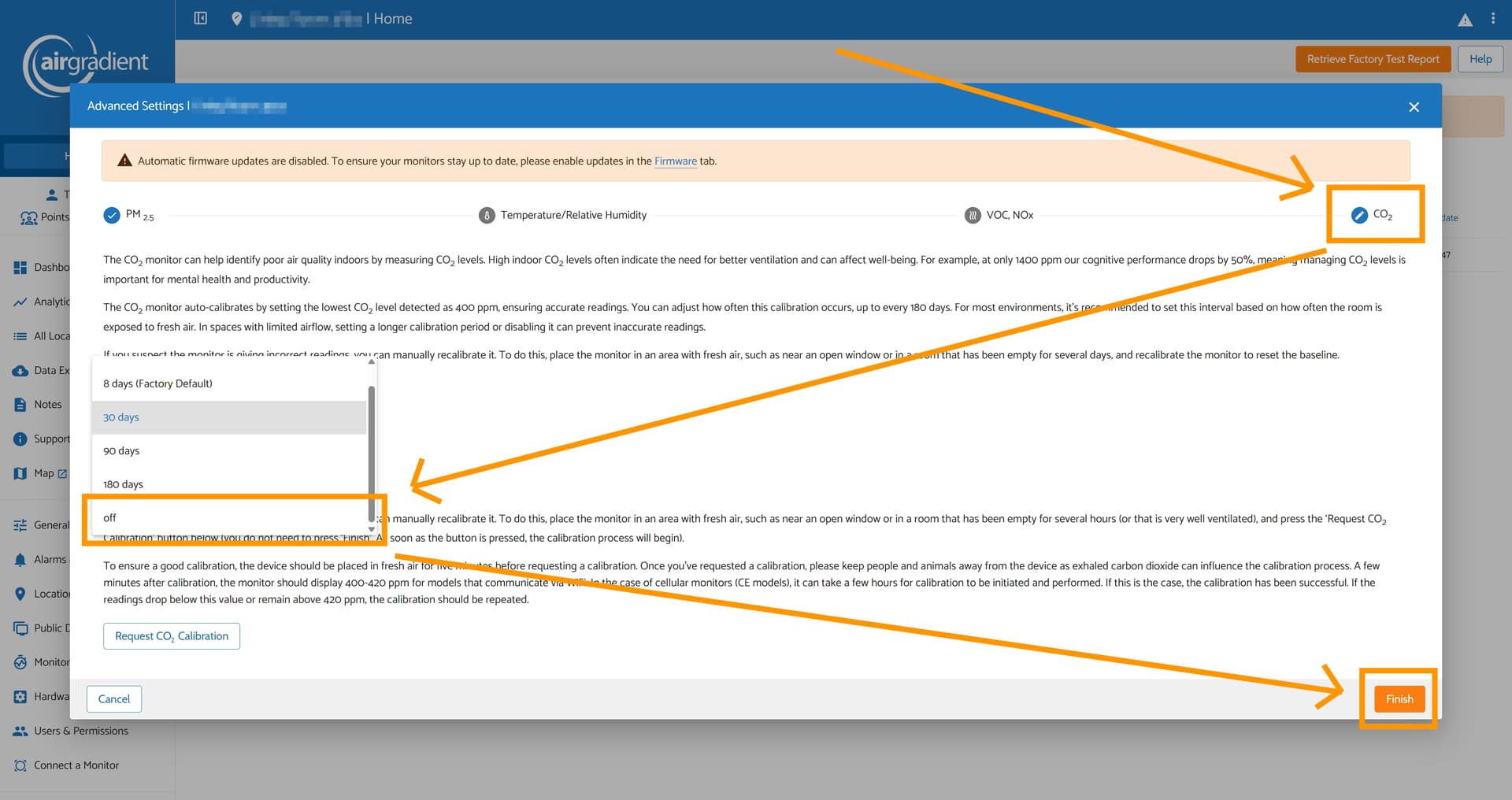

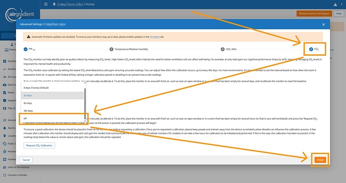

My normal indoor CO2 is very high: about 1250. I took the unit outside and calibrated, but it was already close to 400. I could not find a way to disable ABC so I set it to the longest interval.
Hi @Steve_Conley, to disable ABC (Automatic Baseline Correction) via the AirGradient Dashboard, you can achieve that by going to your AirGradient Dashboard, and tapping the gear icon at the right of your specific air monitor on the list. Then tap ‘Edit Calibration’ > Tap the ‘CO2’ tab > Set ABC duration to ‘off’ (you might need to scroll down a little bit on the dropdown menu of the ABC duration) > Tap ‘Finish’. Now the ABC is disabled.
Please feel free to let us know if you have any questions. Thanks!
Thanks. I did not see it at the bottom before. That worked.
