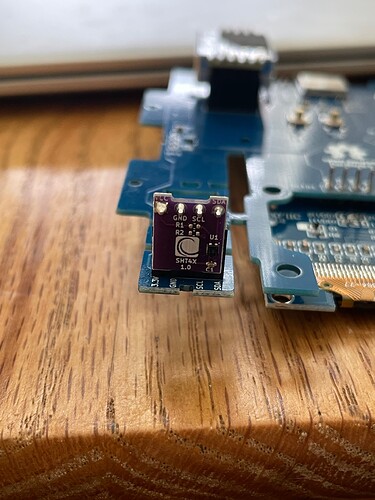

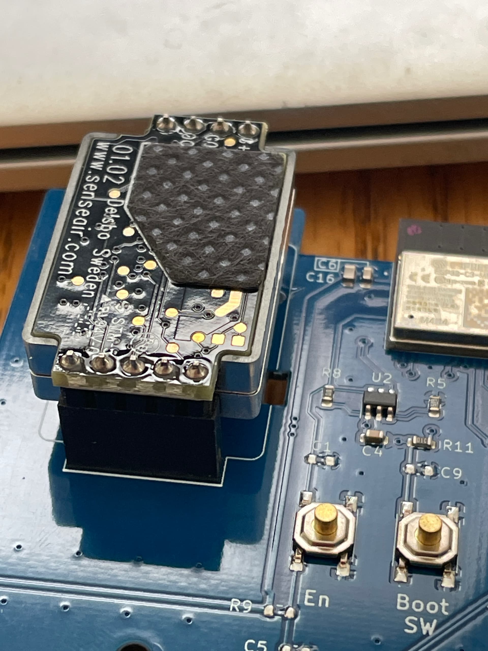

Thanks for replying. I checked the postions and the orientation for those modules and they are correct. Purple temp/humidity in the lower right and TVOC/NOx in the upper right, both facing me.

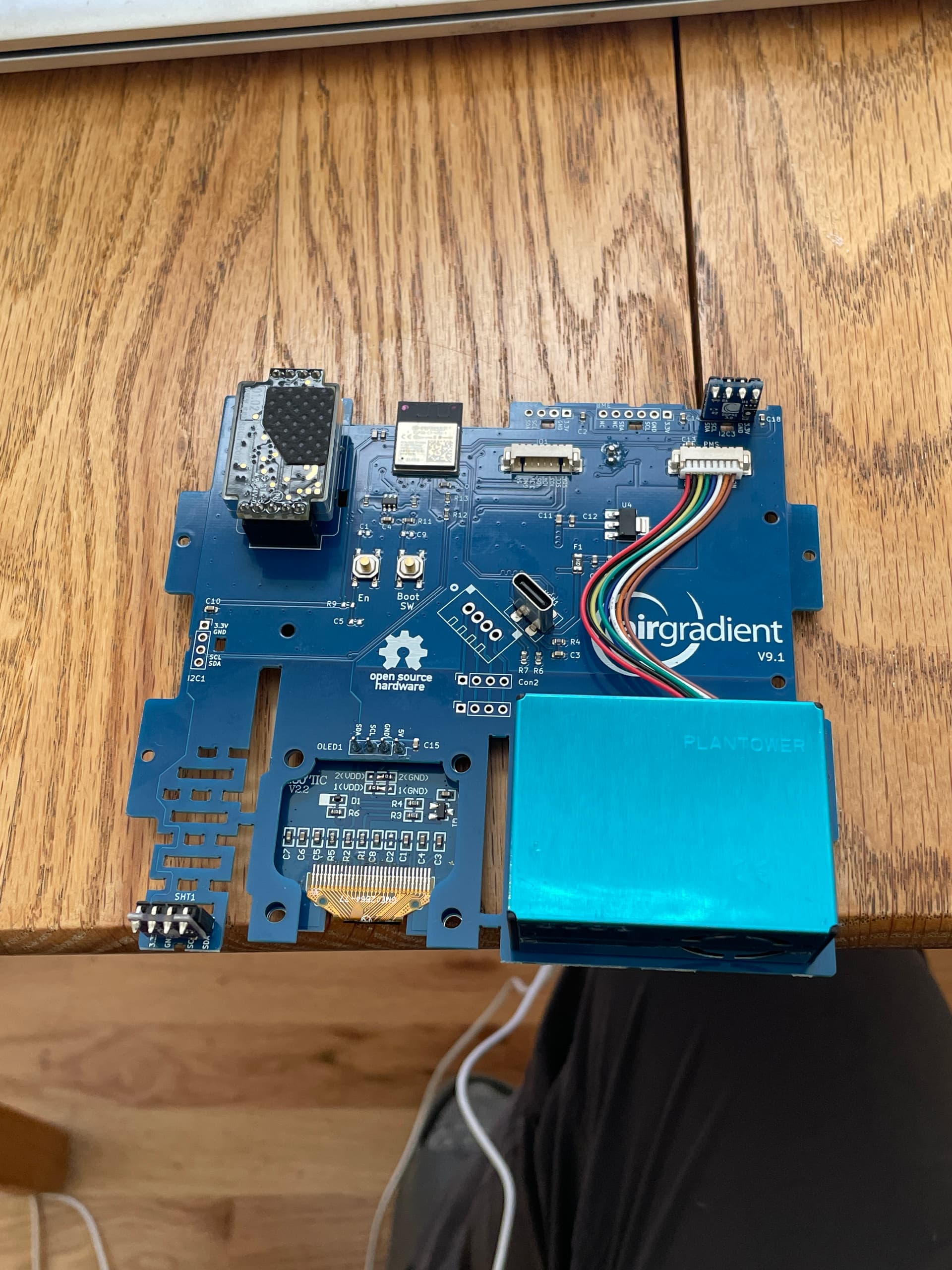

Can you include a photo of your board?
The screen has never lit up.
Here is a photo of the board. I’m only allowed to upload one image per post.
Close ups available if needed.
The CO2 module flashes every 2-3 seconds.

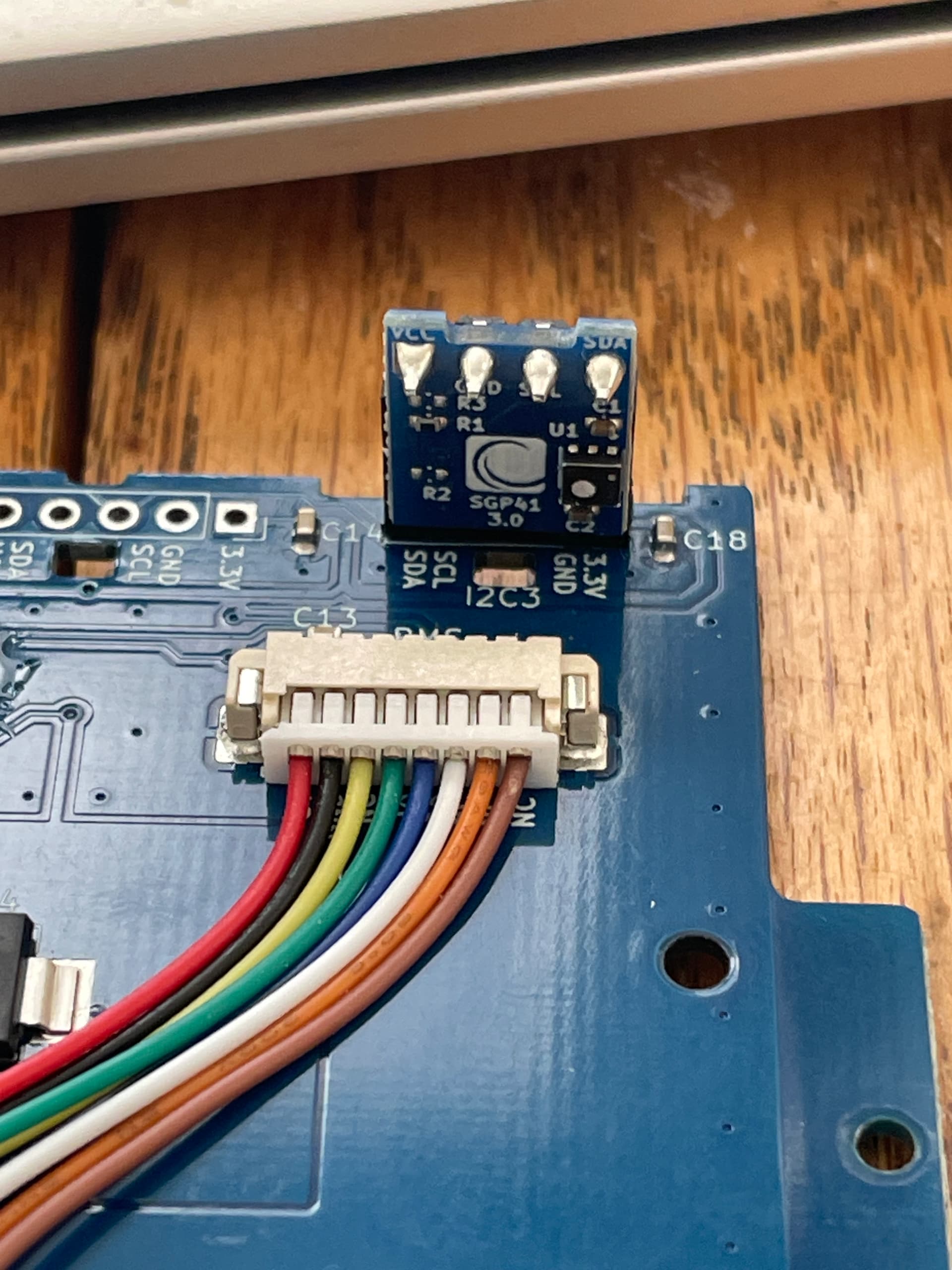

Your chip in the upper right is not installed properly. It should be facing outside of the board.
You can see how in the upper right one of the pins says SDA but it doesn’t align with the label of SDA on the board.
Flip it around and double check against the instructions and then you should get the display back.
You are correct! I faced the upper right module to the outside and the LED monitor now works… That’s the good news, thank you. The bad news is I was getting indoor PM2.5 readings in the 90s this afternoon, down to 40s now. Still way bad. CO2 in upper hundreds and below 1000, okay i think. VOC is decent as well.
