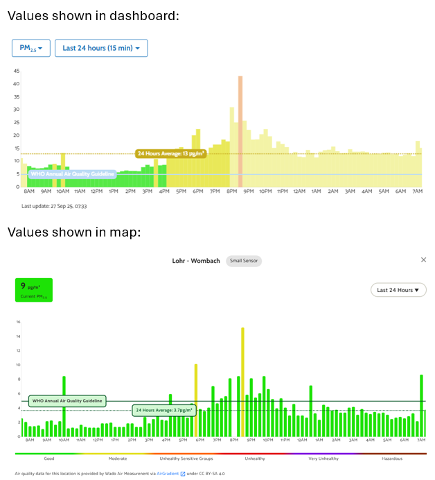

I am also observing a difference between the values shown in the map and in the dashboard. The values seem to be not even in the same ballpark and I am wondering what I can do about it. Thx for any tips on how to improve the situation.
Are you using a batch calibration for your particulate sensor? AG has said up front that the map (inexplicably) does not use this (yet?) and thus displays invalid data.
