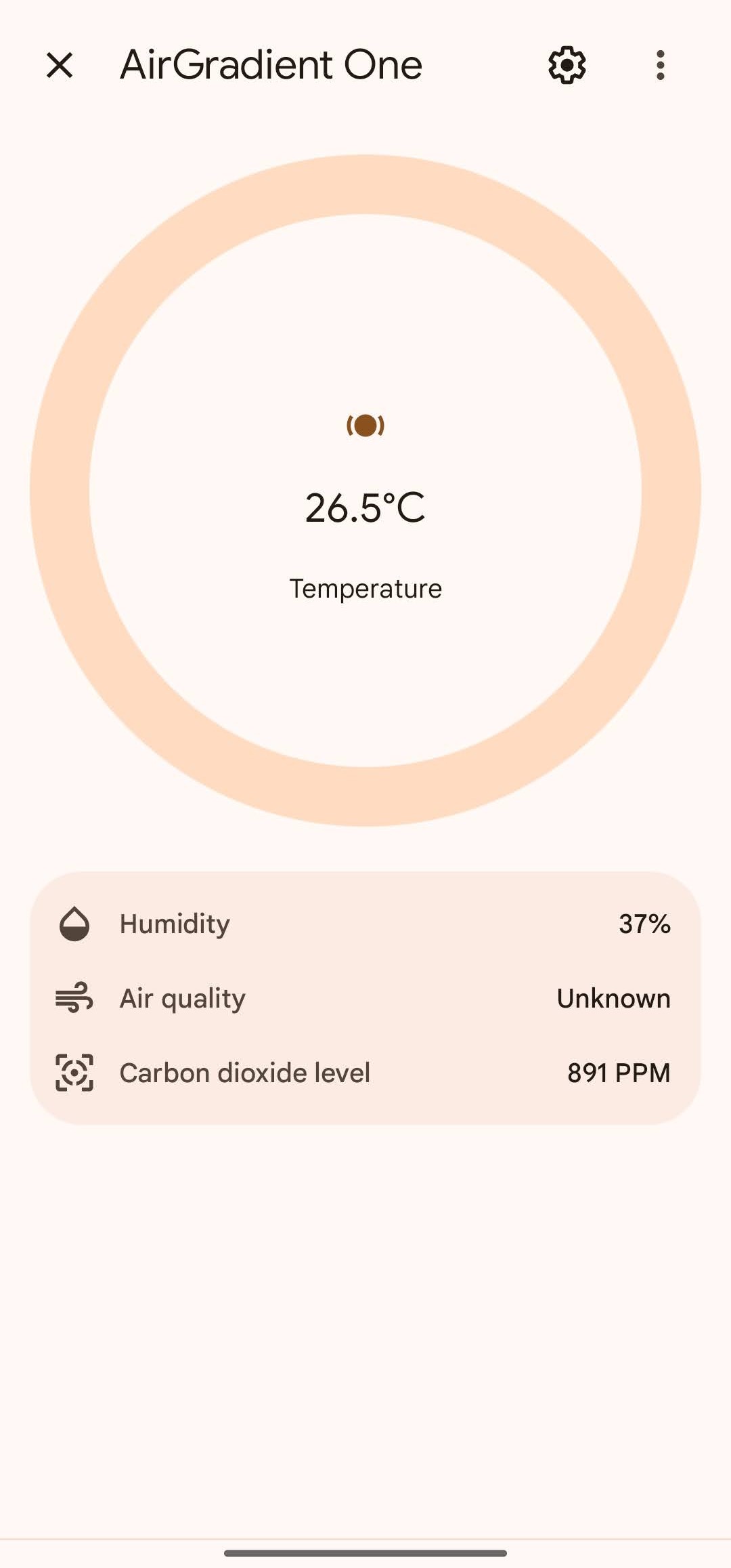

Let me just spoil the result. Currently, with this method, it’s not that satisfying for me, because I can’t get the PM, VOC, and NOx sensors exposed to Matter, but at least, CO2, temperature, and humidity work well (only these 3 measurements work). So I can ask my Google Nest Hub to read me the CO2 level in ppm from my AirGradient monitors, as well as these values show on my Google Home app.
Here’s a video asking Google to tell me the CO2 level:
AirGradient in Google Home app (via Matter using Matterbridge). Only CO2, temperature, and humidity are here, with a toggle switch to turn on/off posting data to the AirGradient server (just like how it appeared on the Apple Home app, so I don’t have a screenshot of Apple Home here.

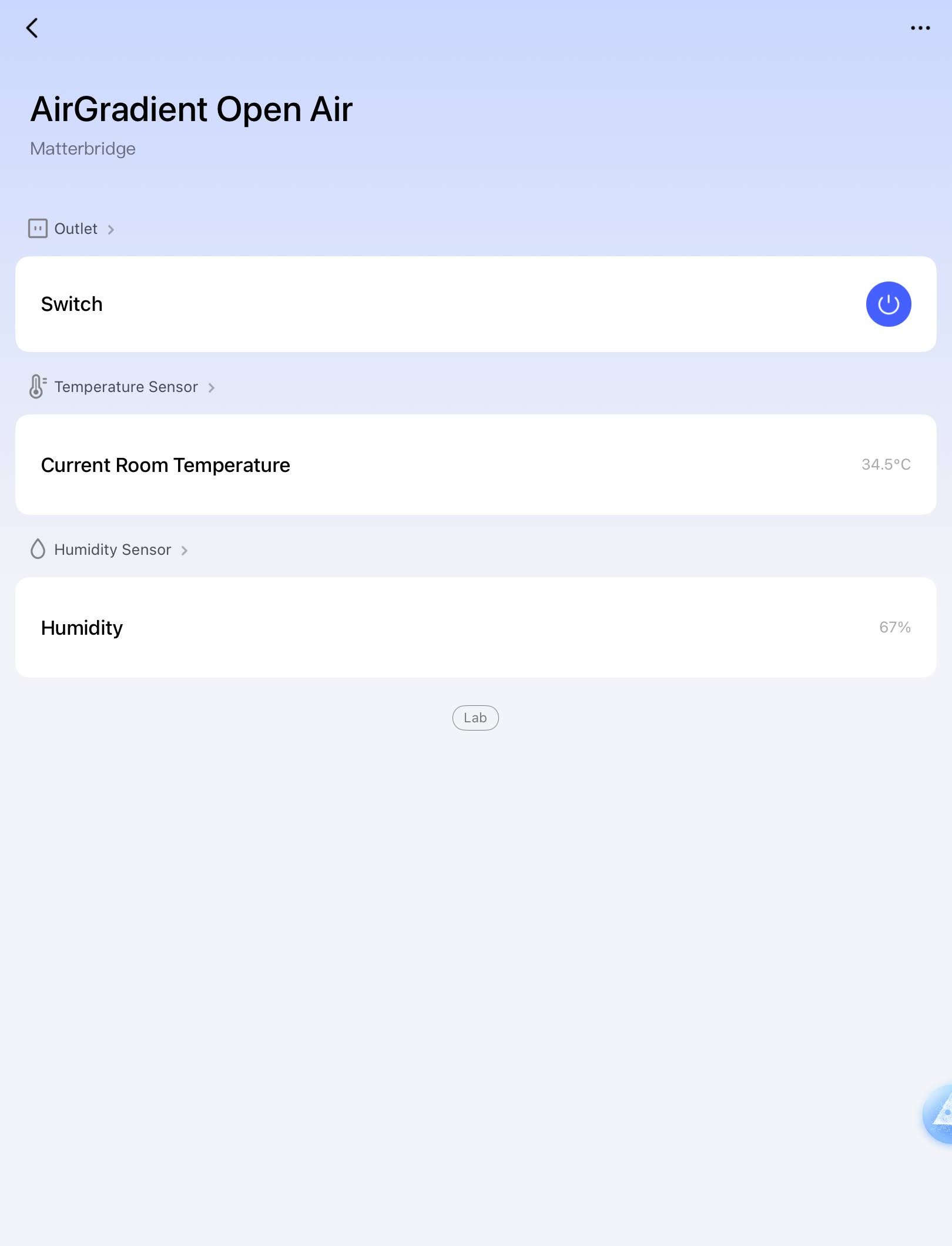

AirGradient in Aqara Home app (via Matter using Matterbridge), only temperature, humidity, and a switch to turn on or off posting data to AirGradient are here.

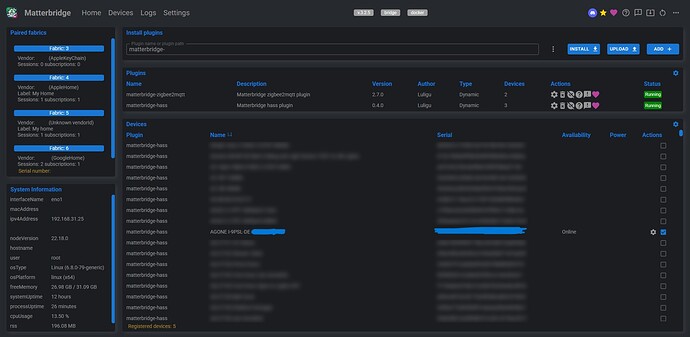

How did I do that? It’s not very complex, but a bit frustrating for me, and obviously, you don’t need to have an engineering degree for it (I don’t have one either). I didn’t develop anything myself, just used whatever was already available out there. I connected my AirGradient to my Home Assistant via the native AirGradient integration, then I used Matterbridge to get the devices from my Home Assistant, and then it relayed them to the Matter network, which I successfully tried pairing to my Google Home, Apple Home, and Aqara Home.
Home Assistant > Matterbridge > Google Home/Apple Home/Aqara Home
That’s it.
Here’s what Matterbridge UI looks like:

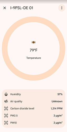

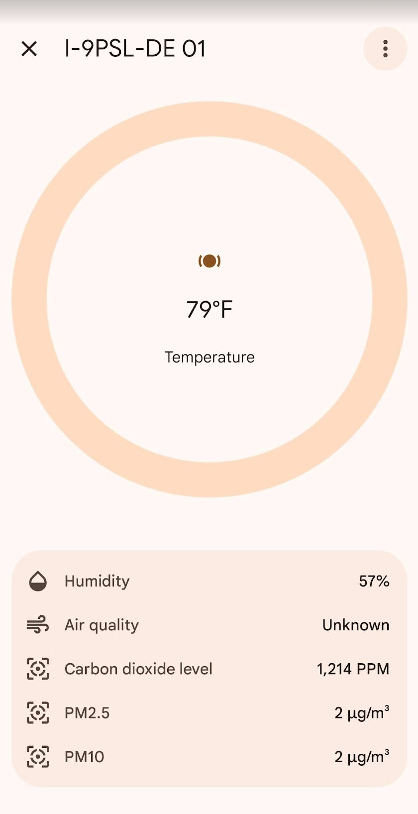

Interestingly, with the latest version of Google Home and Matterbridge, I can see PM2.5 and PM10 now. Although PM2.5 shown here seems to be retrieved from PM2.5 Raw, not the compensated PM2.5 (calibration algorithm applied).
