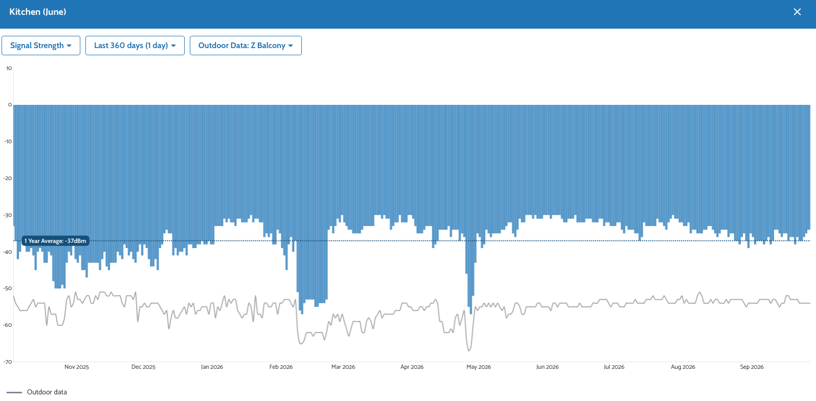

Wi-Fi can be really difficult - and I work in tech. Some cheap routers really do cause problems. I use Ruckus because it is absolutely reliable. Here’s a year of stats from two of my Airgradients.
