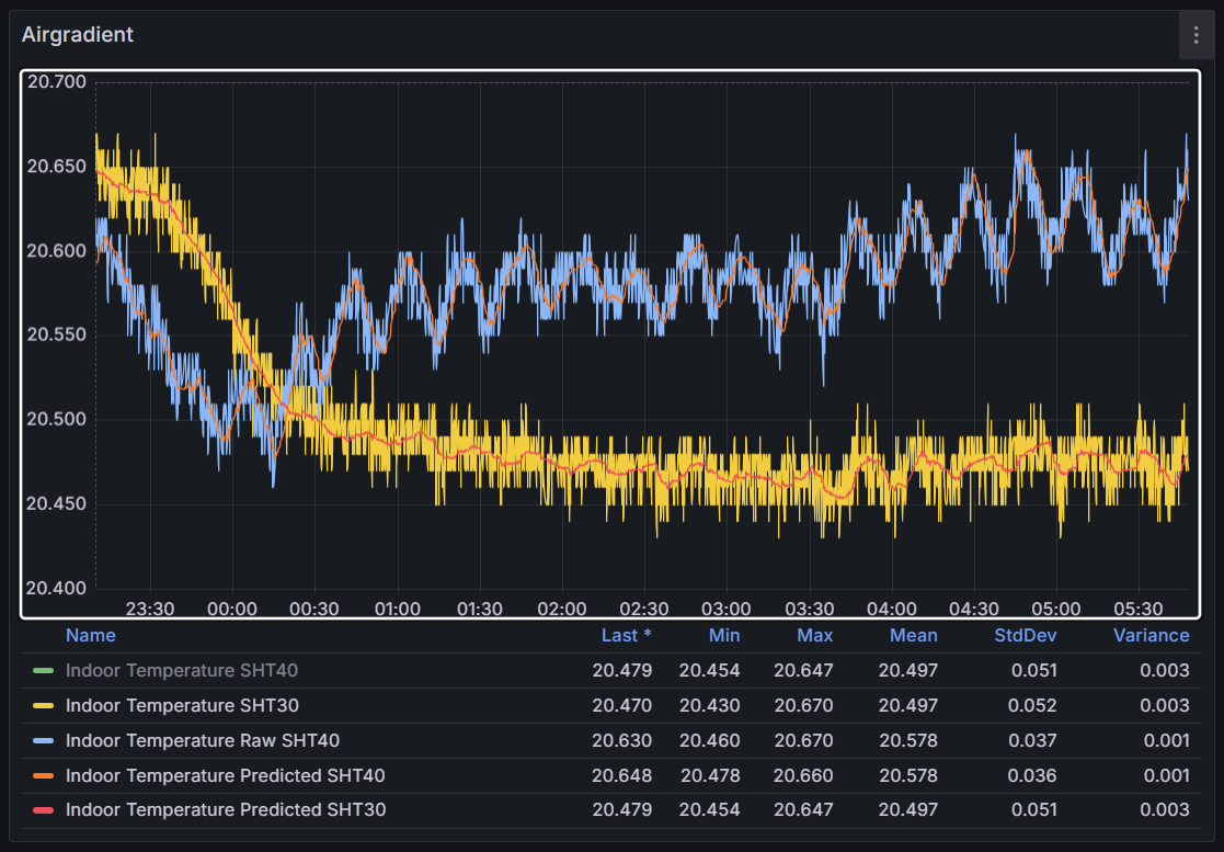

I have two temperature sensors next to each other, which I use to track indoor temperature. My system is capable of mataining a very precise temperature, especially during the night when there’s little human presence, down to 0.02 Celsius, essentially working at the limits of the temperature sensor. I then add additional filtering to account for the noise (the predicted value on the graph).
However, the SHT40 sensor in the airgradient, because of the fan, is adding additional noise which means that its performance is actually worse for my controller, compared to the SH30 next to it.
It would be great if it was possible to disable the fan via a switch (home assistant)?
Thanks for the great product, and I would appreciate any instructions on managing the internal fan.
